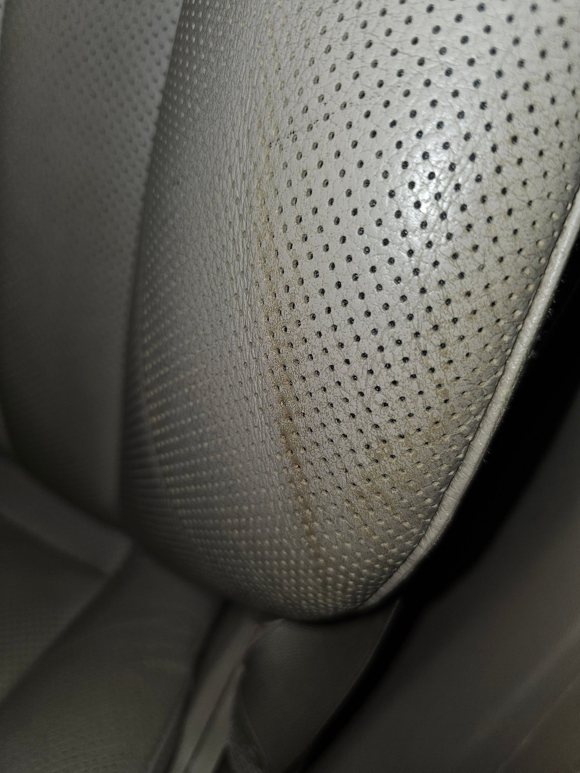

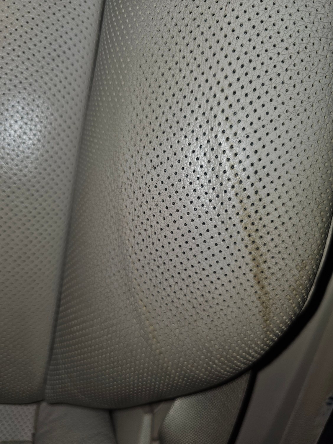

Local shop threw a tantrum in my interior. Scuffs all over, pen marks on my seats, damaged the driver side stripping on the inside of the chassis... Broke my discontinued magnet mount too
I cleaned what I could but a couple spots need repair, the seats & the stripping.
You can still kinda see the pen marks. I don't like to throw out accusations but this car only has ~65k miles on it, I barely drive it. This doesn't look like normal wear on the seats.
I can't remember when or how I could ever swipe a pen across my seat or scrape that rubber seal up so bad. Its in too out of the way a spot for me to have done it.

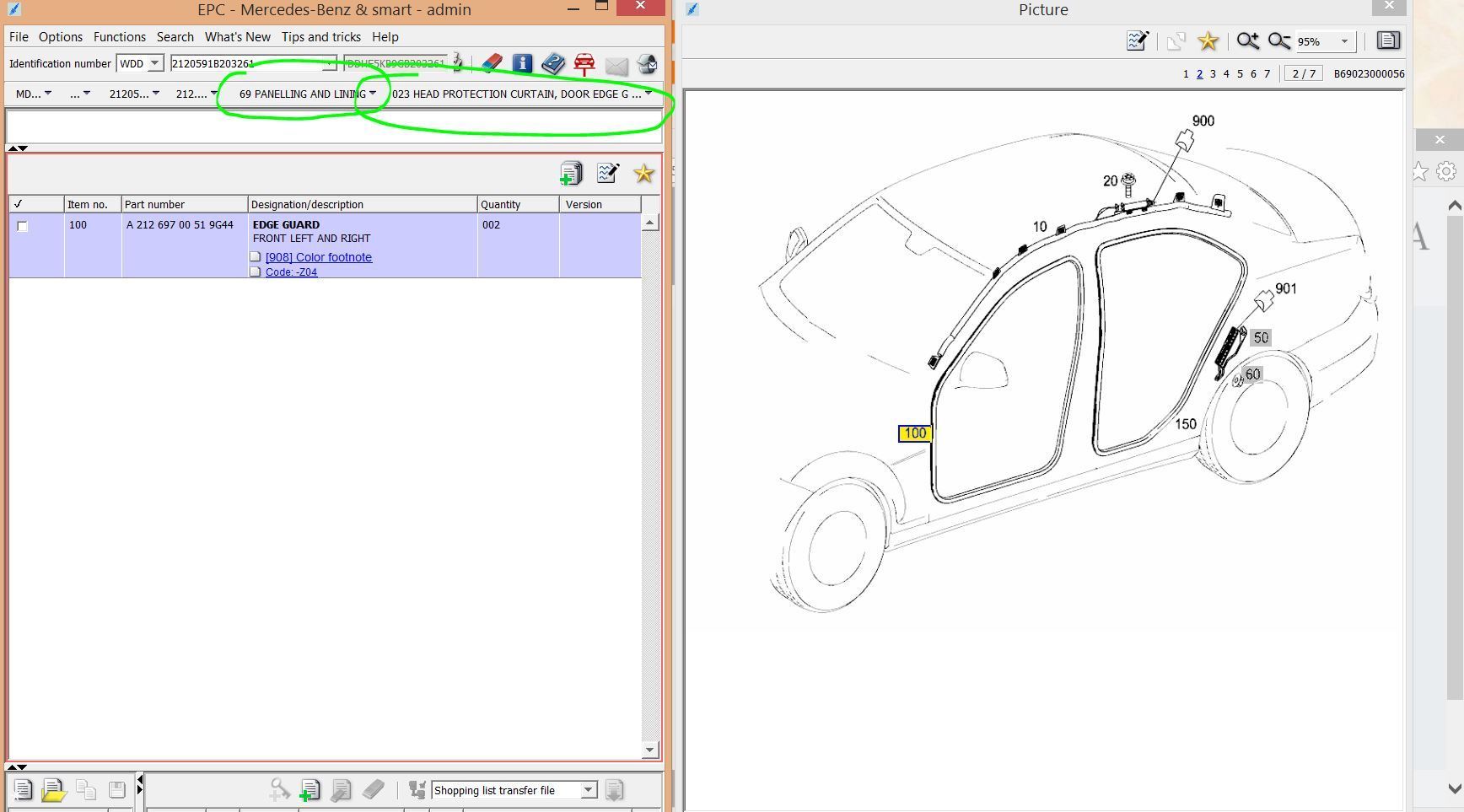

I found a product for repairing the seat, its siam biege paint but I can't figure out what the part number is for the stripping, I think its A21269700517L53 but I can't really tell from the pics online. How would I go about replacing it, do I just pull old one out and jam the new one in?

Go to here : https://www.amayama.com/en/genuine-c...s-benz/e-class
Fill up your VIN number, so that the color code will show and what is NOT for your car wont be shown.
Your light cream color door seal has its own color code.
To understand the footnote, go to this VIN decoder so that you can see what option code or year your car is identified as : https://www.lastvin.com/
Look for this section : 69-xxx
Above is just an example from E350 of 2015 built, chassis W212.059 meaning M276.9 engine and facelift.
Have fun shopping.
