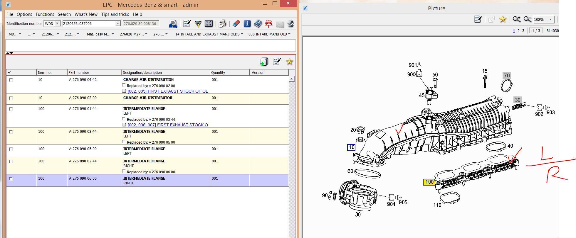

Parts like plastic intake manifold is not something we can make DIY and mine being a boosted engine has more risk than NA engine for intake manifold cracking.
OM651 diesel loves to crack its intake manifold, probably also because of soot from EGR.
My intake manifold. Item 10 , I already ordered, 30 days wait.
Item 100 Left and Right probably I will order next year , it is too thick and simple to break, but plastic is plastic.

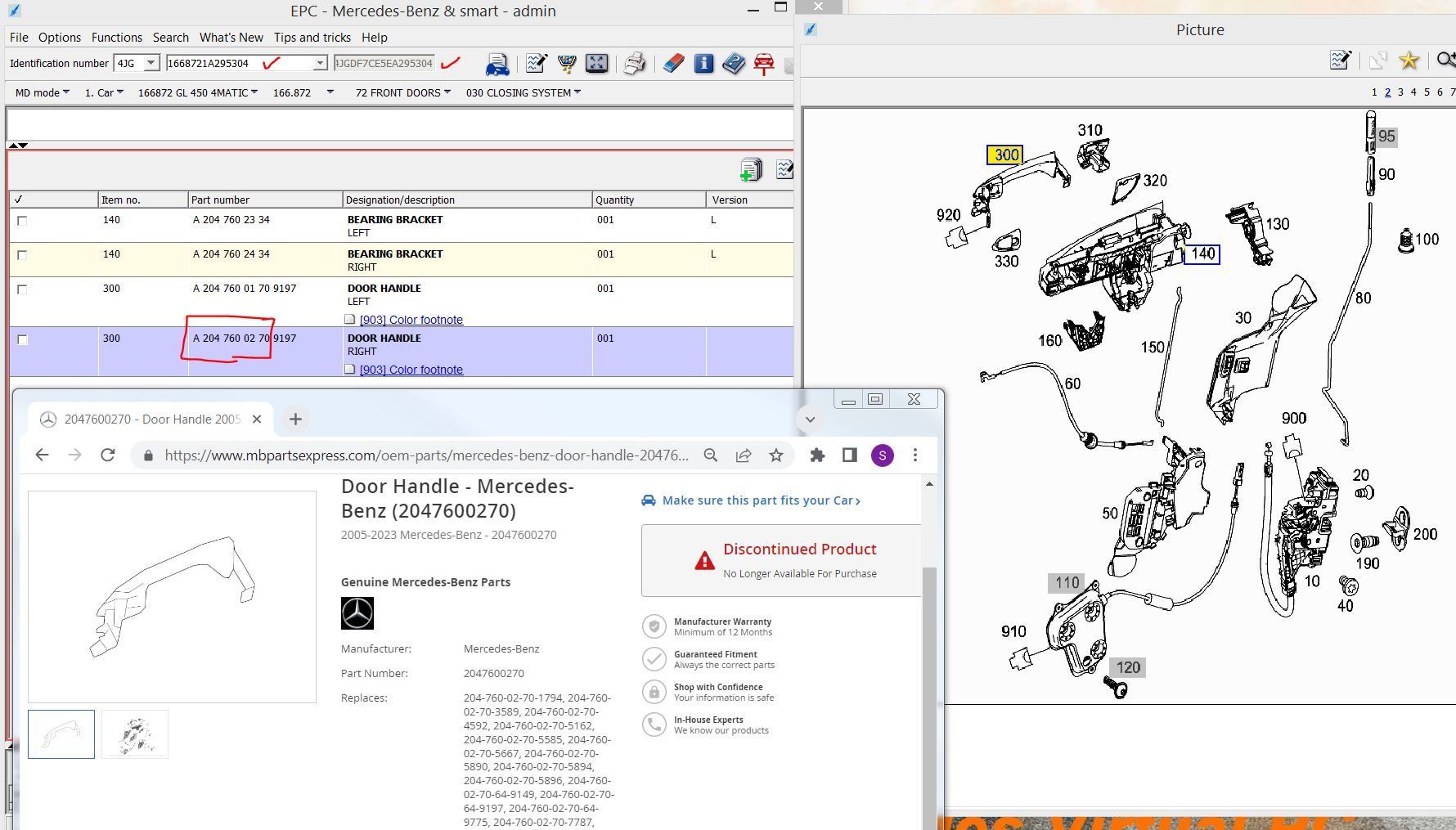

I was watching this video for fun and at minute 3:30 this techy statement terrified me. 2014 GL door handle DISCONTINUED ???????
I then check.

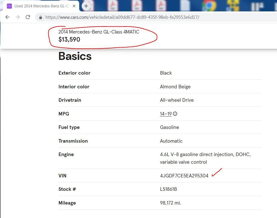

I use a legit VIN number of GL450.
Last 4 digits 9197 is color for black.

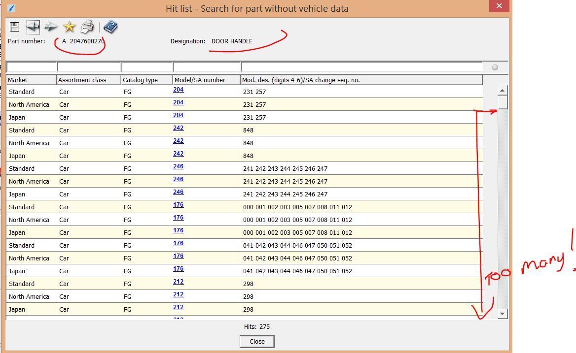

Left door handle A204 760 01 70 : https://www.mbpartsexpress.com/searc...tr=a2047600170
This left or right door handle for US cars DRIVER side is used on many many cars and is electronic door handle not dummy door handle.
How can this be ????
These cars below use it :
W246
W242
W218
W212
W207
W204
W197
W176
W172
W166
W156
W117

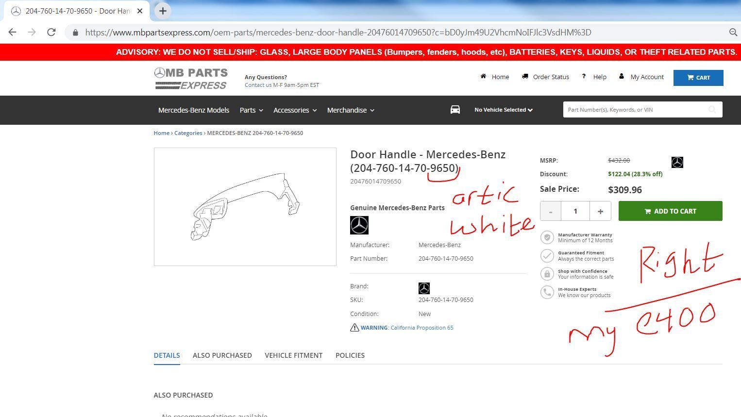

A small glimpse for E class sedan.

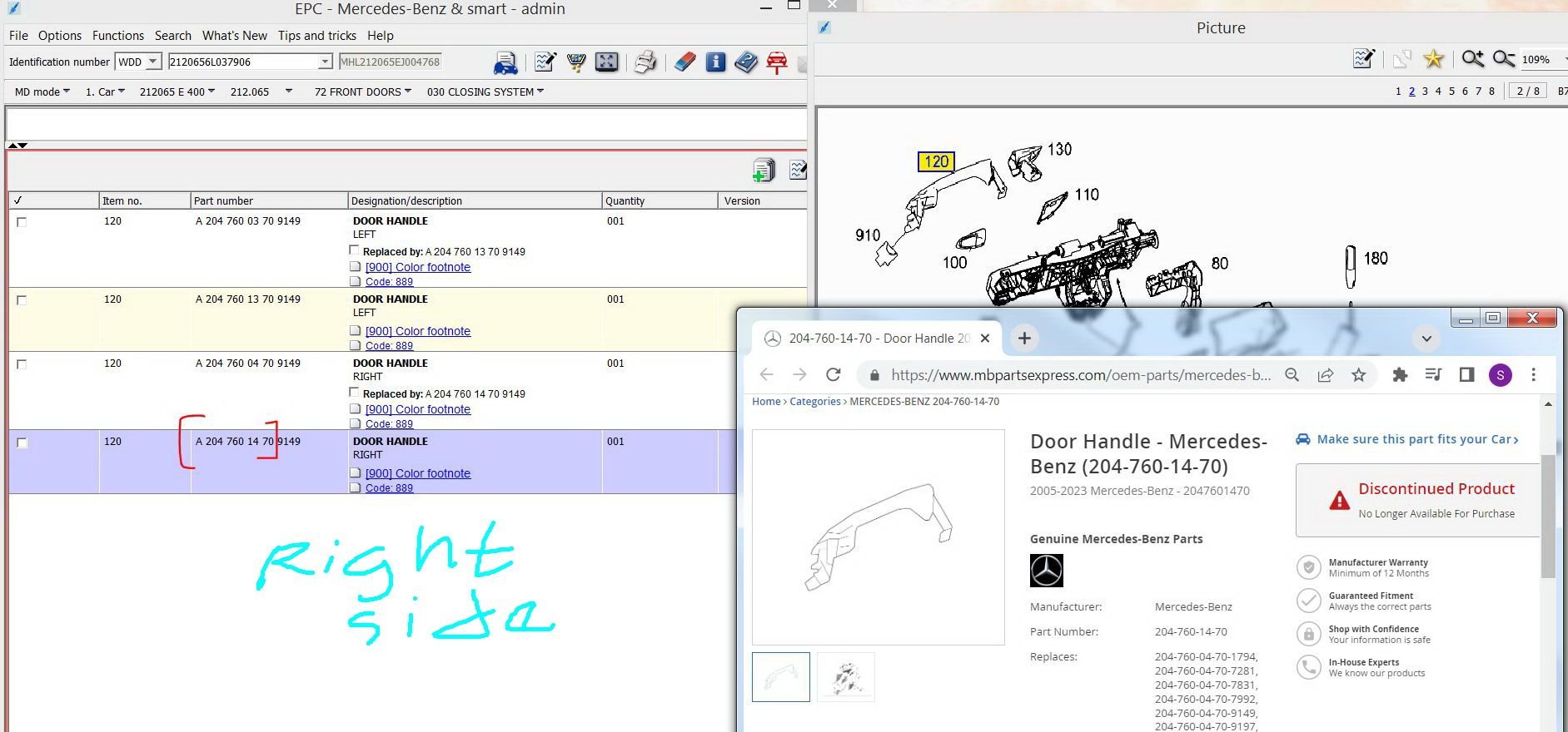

Let me see my car
Right door handle
This is available, raw unpainted ?????
Unsold stock probably. Mine is Polar White color code 9149 or 149U
This should not be happening.............
