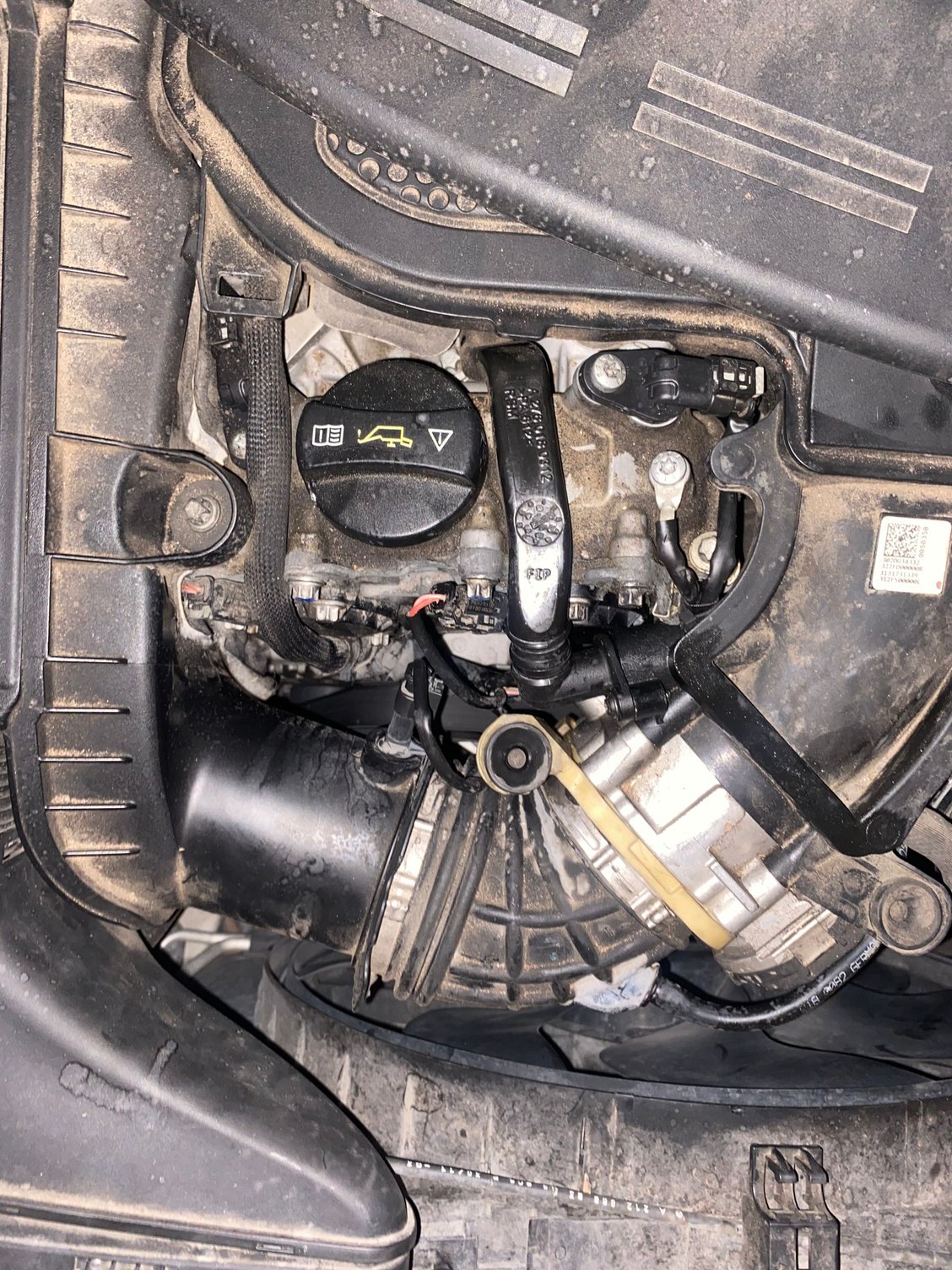

I replaced my magnet/tone wheel on my Benz and that involved unclipping two sensors and moving them out of the way. When I plugged everything back in, I have check engine code P2540. I checked everything twice and can’t seem to find the problem. Everything is plugged back in snug. I’ll include a picture of the area I was working on. Could somebody point out which of these sensors is the low pressure fuel system sensor? I can’t find any videos online. The engine is the m276 3.5L.

Low pressure fuel sensor is on the low pressure fuel filter. LEFT side of the rear seat service-hole.
Right side picture, the one with blue fuel hose. Left side picture is the fuel pump, at right side service-hole.
B4/7 is the low pressure fuel sensor

The battery was disconnected, and I’ve cleared the code but it keeps coming back. I don’t think I even unplugged the low pressure fuel system sensor as it is in another area if I’m not mistaken.
