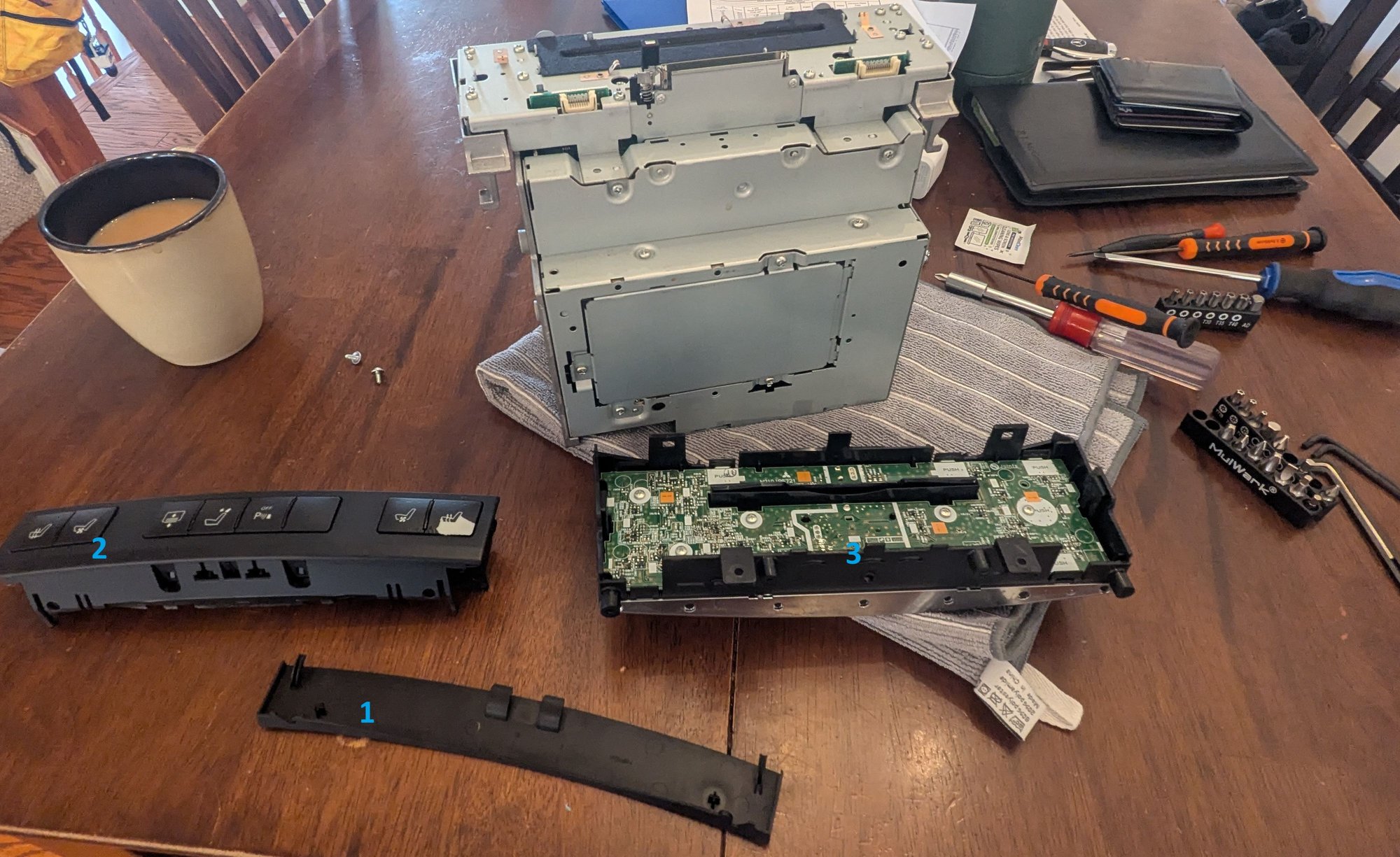

Steps
After you remove your COMAND unit:

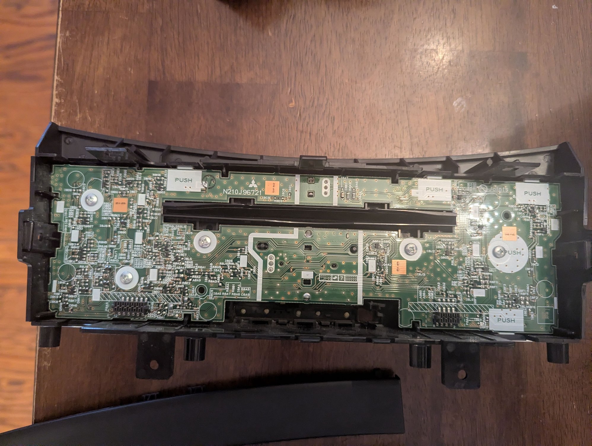

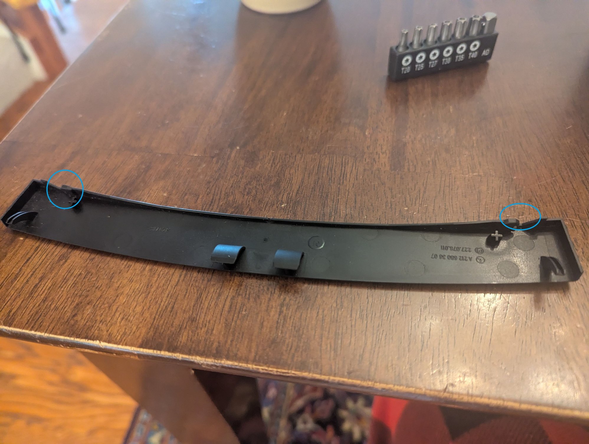

1- Remove bottom trim piece by gently pressing tabs outward then slide the piece out of its grooves down and to the back of the unit (when facing from front).

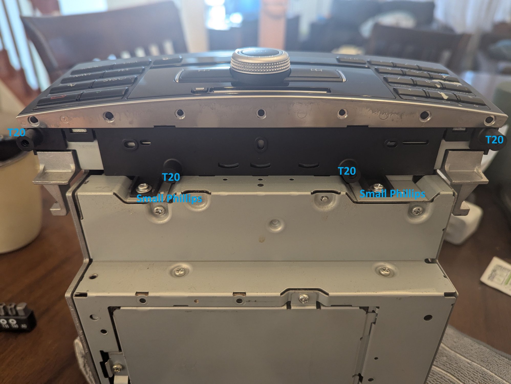

2- Remove 4x T20 screws (Black) from the "Accessory" button unit with heated seats, rear screen etc.

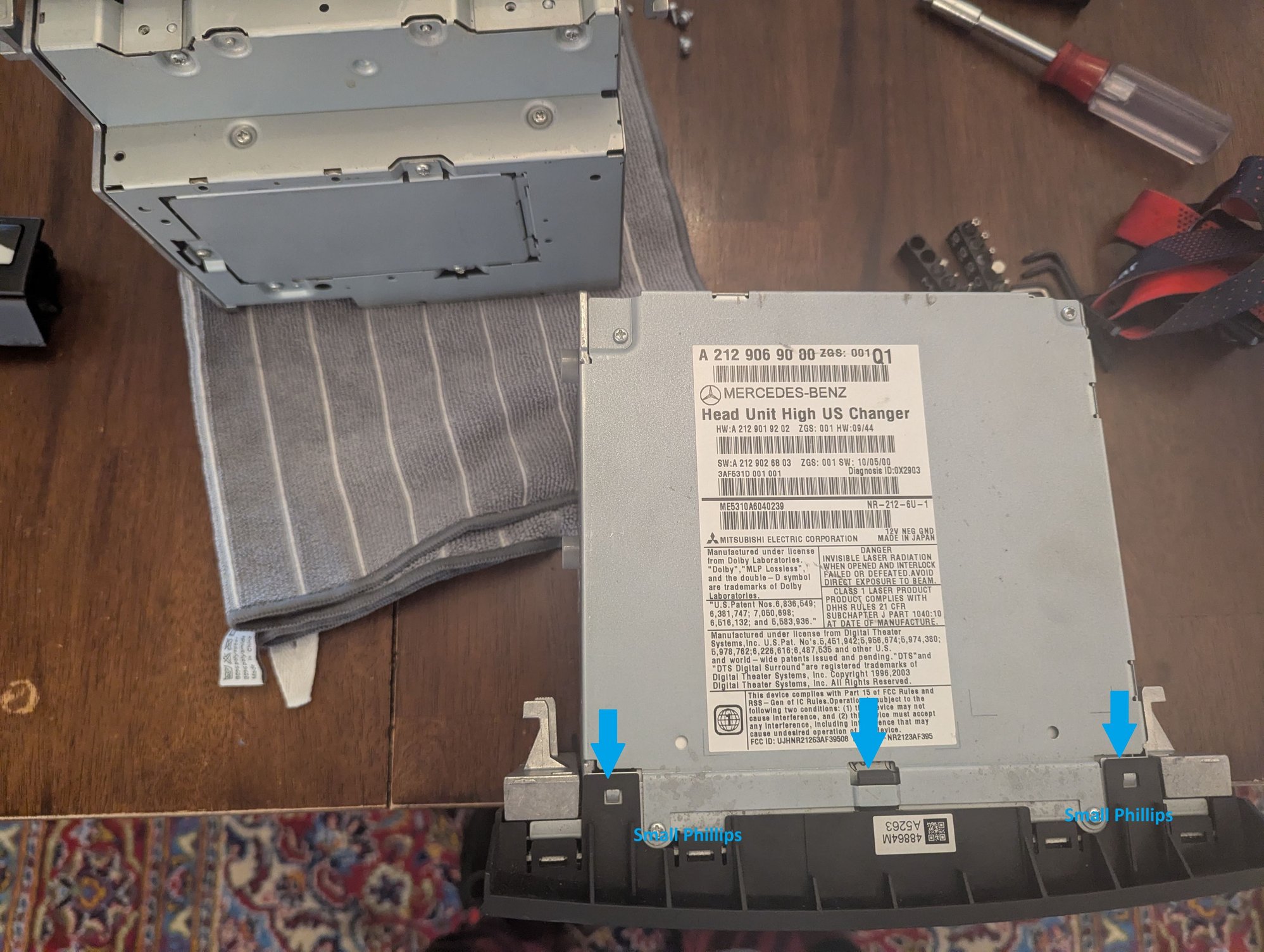

3- Remove 4x small Phillips head screws from the main upper COMAND button unit
4- Gently pry all plastic tabs (3+ top, 2xon side, 2xon bottom) to release COMAND unit buttons to the front.
5- Swap good buttons over to your original unit and reinstall
