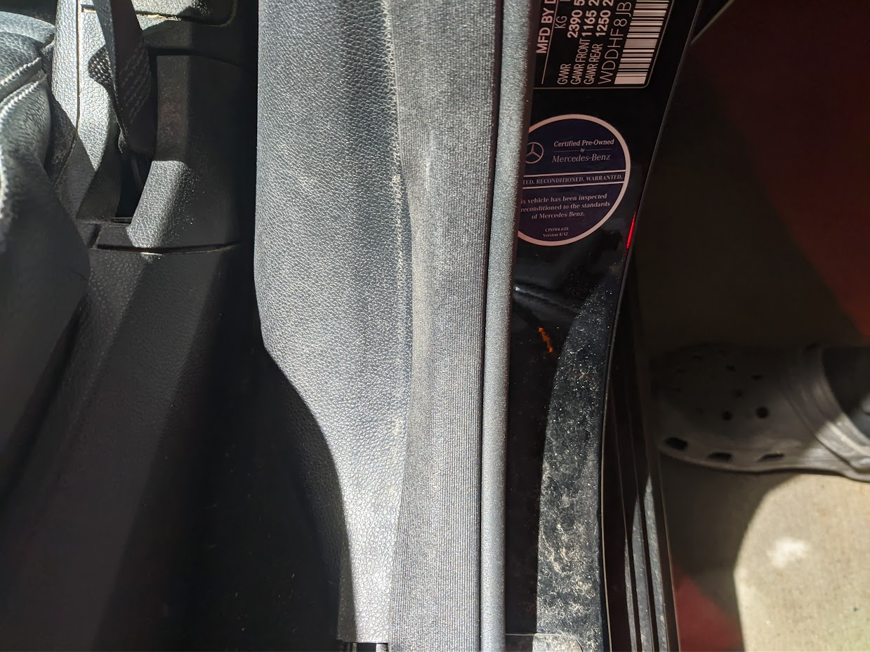

The part number on my left/drivers side is exactly the same, but I'm worried I'm somehow missing something, and that the seal won't mold to the corners correctly. Can someone just confirm whether the right and left side are swappable? Thanks.

Yes. Comes in a loose roll.

for the used parts, obviously is doesn't come in a roll, but I had no problem remolding it to the other side of the car. One thing to keep in mind is that where the strip goes over the dash, it will get bent in a little. And when you swap sides, that bend in part gets relocated. Not a big deal for me, I will forget about it in a month.
