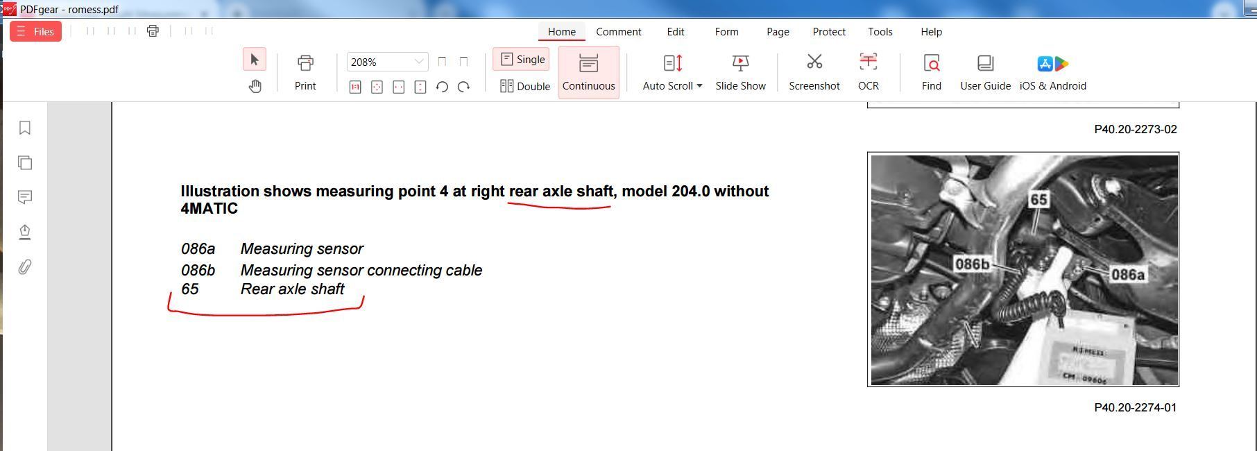

For clarity is the Romess angle left to right or front to back?
My vin is WDDHF8HBXAA115230.
Also do you think the camber adjusting bolts would be sufficient to pull it back into alignment?
Sounds like I need to interogate my indy to see if they have the capability to do the alignment properly.

Originally Posted by MBNUT1
Wow. How cool. Thank you for sharing all of this.
So you suspension is indeed 485 CONFORT RUNNING GEAR.
https://www.lastvin.com/vin/nNMKJ2PmeLXAvQgBl
Romess angle is the angle of one of the suspension arm ( usually camber arm ), or CV drive shaft in Left Right reading.
Or inner to outer reading. Something like below using low cost inclinometer.
See the two red dots on my front camber arm, that is supposed to be where a Romess tool is to be placed.
You ask :
I can't say with certainty that it will be able to pull the value back to mid center proper spec, you need to try.
But make sure your arms are healthy too, the bushings .
Add/edit 6th April 2026 01:42 pm: Since I only done correction bolts ( for the front ) on my car ONLY, albeit I experiement a lot....BUT not other 9* cars with various values ( * not enough sampling/experience ) I can't be certain on how much the effectiveness of correction bolt will be on your car.
Common figure on the internet is +/- 0.3 degree worth of correction for the correcion bolt, the same as what Bruce mentioned.
If indeed you can achieve -0.3 degree correction for your Right Front Camber, perhaps the final result maybe borderline with the spec required.
Remember, anything corrected on the left side, it effects also the right side and vice versa.
Camber and caster are related, due to the suspension geometry.
Good luck
