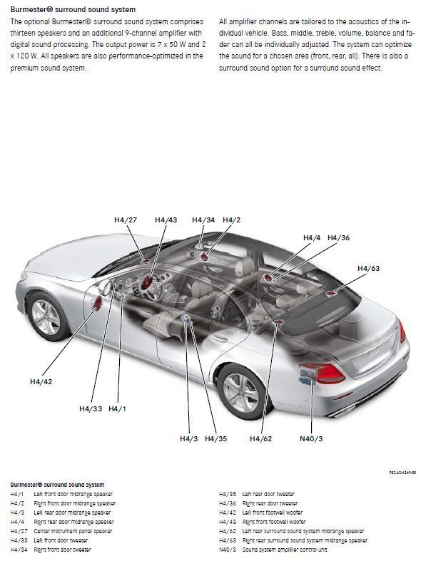

hi, i own an E400 2018 with a burmester sound with 13 speakers and i want to add a subwoofer, where is located the AMP? to tap the high output and convert it to low?

Im still trying to find where all of the 13 speakers are.

l have an 18 Coupe. Do you have a diagram for that?
