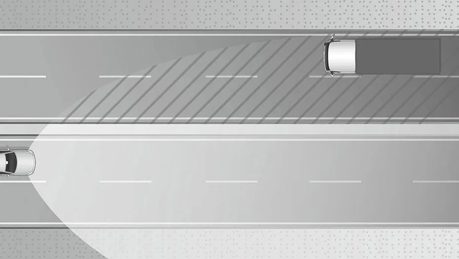

This is something I noticed this morning for the 2018 E class at Mercedes Benz Canada.
This made me go.... ????!
https://www.mercedes-benz.ca/content...-SEDAN-085.jpg
Take a look of the supposed lighting for the oncoming car. Does it actually do that? I get that the Matrix LED (stealing a term from Audi) style selective turn off thing doesn't work in N. America, but this seems to indicate the ability to have partial high beam illumination?
Yes, that's how it works in countries where highway safety is of higher importance than it is in the US. That this type of technology isn't even new now and yet we can't use it in the US is unacceptable.
I think we may be talking about two different things.
The way MB Canada has always set these lights is the same way that I think MBUSA does it, which is "high beam" or "low beam". There's a sensor near the roof as you know that detects ambient light and it'll switch on high/low beam automatically, but it doesn't have the ability to set partial high beam, at least that's my understanding of it.
What surprised me this morning was that the photo from MB Canada that I linked indicates it can do a partial high beam. I didn't think that functionality existed, even though it was just sort of approved a few months ago.

teksurv's Avatar
Joined: Apr 2007
Posts: 1,489
Likes: 439
From: San Diego, CA
2024 EQE 500
I agree on the MB Canada photo. North American ILS systems have, at least til now been automatic gradient changes between low and high beams. We have the individual LEDs, but not the logic to enable/disable them at the individual level as they do in Europe.

rbrylaw's Avatar
Joined: Aug 2004
Posts: 3,447
Likes: 333
From: Tampa, FL
2019 E450 4Matic & 2018 E400 4Matic
I think we're talking about the same thing. I honestly don't know what Canada permits or doesn't. But in the US, the ability to able or disable individual led lights in the US cars other than High or Low beam is not activated. In Europe, the lighting system is way more articulated (for lack of a better word).
