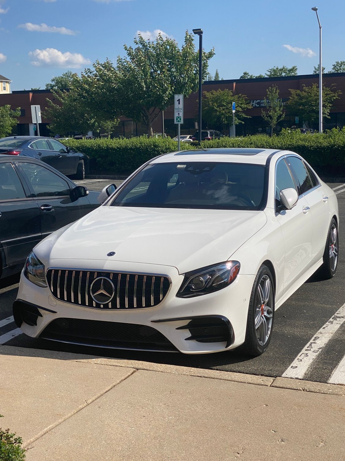

I have the AMG (Panamericana) grill on mine… see below. Parts and labor ran about $600.

Very nice! What year is your car? Is that an E300 Sport? I have a 2018 E300 Sport -- and I was actually looking to go in the opposite direction -- below is a picture of mine -- and I was looking to go with the "black" grill and less chrome. Is there an AMG or black, little to no chrome grill for the 2018 Sport model? Thanks in advance.
