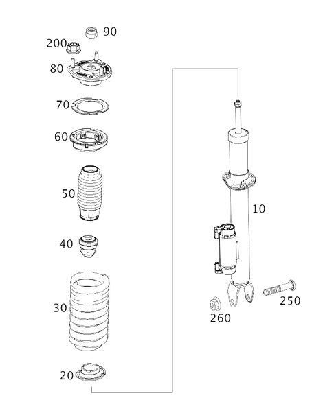

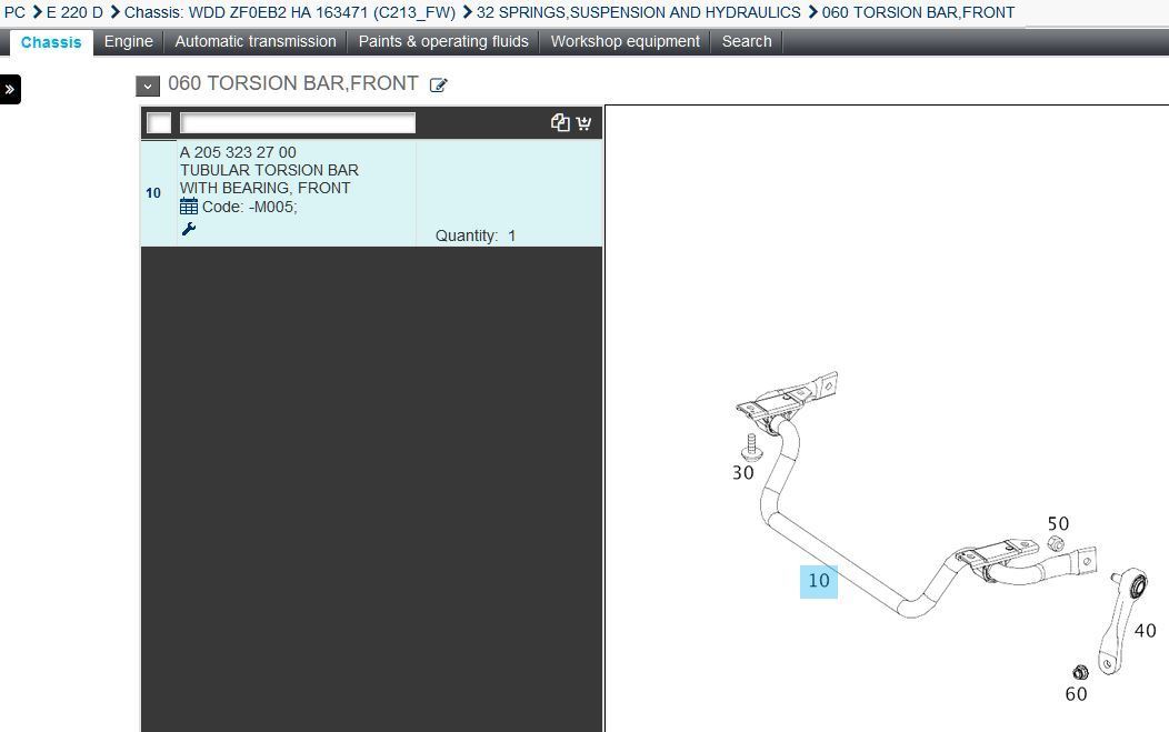

Check strut & associated parts + torsion bar note MB does not offer torsion bar bearing separately.
Thank you, seems more in-depth than I first thought.
I wouldn’t of expected to have something worn that much in only 61,000 miles and 3 years old.
