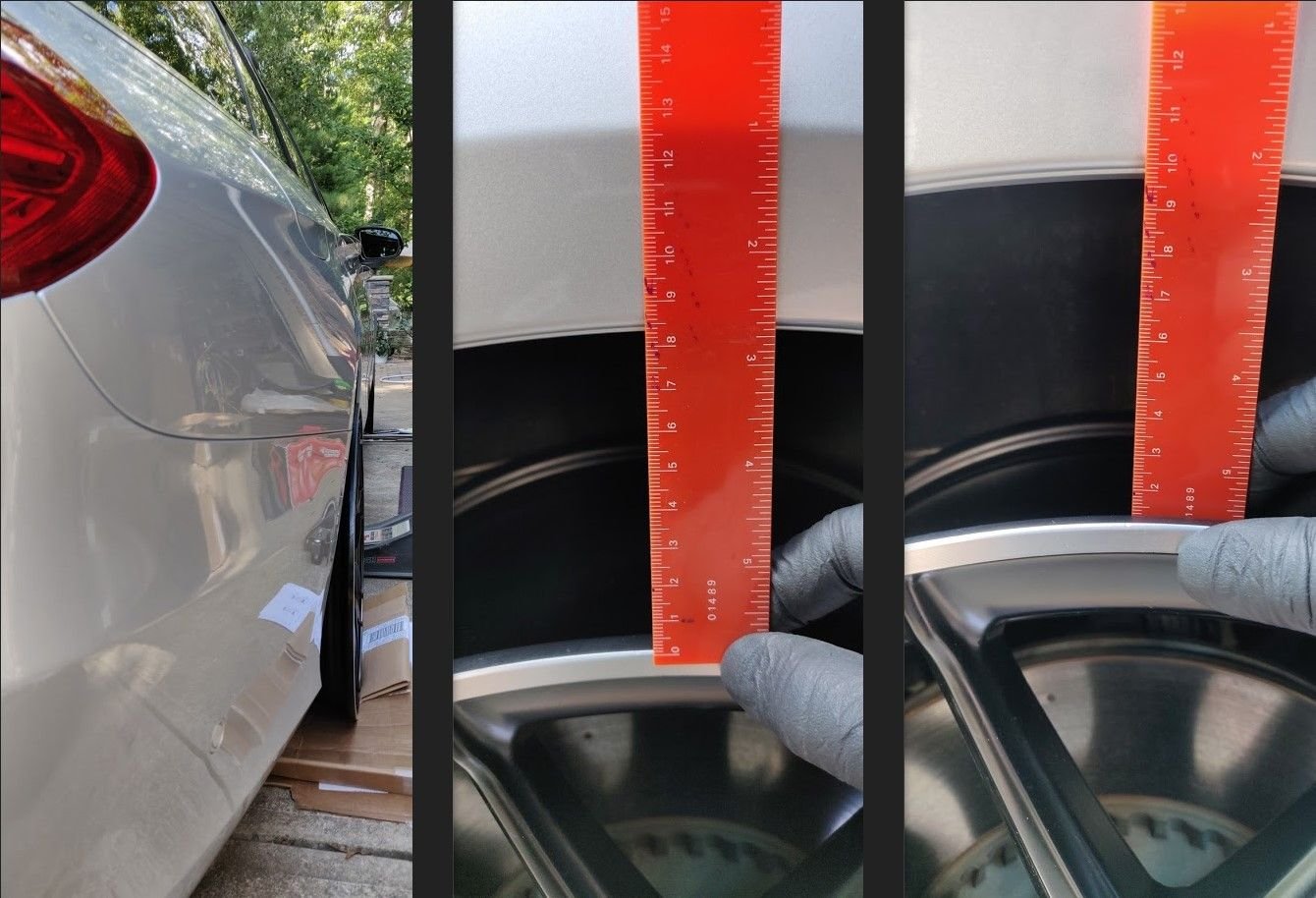

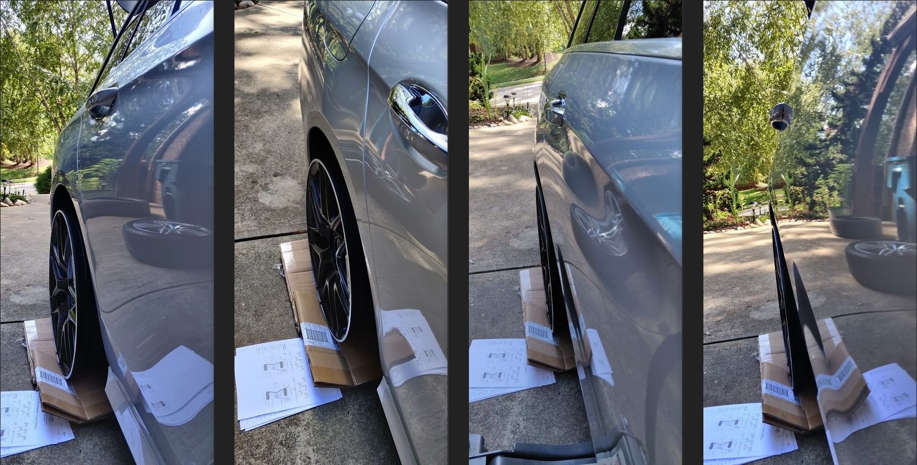

I also put the wheels on the car and tried to measure around to see how much room there is. This is actually difficult with this car since it tries to level the car and the suspension is so stiff it makes it impossible to rock the car and see what the angle of the wheel is when going under the wheel well.
Anyone have experience which would make me feel more confident in going forward with this wheel change? Thank you in advance for your help.

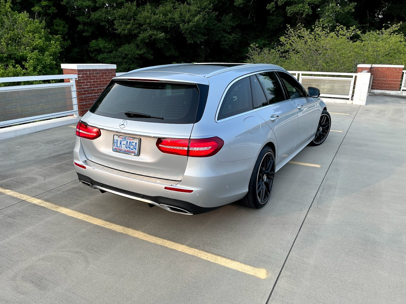

I took some pictures of these 20" rims mounted on the car (without tires).
Thank you again for your help!
ORIGINAL SETUP
20" WHEELS UPGRADE

Thank you. I think I am going to go with 255/35R20 all around.
I found this site, which has an extensive chart of wheel-tire fittings on existing Mercedes, AMG, and Brabus configurations. There is a Brabus setup with the same wheel sizes and offsets, which is using this 255/35R20 tires. Although this does not say if they did anything with the suspension...
For the first time doing this I do not want to take the risk staggering the tires and making the rear not fit in the wheel well.
https://www.alloywheelsdirect.net/in.../mercedes-benz
So hopefully this will fit without any rubbing.
Approved by Brabus:
front:
size 20x8.5 | offset 40 | tyre 255/35R20
rear:
size 20x9.5 | offset 35 | tyre 255/35R20

I realize this an an old thread but did those rims and tires fit without any rubbing and was the offset correct?
Old Nov 17, 2025 | 04:19 AM
Janster's Avatar
Joined: Sep 2020
Posts: 46
Likes: 29
From: Charlotte, NC
E450 4Matic Wagon '19, MDX '09, 9-5 Aero '03, 280ZX '79, BelAir '57, VF700S Sabre '84
Fits great, no rubbing.

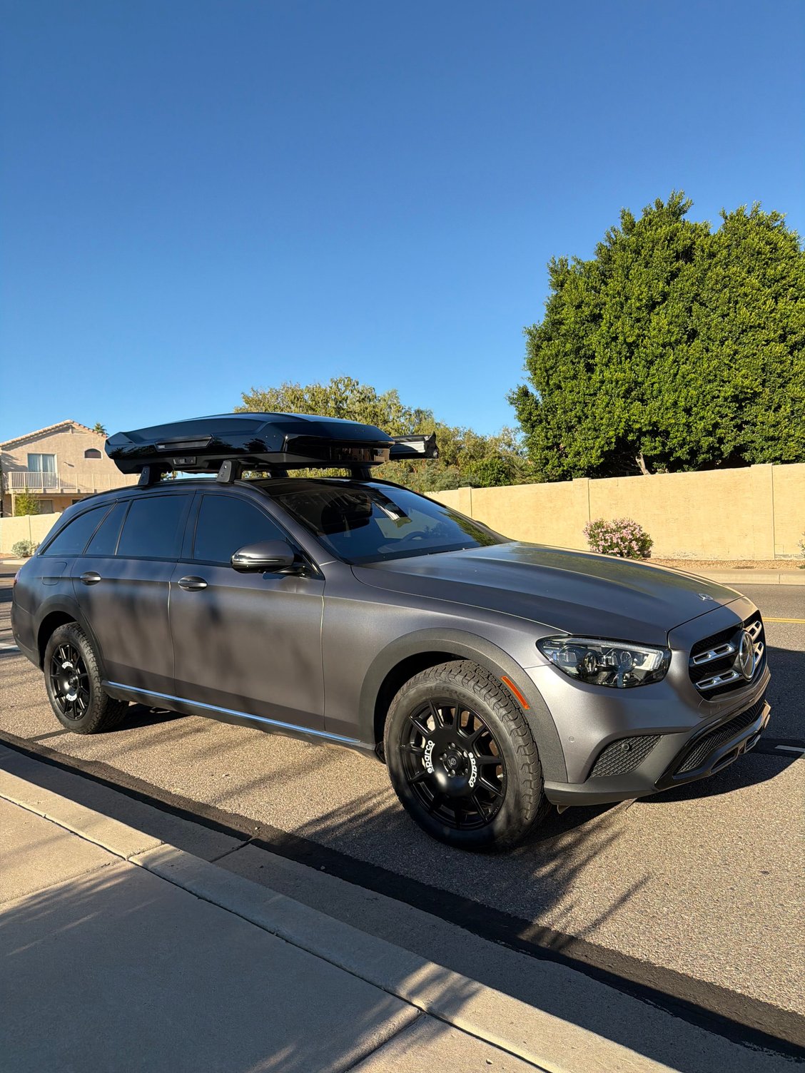

'21 E450 All-Terrain (Hightech Silver)
Just want to add to this thread for anyone out there:
I run Sparco Terra's in Matte Black, 18x8 5x112 35mm offset. Discount Tire officially says they don't fit, but speak with a manager there and they'll see the specs actually work fine. I'm also running BFGoodrich Trail Terrain T/A's. No rubbing. I also have a 2" lift. Everything fits VERY well, and this build works nicely for off-roading. 2021 E450 All Terrain in the US.
