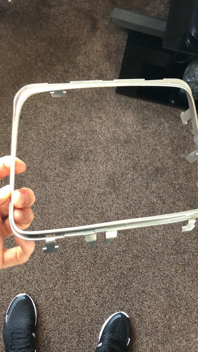

Hi looking for help to change out the chrome trip that goes around the flappy panel around the cup holders?

What help do you need? Its an easy swap but you need the whole console out just like if you were replacing the console trim. Once its out, screw out the cup-holder... replace the trim, screw it back in and refit the console

cheers mate was looking all over for a video but had no joy,

I had the chrome trim replaced under warranty. It flaked and was razor sharp! Contact a dealer, they should be aware of the trim flaking. If that’s your issue idk?
