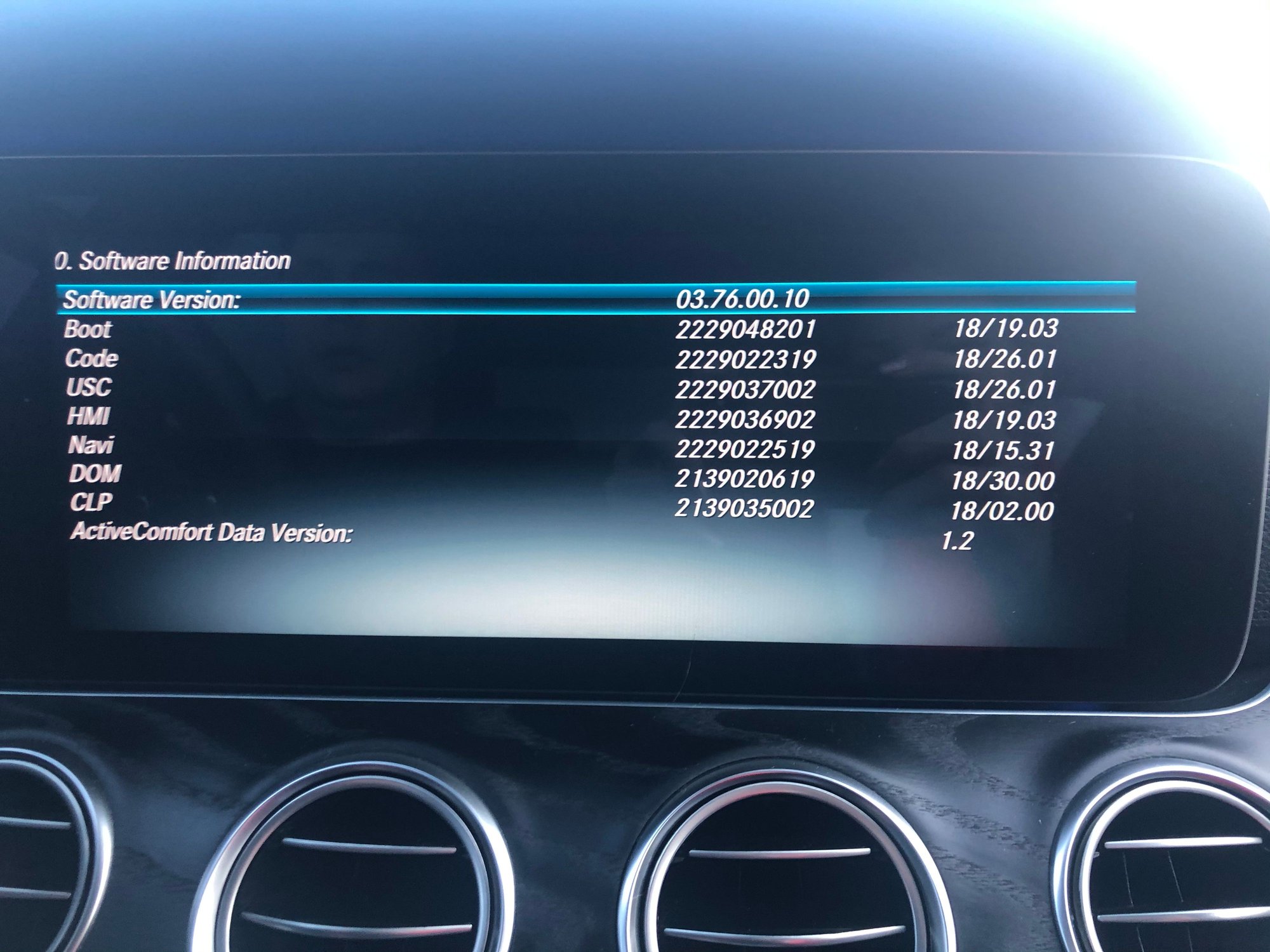

Hi,
anyone have any issues calling up Siri?
50% of the time when I hold the steering wheel button I see the Siri circle pop up but she is not “listening” the circle just sits there then car play becomes unresponsive and crashes and I can try again and it will work. Sometimes it will fail again.
no issues playing music while this is happening so I’ve ruled out cable issues.
I had Mercedes check and it and the diagnoses was I’m not holding the steering wheel long enough and only summoning the Mercedes assistant :/ ugh when clearly I see the Siri circle on screen
any suggestions?
see versions attached...

I have a 2019 C63S, so should be the same COMAND version as yours. Haven't had any issues with CarPlay, but I don't use it all that much. However, these appear to be known issues in iOS 14. Here's an article I just found that makes it seem it has something to do with the new CarPlay wallpapers. I also remember coming across another article that was talking about freezes if you have a certain Accessibility feature turned on in the settings, but I can't seem to find it anymore. I did make sure I didn't have it turned on on my phone, but can't remember which setting it was. All in all, Apple has some more bugs to fix.

I removed wayze, changed background to black and reset my all iPhone settings from General - Reset - Reset All Settings it still freezes. I updated to 14.3 same thing. It’s an occasion freeze.... really no on else ?

Your software may need updating?

I found the link to the other known issue I mentioned above. Make sure you have Assistive Touch disabled. Otherwise it's causing all kinds of issues.

Hi,
they checked and said there’s no updates.
I confirmed assistive touch is disabled.
sometimes Siri works, other times the circle just sits there, doesn’t “pulse”, no ‘ding’ and “she is not listening” the best way I can put it. After 20-40 seconds it goes away
