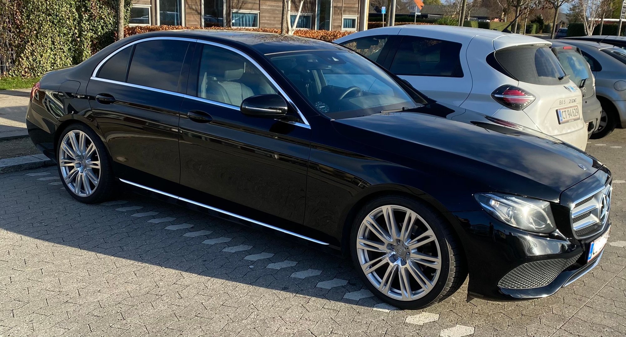

I have fitted 255/35-20 on mine... they dont scrub

Looks like a perfect fit to me.Very clean look...Thanks
