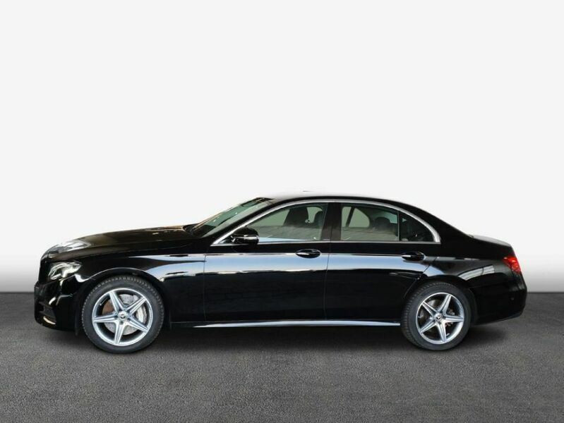

The car in question is below, it has AMG Line exterior and 19" AMG wheels according to the dealer.

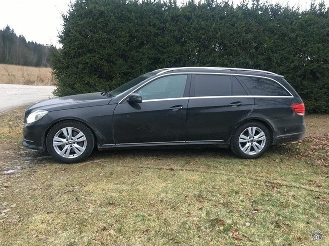

One of the wheel set I found, IIRC this one was used by older E-Class (W211 ?) ET 33, 16"

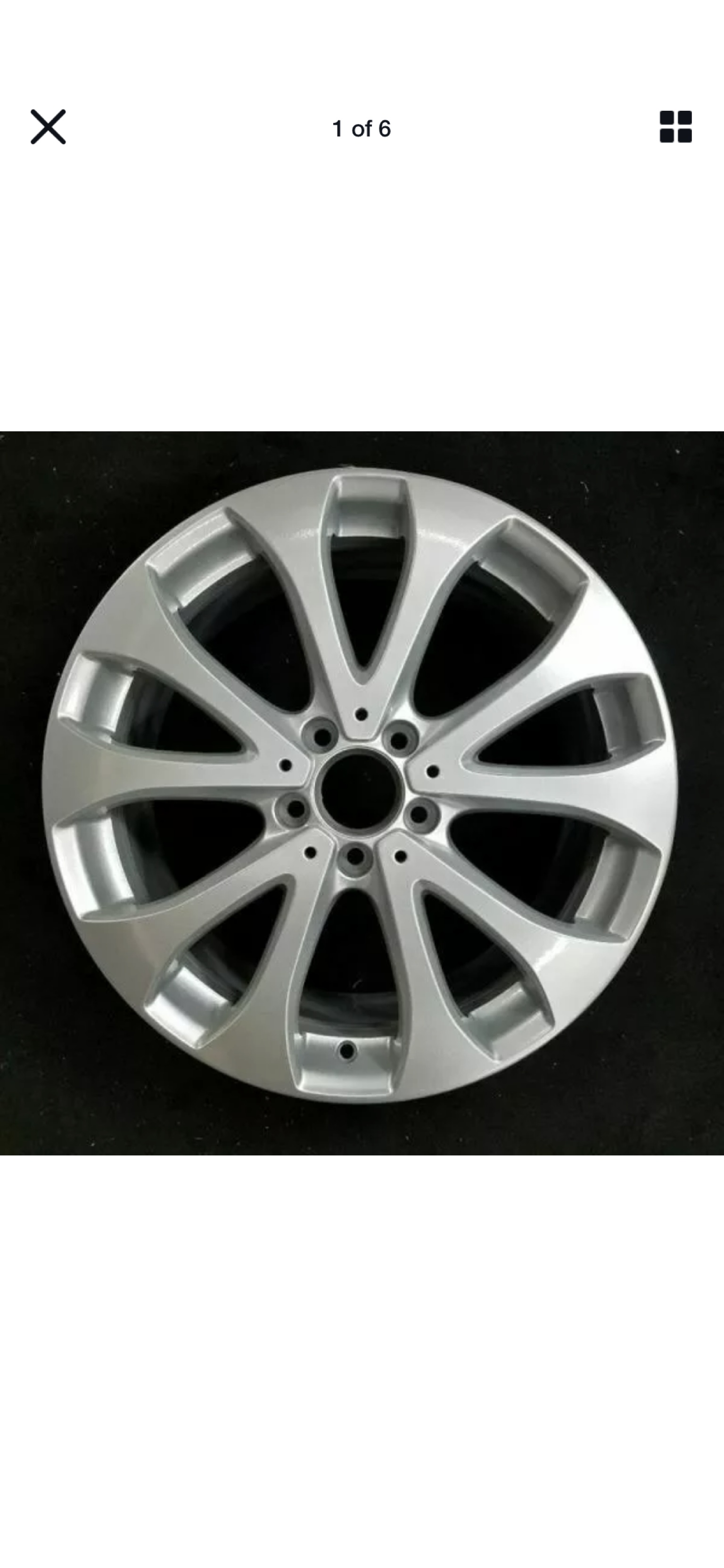

This one is 17", ET unknown but used on W212, tires by Nokian 225/55

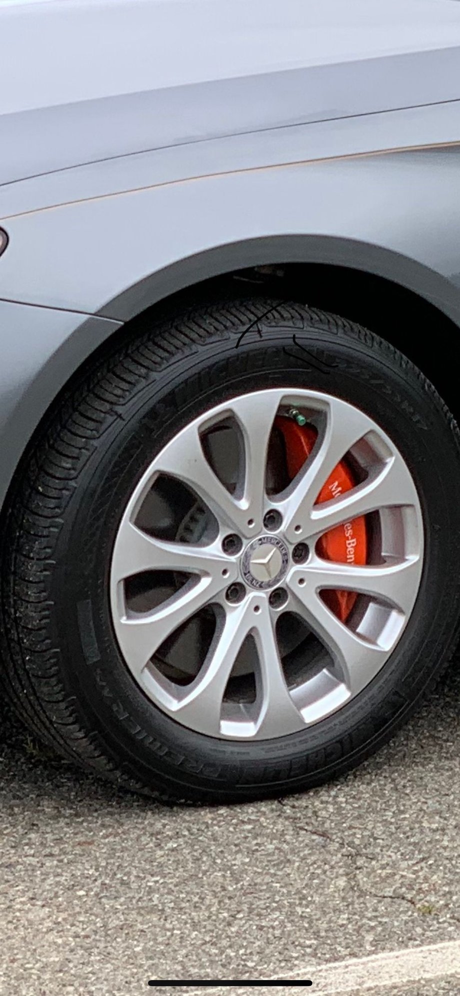

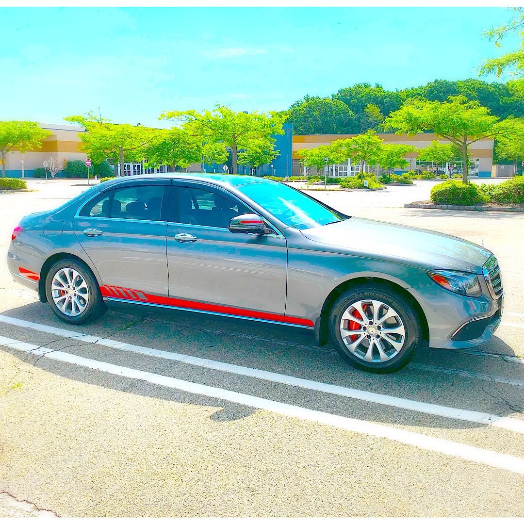

The size of your rotors combined with brake size is the main issue for not being able to go lower than a certain size. I have a 2017 E300 Luxury model and it came with 17” rims. It’s better to go with used OEM than new because any issues MB will say it’s the aftermarket rims. Good luck and enjoy, they are great cars. I have attached a couple photos of my 17”

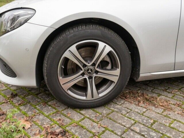

Hi, mine is 220D 4Matic and it's located in Bulgaria and the lowest i can go is 17" because of four-wheel drive. I saw some MBs with 16" but i suppose they are RWD. At this moment (winter season) the car now is with 17" 225/55 and they are the same with my summer kit. The car came with 2 sets of identical rims and tires (winter and summer).
