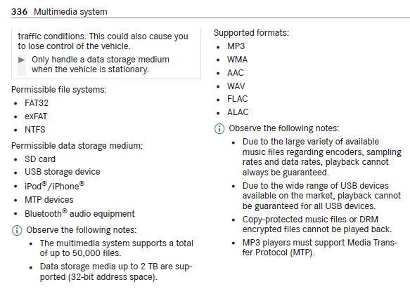

Different but related question, picking up my 2020 E450 wagon this Friday, what format does the music need to be to work on the SD card/thumb drive for the car to be able to read it? Thanks.

Thank you! I have a 2019 BMW R1250RT bike and I have a thumb drive with just over 700 MB of MP3 music for listening while I ride. I have iTunes so I had to convert the desired music from MP4 to MP3 to play through the BMW system, it didn't recognize MP4 format so it appears I'm ready to go. Thanks for your help.
