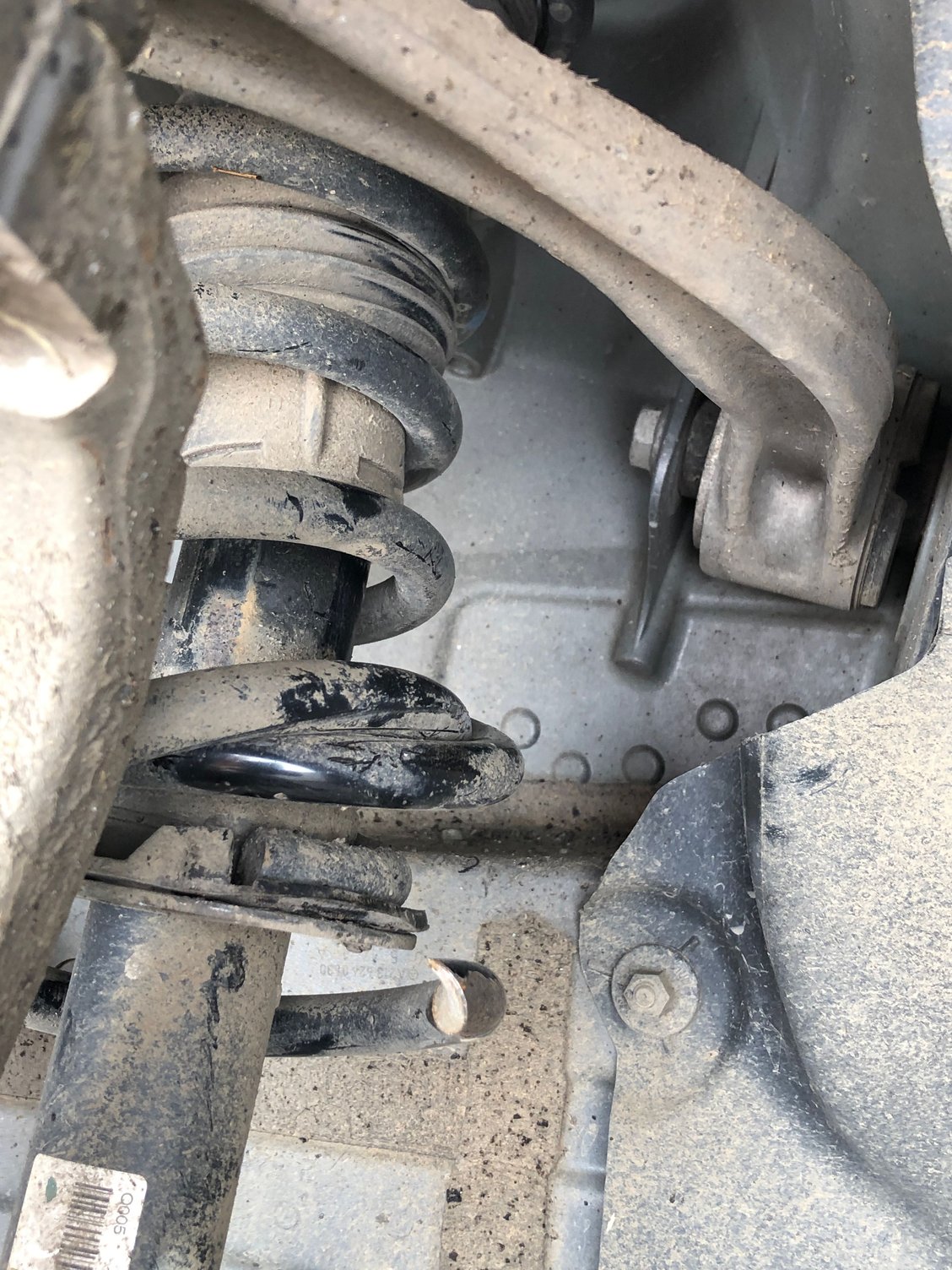

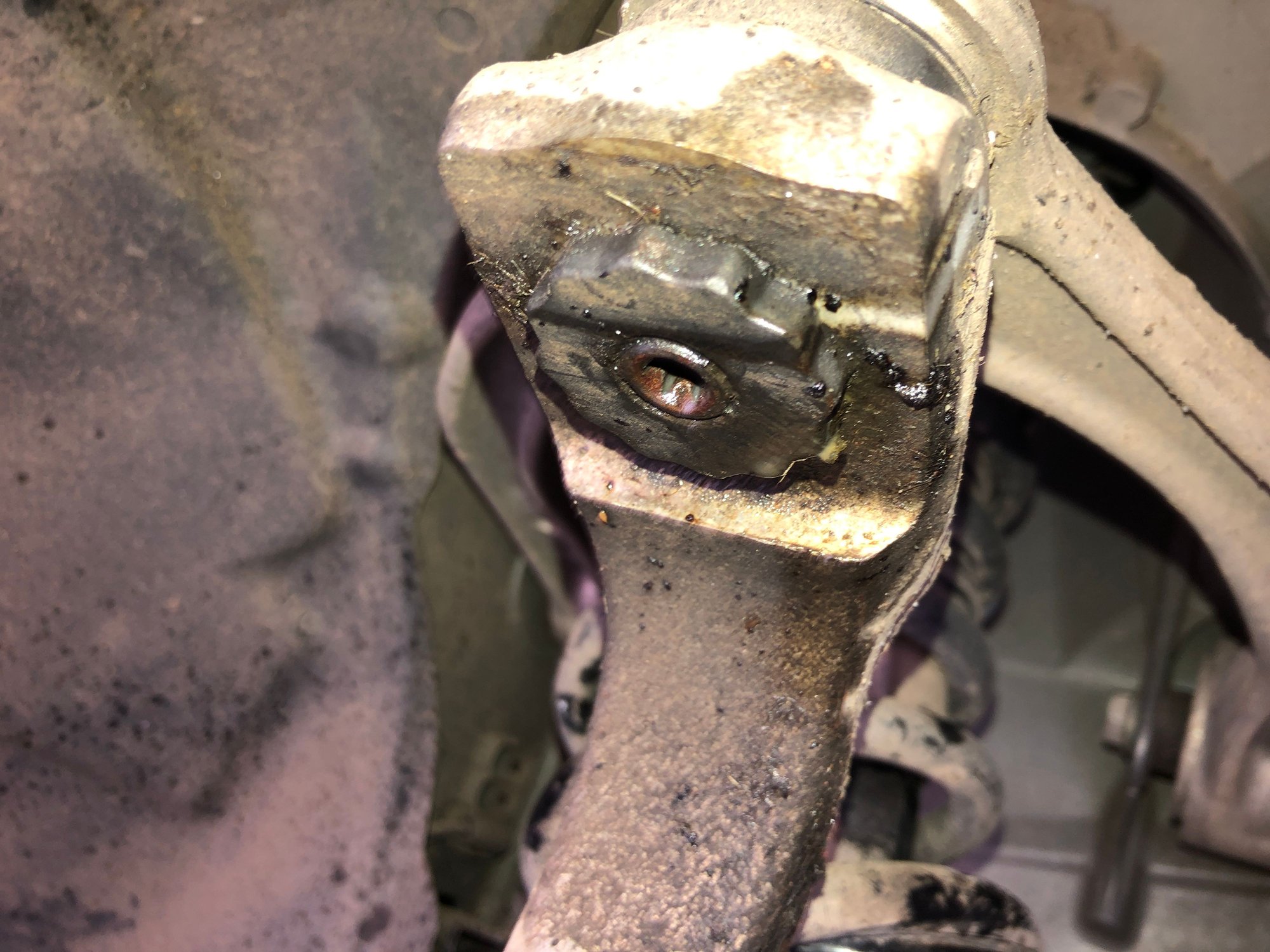

Hi guys please forgive a newbie but can you identify the nut that attaches the front hub to the top arm, it looks like a star bolt not a torx with the top ball joint in side it.This needs to come out so I can remove the broken spring….ouch

Top nut
Oh and appropriate tool for removing!

All ok answered my own question, it’s a twelve point nut at 32mm so a standard ring spanner will bring it off with a torx bit holding the ball joint steady. Couple of coils spring compressors to take the force of the broken spring off the control arm and out with the shock, just got to wait fir MB parts to get their *** into gear now….
