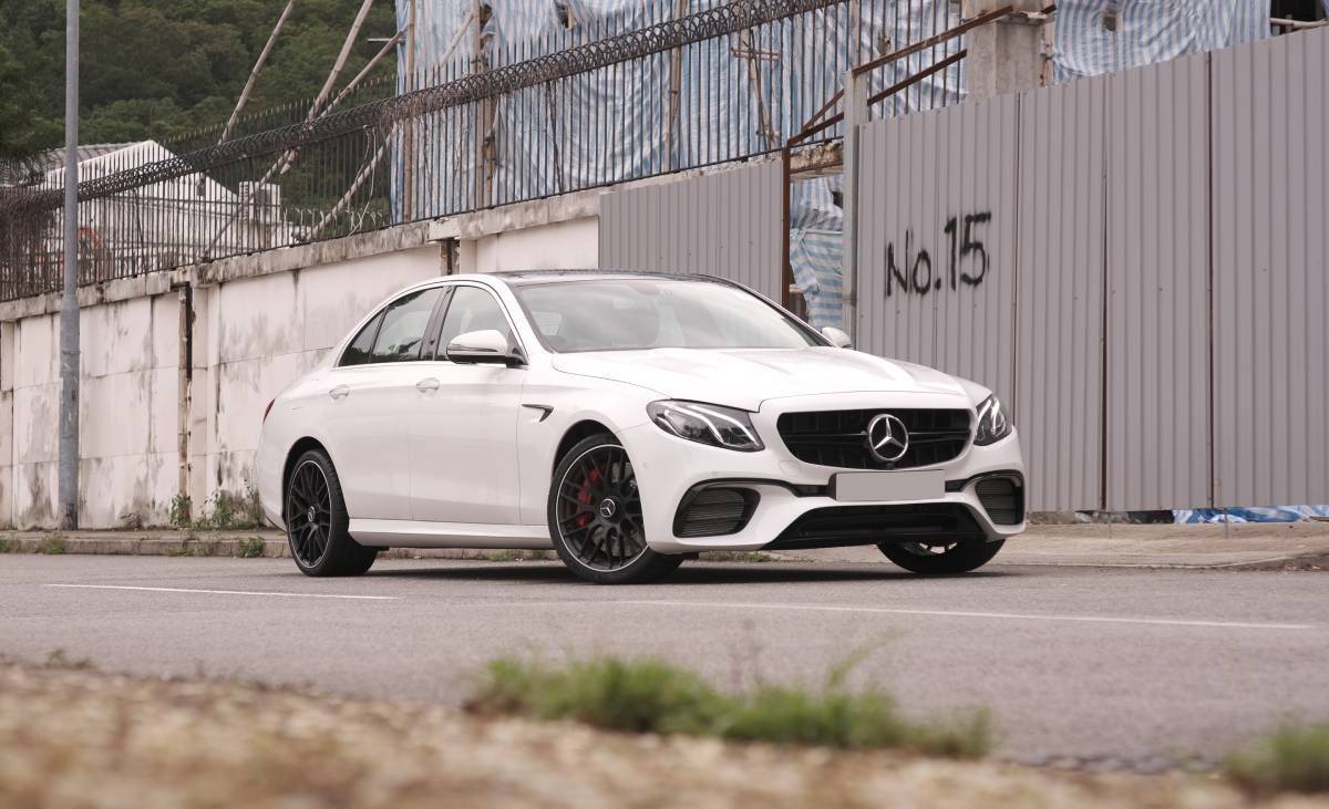

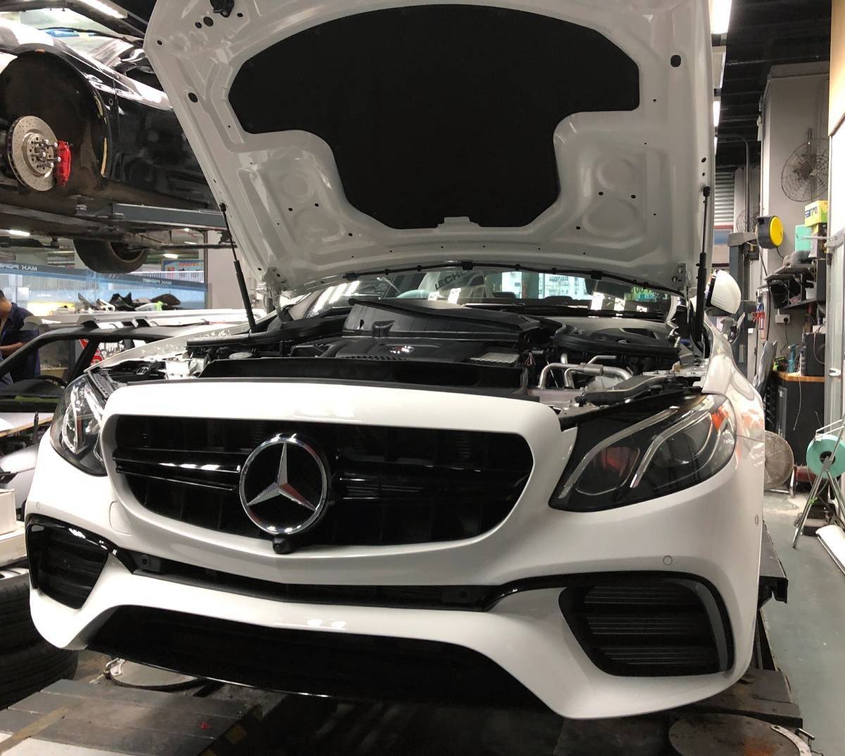

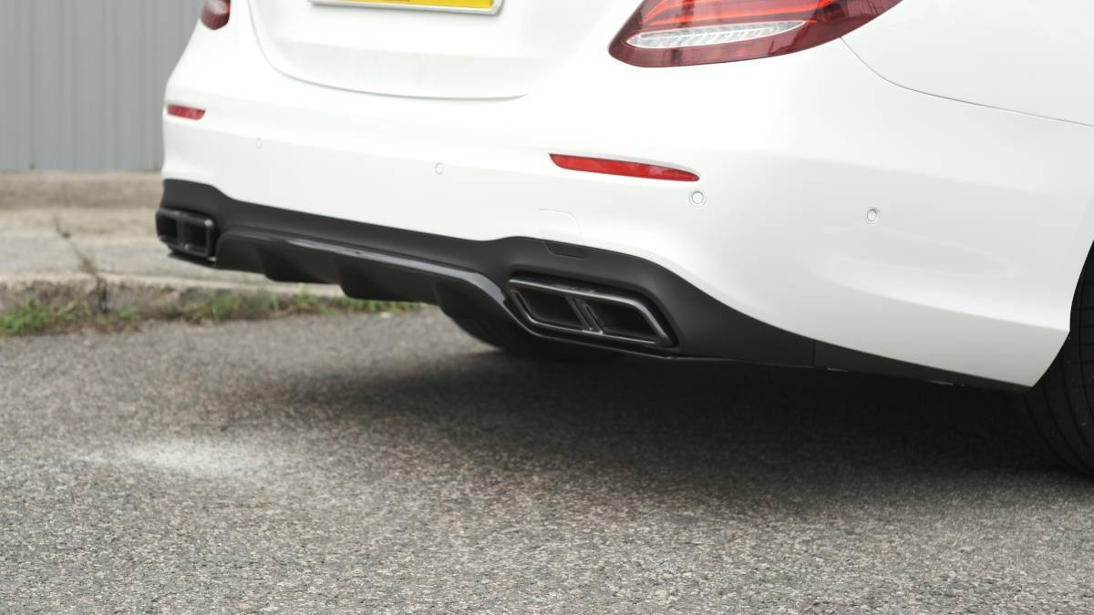

Mercedes Benz E-class W213 E200 w/OES E63 body kit, Genuine AMG E63 brake kit upgrade

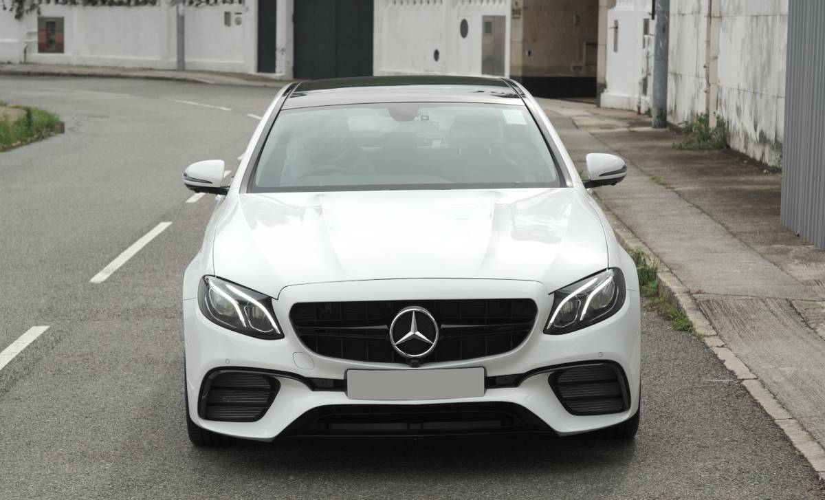

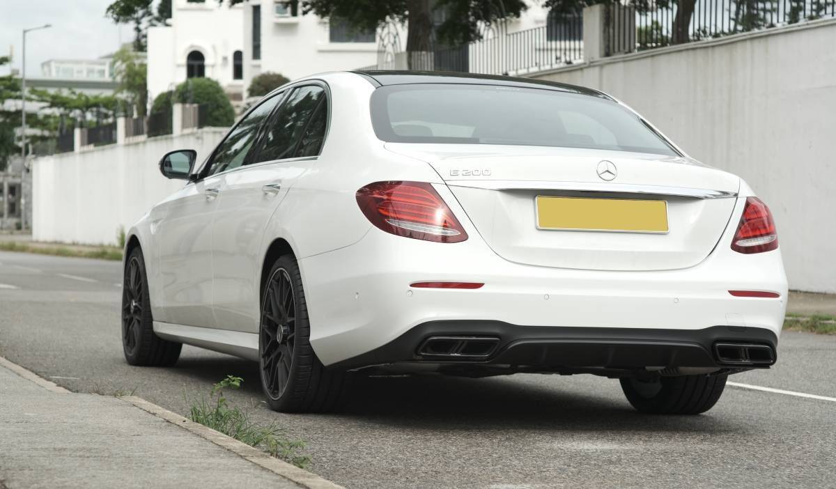

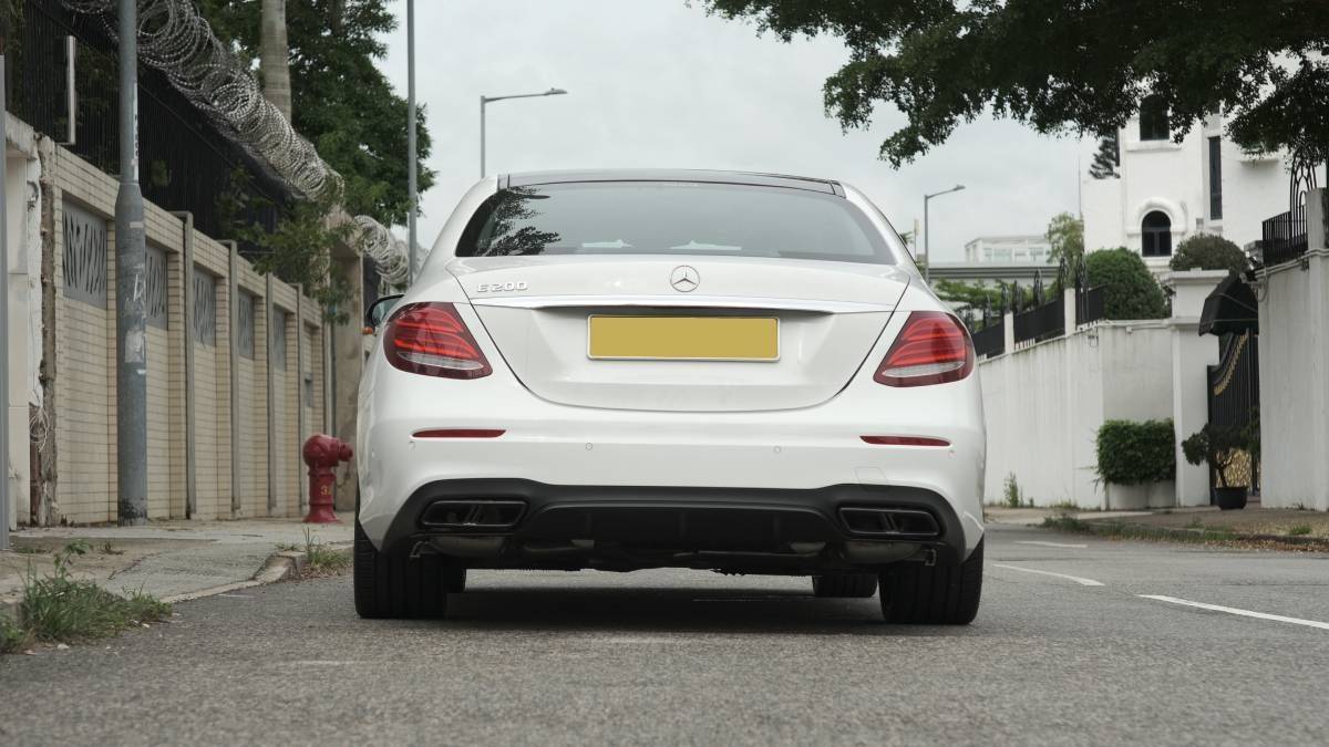

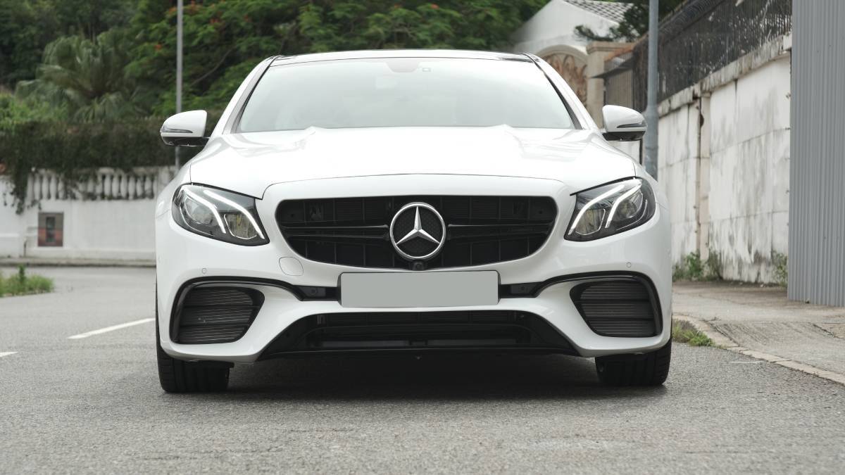

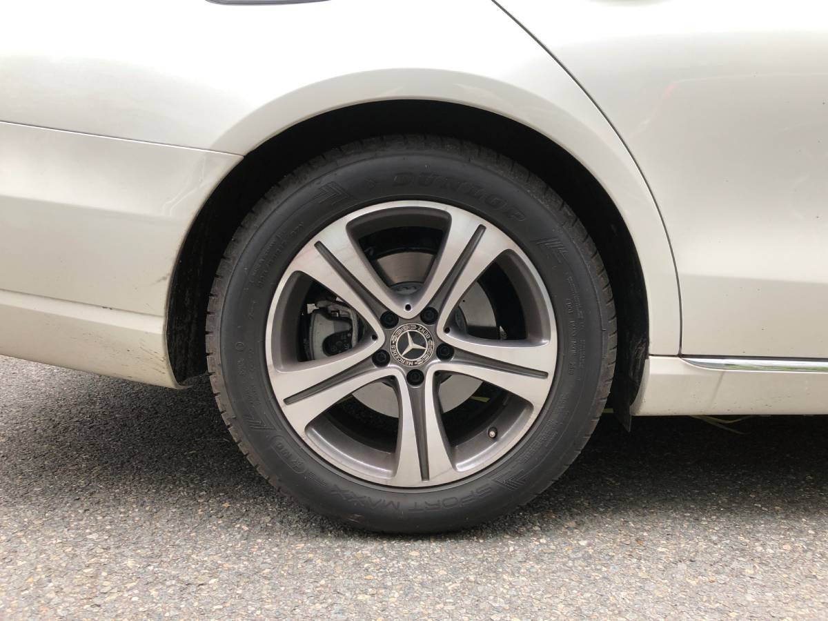

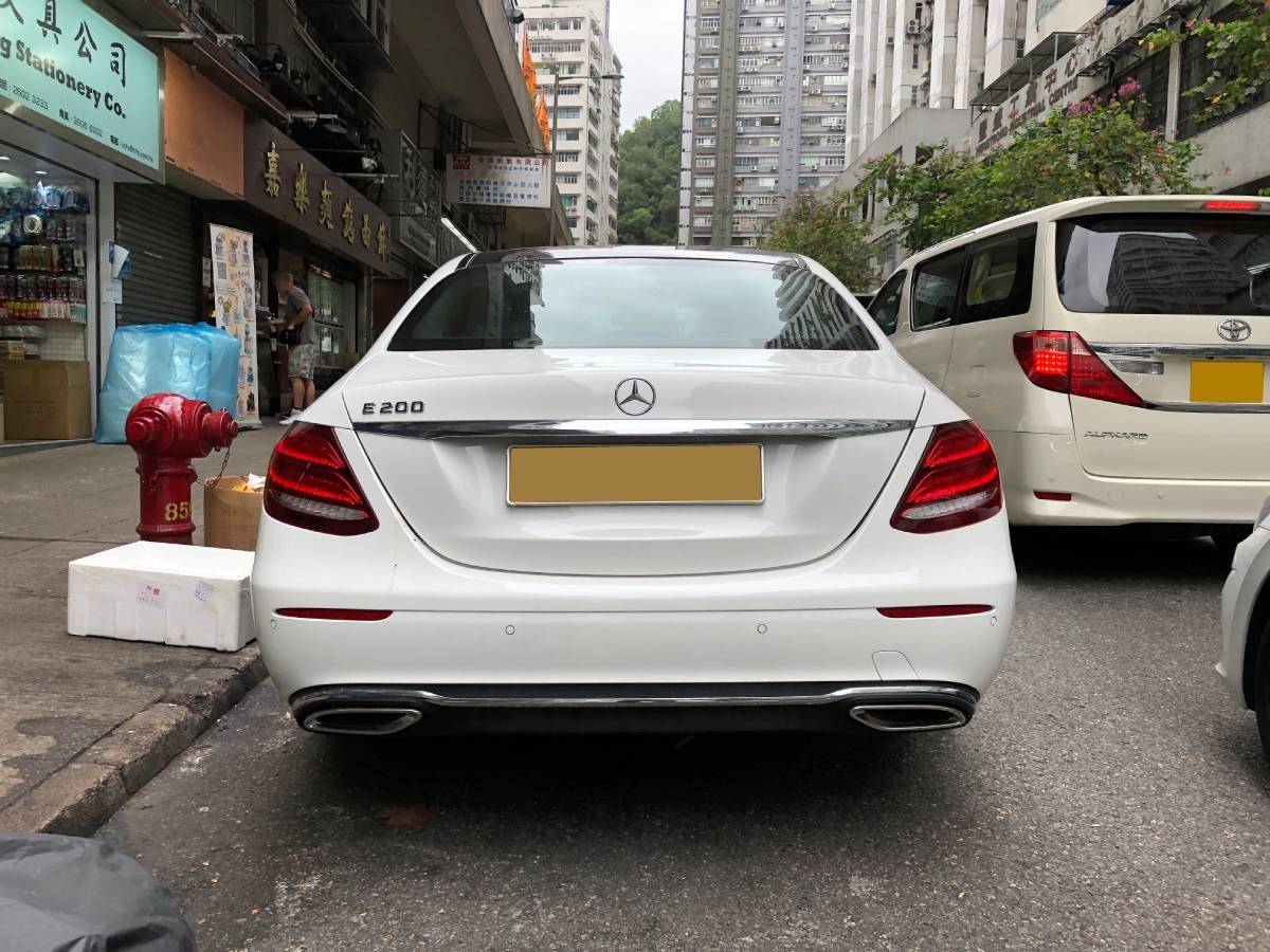

Major remodeling for this completely stock W213 E-Class E200.
Full E63 body kit from OES was painted and installed.
This body kit includes the following parts:
- Front bumper
- Front grille
- Side skirts
- Rear bumper
- Diffuser with black chrome quad exhaust tips
Window trims and the chrome trim on the trunk was wrapped in gloss black to completely dechrome the car.

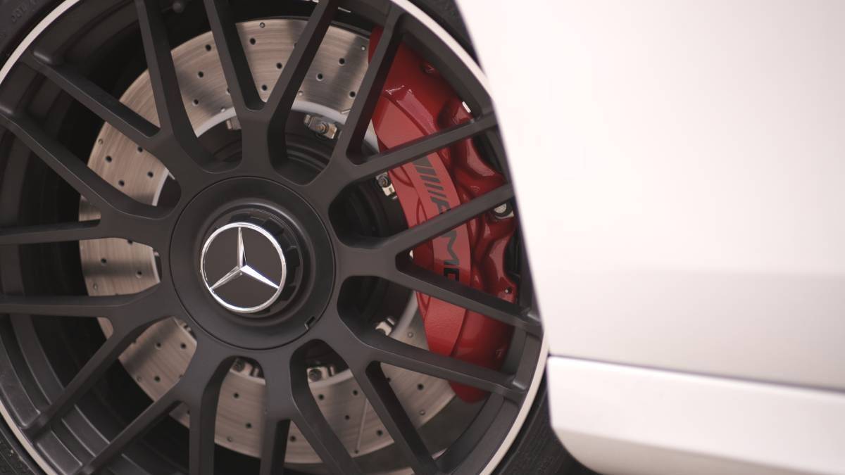

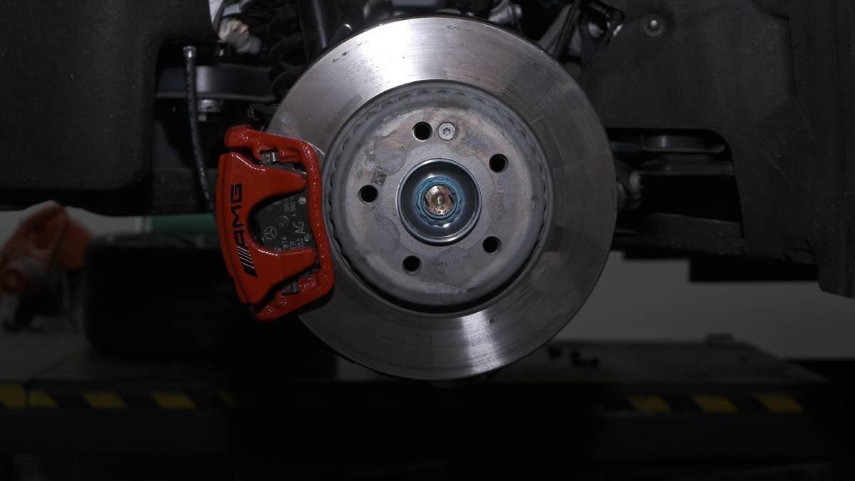

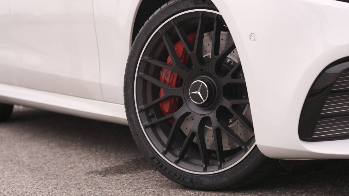

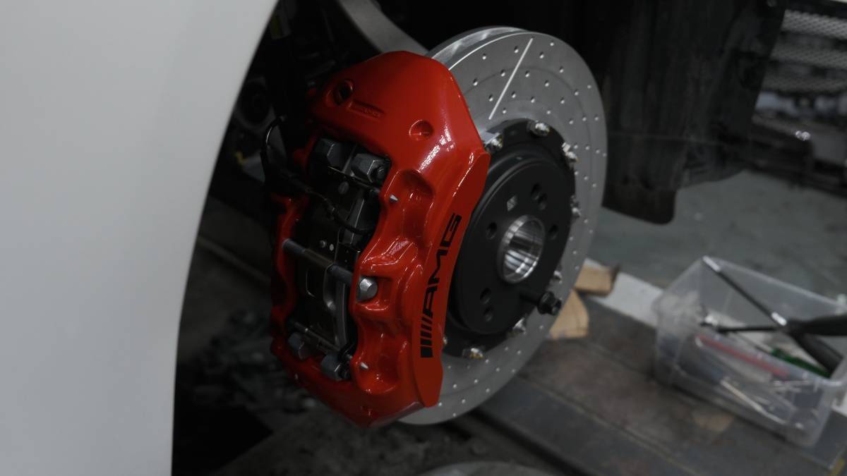

Genuine Mercedes Benz AMG E63 brake kit was also installed onto the car.
Front running 6 pot brake with 390mm floating, drilled, ventilated disc and rear 1 pot with 360mm drilled, ventilated disc.

AMG E63 brake kit part numbers
Hi Richard,
I also want to upgrade my 2017 W213 E220D with the AMG brake kit.
Do you know the part numbers that you use to upgrade AMG E63 brake kit?
Thank you.

Wow, looks great. You are all in
