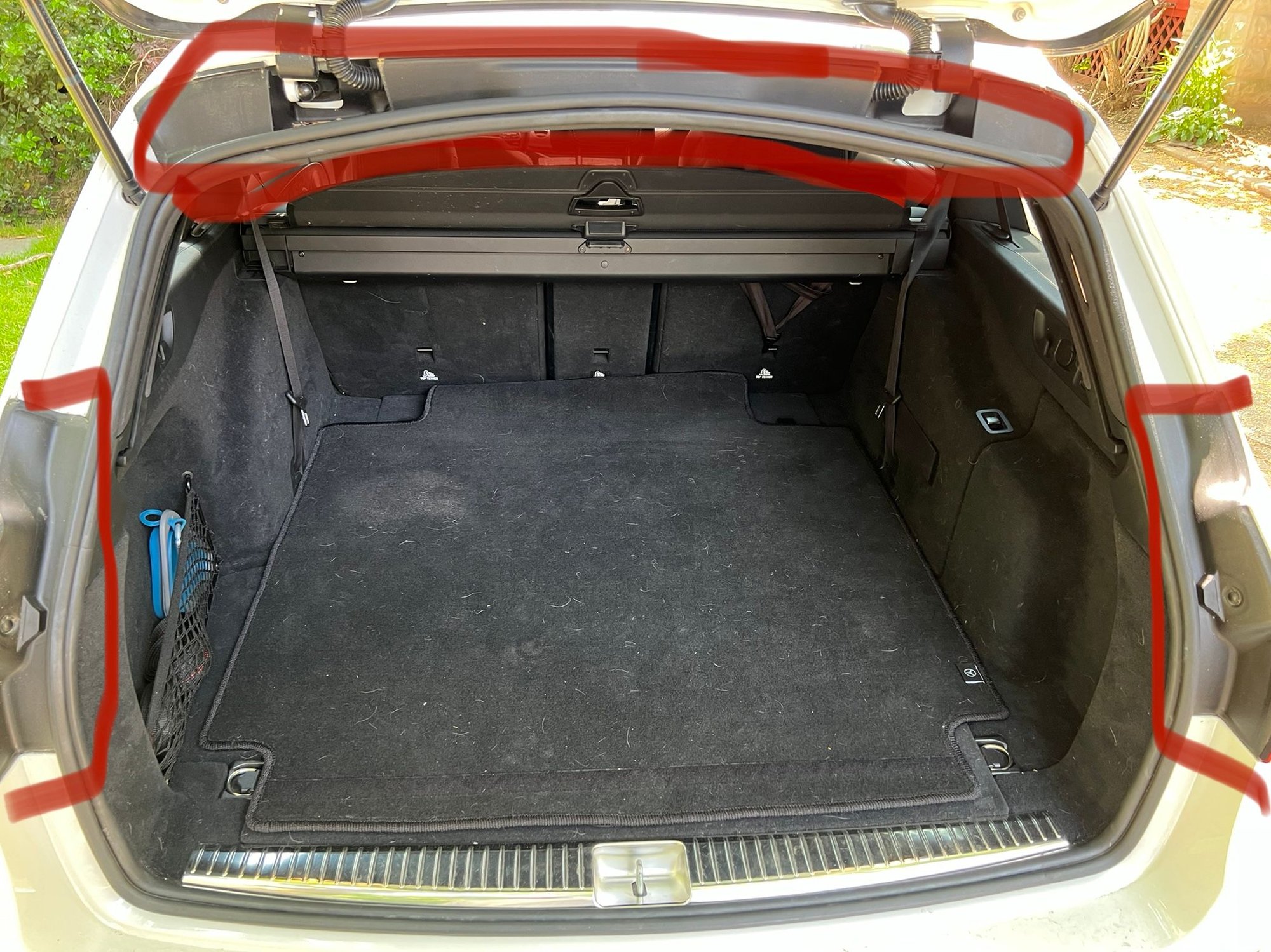

Are these easily removed for cleaning? Wagon Rear Hatch
Unfortunately, my wagon spends its life outside. I’m pretty good with regular cleanings, but I’m always trying to maintain drain lines and remove tree debris from as many areas as possible.
Does anyone know if the plastic panels marked in the attached pic are easy to remove? Or, will there be significant additional disassembly required?
I don’t want to rip them off and risk snapping something. Thanks in advance!!

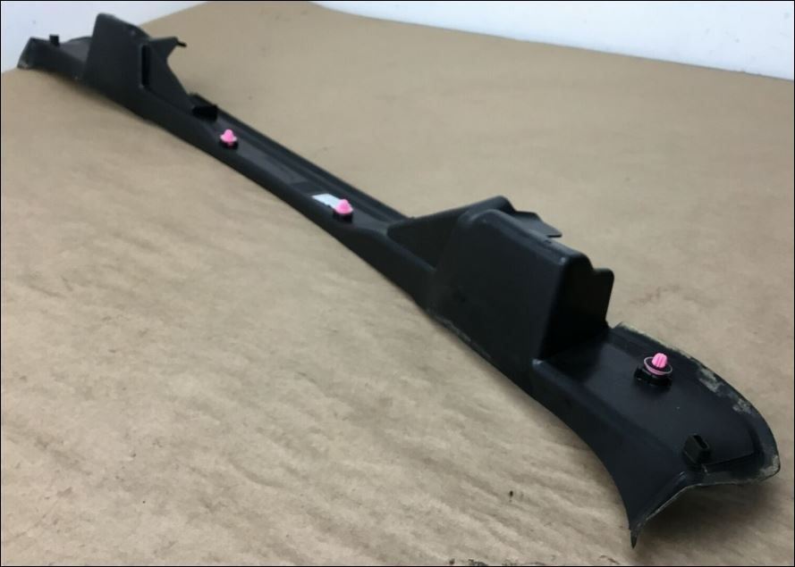

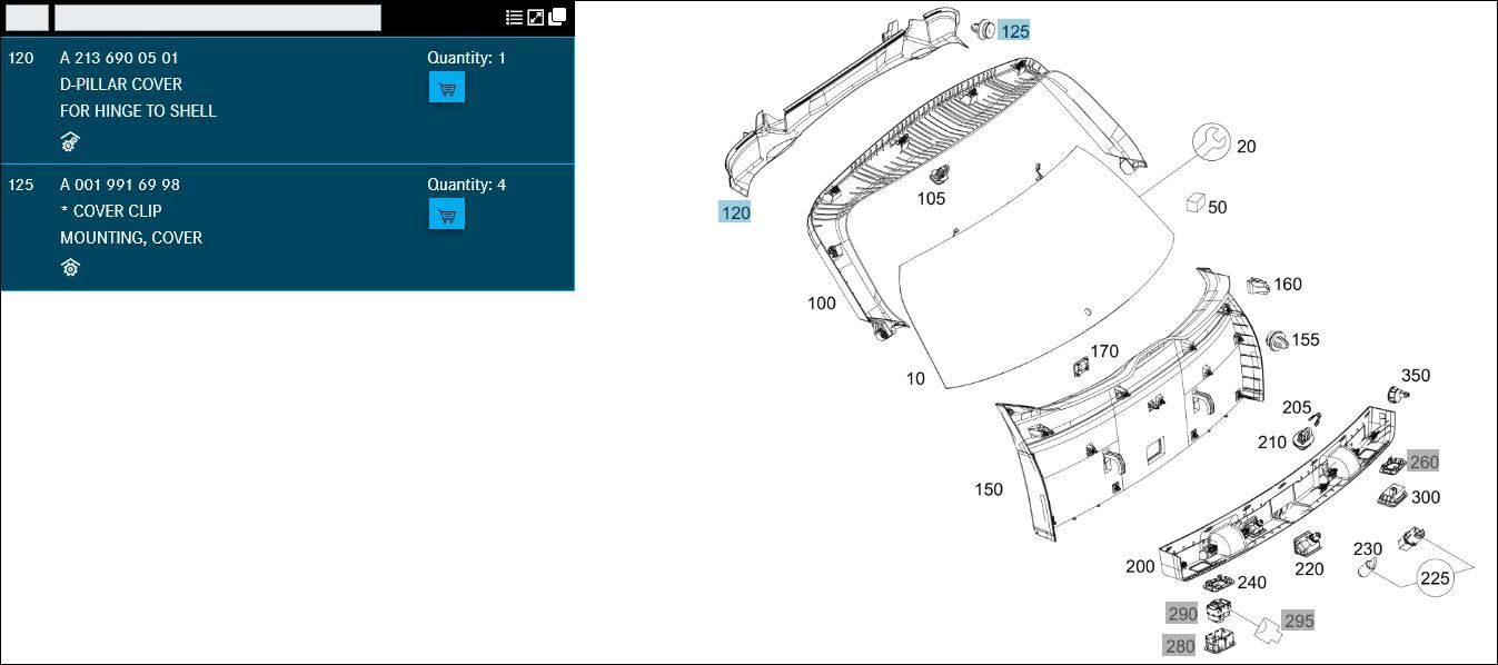

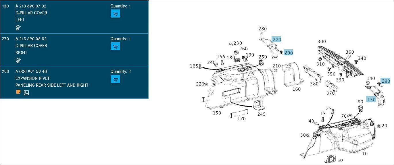

Try this carefully unfasten top with plastic wedge, underside shown has 4 clips that need to be released. Sides pull center of rivet up to release (note associated bulletin) unfasten panel with wedge.
