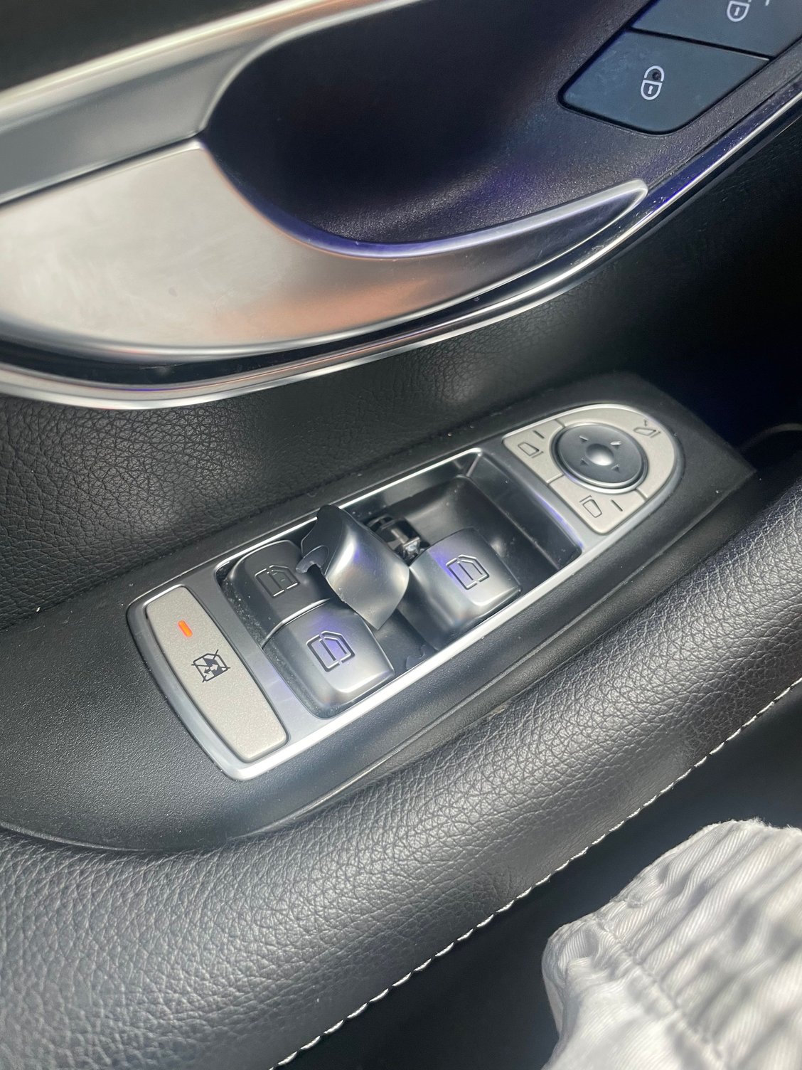

Tried to roll the window up leaving the garage at work and the damn button broke off! Anyone else have this happen? I have an appointment on Friday morning…

Thats frustrating. MBs are a higher priced vehicle, this doesn’t reflect that fact.
it’s not the best. But pretty close to nothing.

Had the same button on my 2018 E43 AMG break like that a few months ago. Bought one off of eBay and replaced in less than 5 minutes. Plastic is plastic but for the price of the car I would have expected aluminum at least.

Quite common for the cheaply built C, E (it's basically a long wheelbase C), and GLC models.
The window can be rolled up from outside using the key.
Or using the FOB.

Looks like a weak knit line in the molded part. Poor design of the injection mold tool or poorly controlled molding process. Not necessarily bad part design. Still, inexcusable in any modern motor vehicle.
