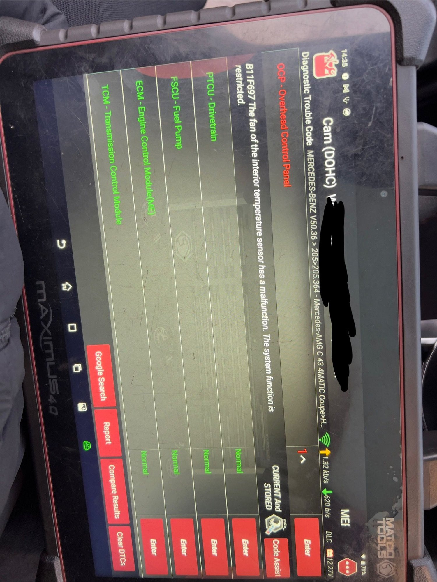

B11F697 On C205 C43 (W205 platform)
Hello everyone
I’m having the same code (photo attached) where can I find one of those diagrams? I tried to pin pint the sound and it seems as it is coming from the A piller / dashboard corner of the left hand driver side
how can I fix or where do I blow air?
