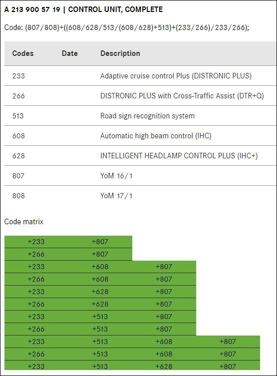

Hoping someone might be able to assist regarding interchangeability of parts with the multifunction camera (A40/13). My car is an A238 Cabriolet but posting here in the W213 forum for greater exposure given these components and systems are the same and the donor car is a W213.
My car’s VIN: WDD2384482F042172 (2018 E300 Cabrio)
The camera part number in my car: A213 900 57 19
The donor car’s VIN: WDD2130642A185754 (2016 E43 Sedan)

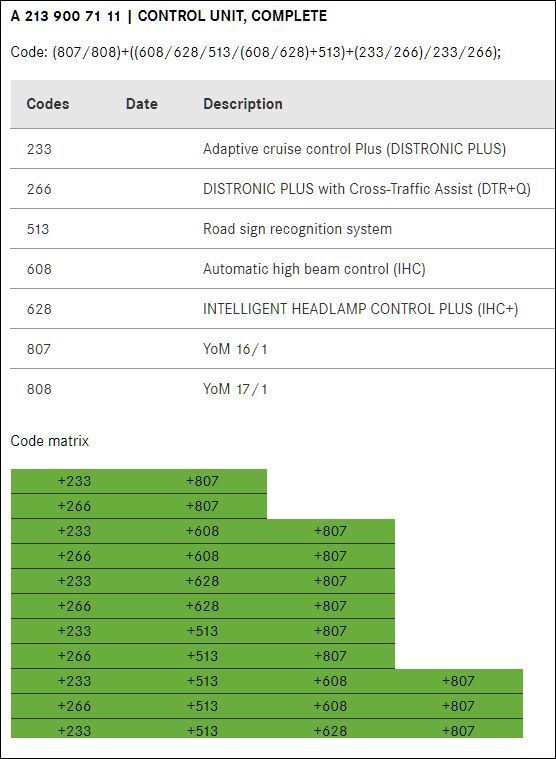

The part number on the replacement I’ve sourced: A213 900 71 11
Looking online in some part catalogs there are suggestions that these are interchangeable and replacement I’ve sourced is just the version immediately prior (and that the software in the unit should auto-update when my auto-electrician codes and calibrates it using his Mercedes service system, assuming this is Xentry?).

Old Mar 12, 2023 | 03:53 AM
konigstiger's Avatar
Posts: 15,901
Likes: 4,633
From: North Scottsdale, AZ
'71 Pinto
Coding matches not sure why they’re different part #s other than production range. Part should be checked for correct flashware after install.

Hi! Just coming back with an update- unfortunately we couldn’t get this replacement camera to code with the car. Unsure if that was because there was something wrong with the camera, a compatibility issue with the car, or a limitation of the equipment being used to configure it.
Luckily, my auto-electrician was able to source a camera with an identical part number within a day, this has been coded and calibrated successfully. The error messages are now gone and I have intelligent drive features back again.
I was able to return the other camera for a full refund. So this all ended happily ever after. 😁
