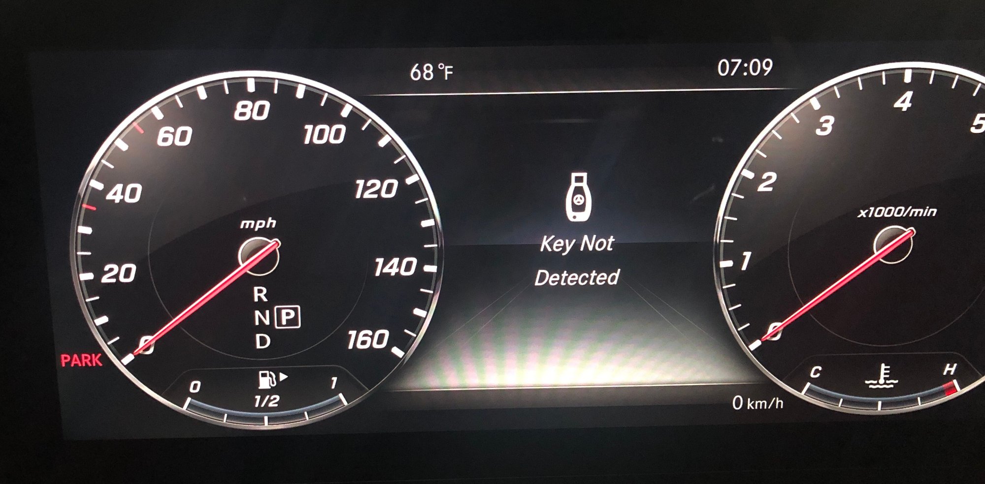

To clarify, when I do drive away, I do not get a warning that the key is not detected.

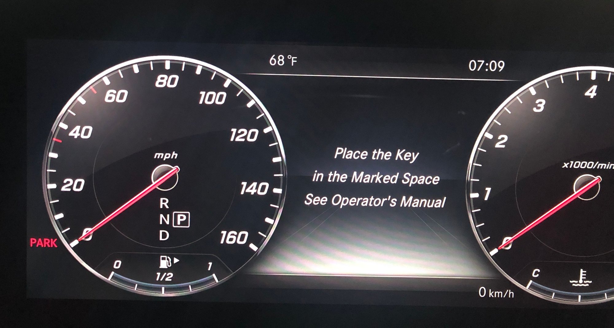

Here's what you should see when you try to start the car without the fob being in the car or otherwise within range (two screens):

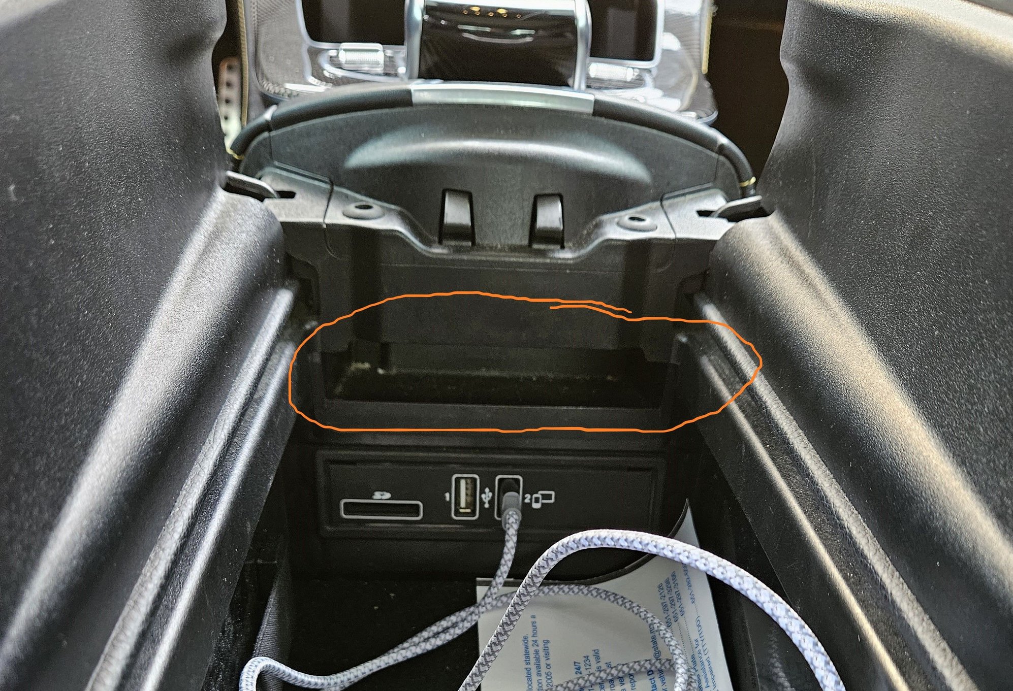

Can you check this spot to see if there is a key there?
