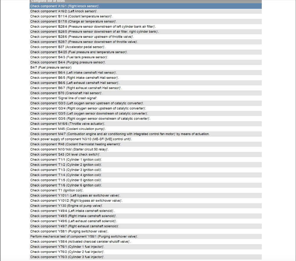

From other threads, it appears that Mercedes uses the open position for the wastegate as the default. That's good because any malfunction keeps the wastegate open and the worse is loss of boost and maybe limp mode. A default closed position can cause overboost and serious engine damage, like a blown engine. Also, Mercedes seems to use a separate vacuum pump for the actuator versus engine vacuum. If you are still having problems, I would check that the vacuum pump and all vacuum lines are in good working order since you confirmed that the actuator is OK. Using XENTRY you can actuate the switchover valve and vacuum pump.
Here's a list of all the test functions you can perform with XENTRY. Some of the tests are manual and some are automated. This is for my car with the M276 3L biturbo. It may be different for yours.
