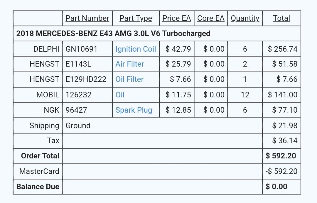

As we are the vehicle owners, we are welcome to do whatever we want. If you feel you can get 100K or 200K out of a set of plugs, go for it.
I do most of my own service, so my cost is very low. I understand the desire to extend the service intervals when you go to a dealer because it's so expensive to do just about everything.
I can speak to my personal experience though and I changed the plugs on my W205 at 48K and my W213 at 54K and in both cases I could actually feel the difference in sharper throttle response and overall smoothness so I have my own verifiable evidence.
If anyone wants to go longer on the plugs, I don't think it's a big deal but their performance is most likely diminishing.

Old Dec 24, 2023 | 12:22 PM
Keith66's Avatar
Joined: Oct 2018
Posts: 1,430
Likes: 820
From: Florida
2018 AMG E43
Originally Posted by JTK44
With the V6 in my E450 changing the spark plugs is not an easy task: They are buried. In times past and on my tractor I had no problem changing plugs. But the Mercedes V6 is a different animal.
