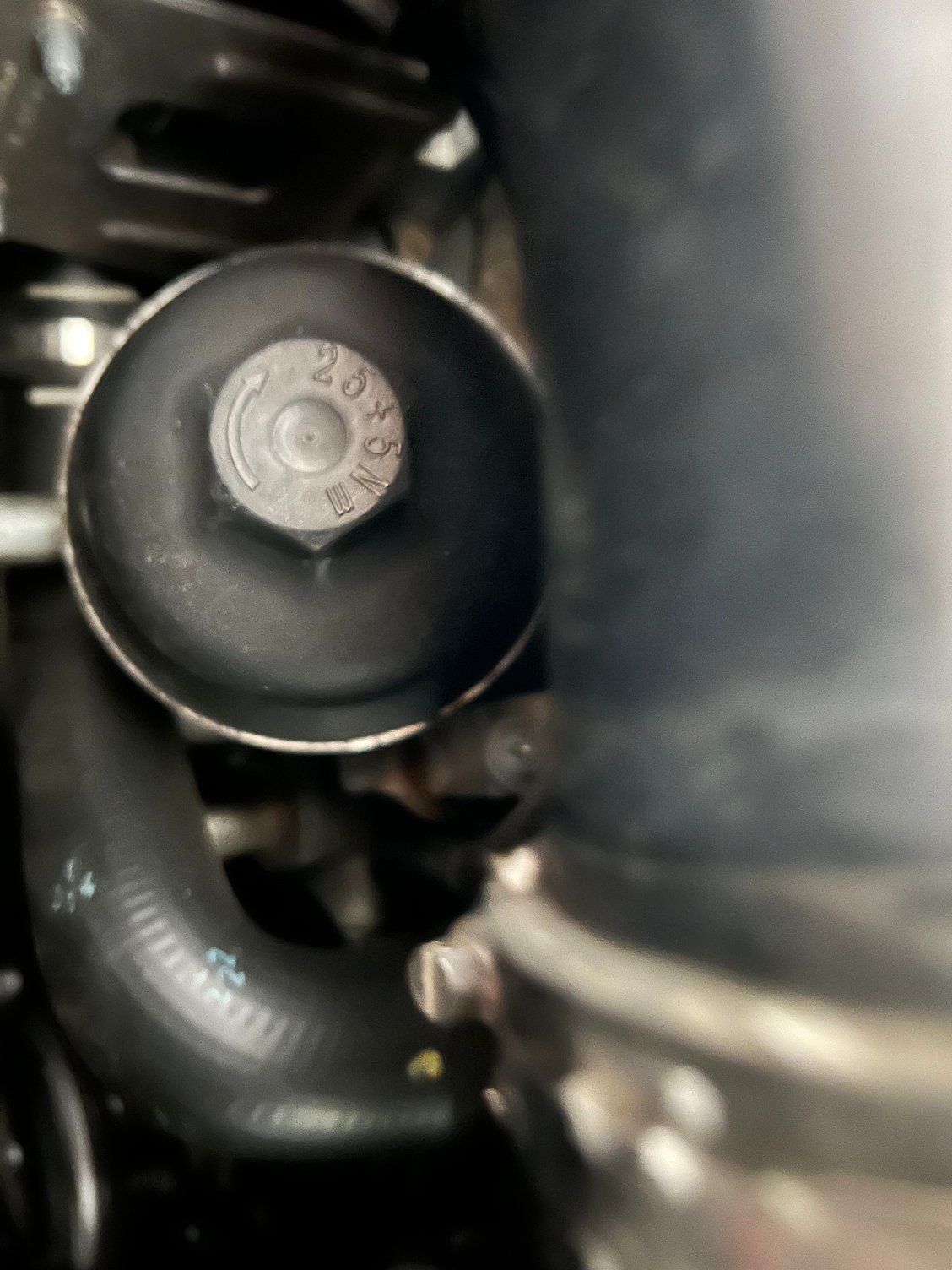

Hi Guys,
Which socket can I use for remove oil filter? I bought oil wrench from pelican but looks like doesn’t fit.

That engine should be the M274, so likely 27mm socket.

I think you already noticed but the cap says 25nm, so torque it to 25nm when done : ) The +5 means if needed then 30nm, make sure to not go over.

It’s a 27mm socket that fits on the oil filter housing top to remove it.

Thanks for confirming, guess we were right.
