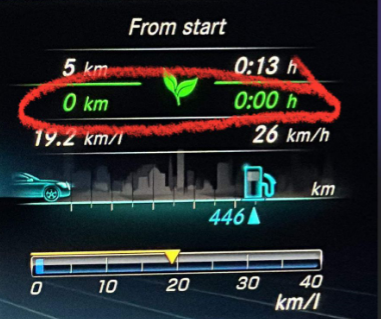

Other question about consumption. my car is Diesel why the used IC getting from hybrid. How to hide or delete the green text?
I understand that it's about battery consumption. Not sure if my understanding is correct or the green text is about eco mode drive saving?

This explains it.

Thank you, But I can see the same screen on another car. They do not have this green text.

Is a different screen withing the trip menu group. Select that window with your driver side steering wheel control and going up or down will move you between screens, the three part eco display is also there.
