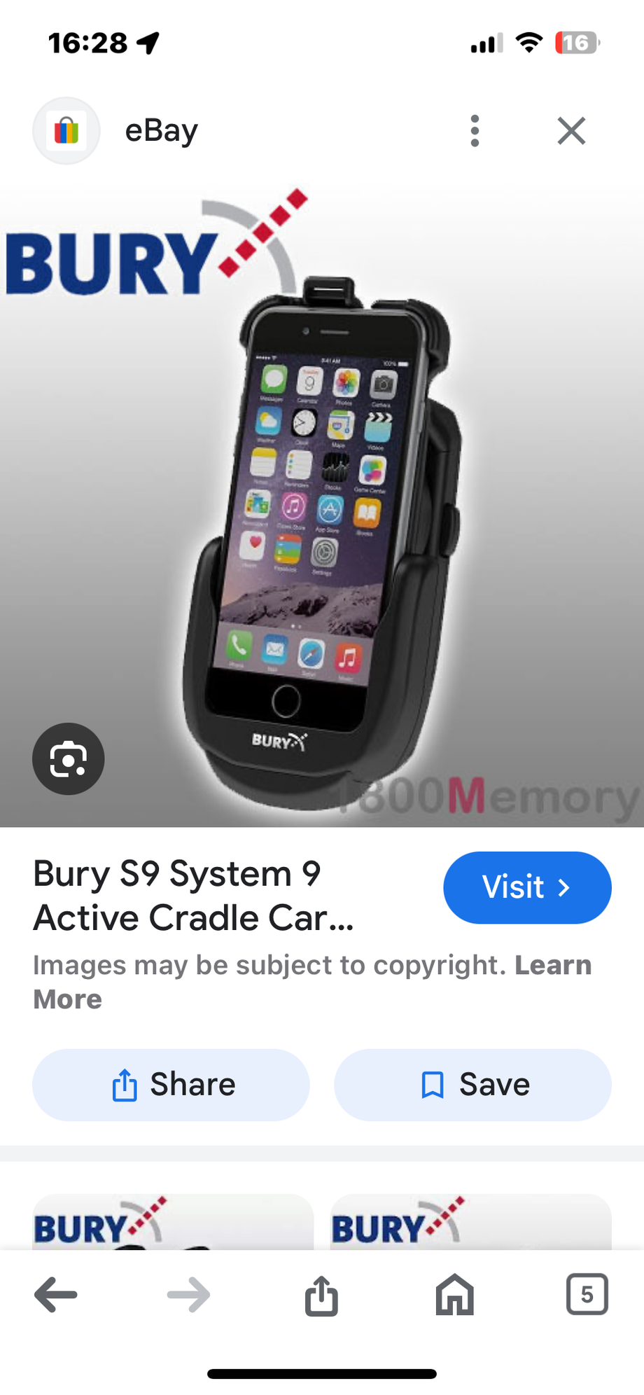

agreed I’ve tried 5 now and all have issues I’m thinking more along the lines of a cradle now with the lightning cable connected direct to the usb port for the CarPlay that way it will be 100% reliable always be charged and have full functionality
