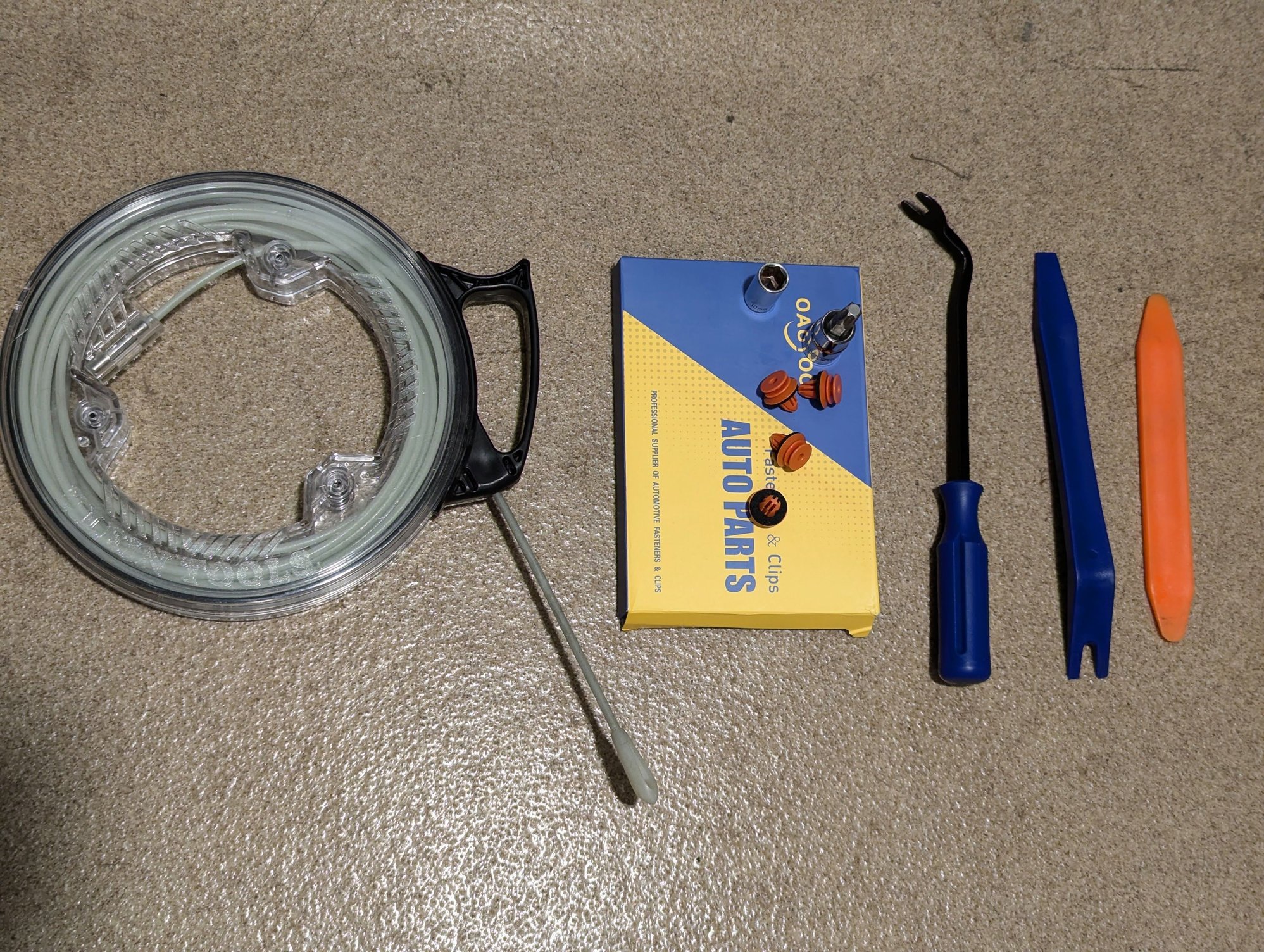

Tools
  1. T45 torx bit
  2. Panel trim removal tool
  3. Interior trim panel retainer 000-991-86-98 (4)
  4. Fish tape
  5. Wire cable pulling lubricant
  6. 3 amp fuses (4 regular ATC style)

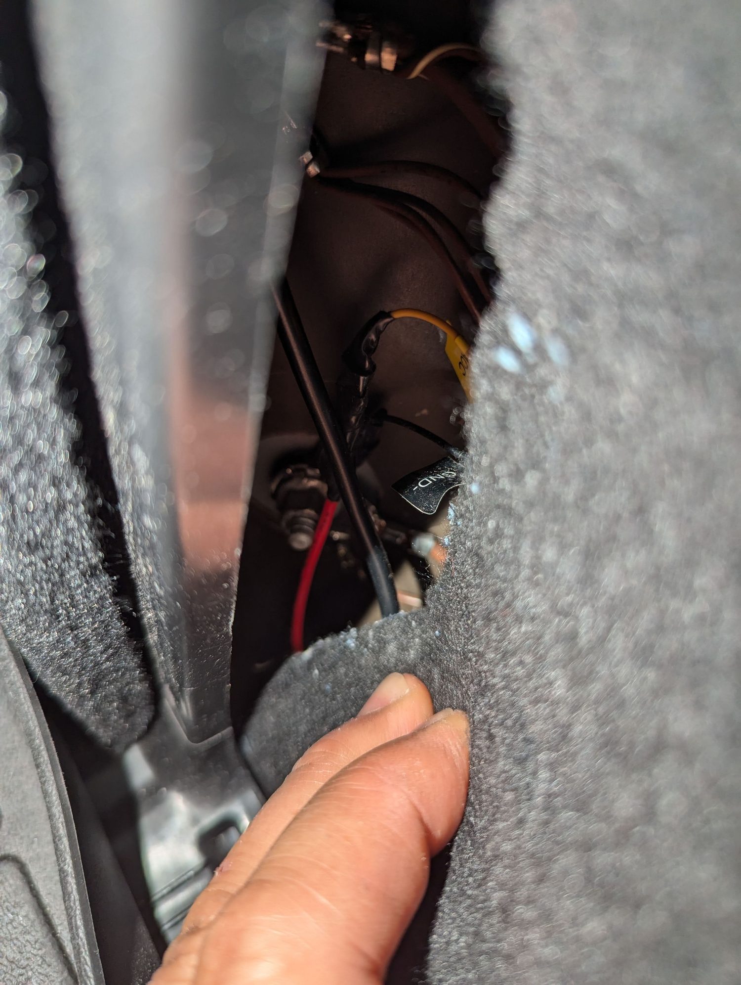

  • Remove carpeted panel that hides the rear fusebox on the passenger side of the wagon and push aside the insulation. Examine the fuse box, cables to ground, and open areas along the side of the wagon that you can use to fish cable into the rear seat area.

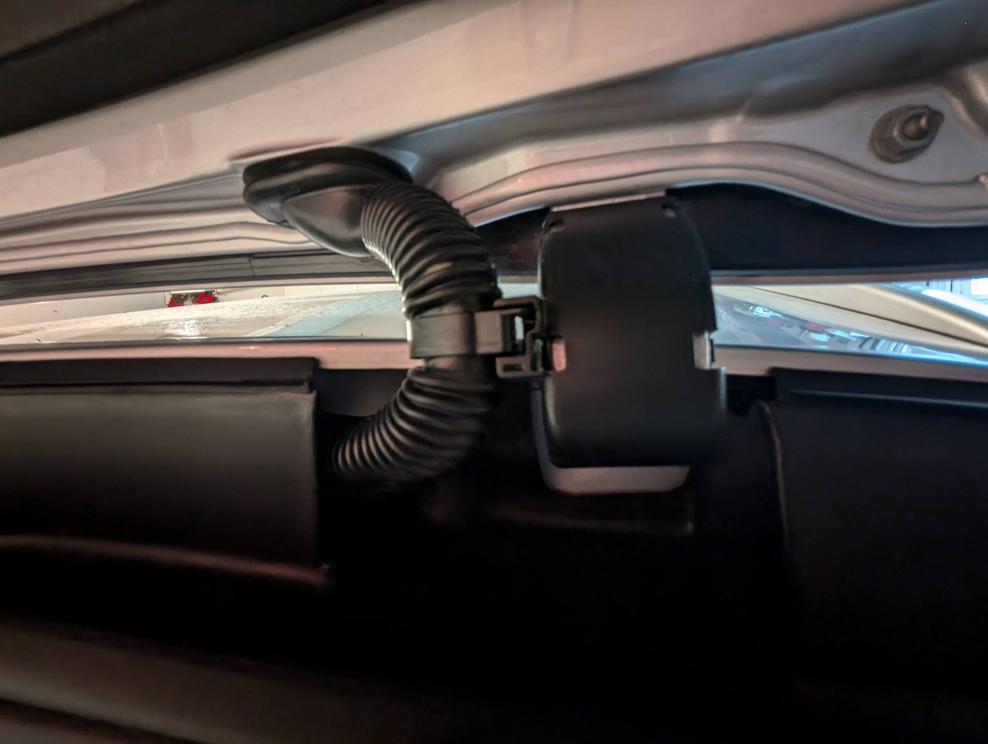

  • Examine the passenger side ribbed rubber hose that covers the wiring harness connected to the tailgate to the wagon. Consider how you want to route a cable to the rear windshield dash cam - along the roof or along the floor. Your situation may be different than mine because of the length of cable you have to work with.

It’s assumed you know how to test for power in the fuse box.
  • Find an open slot that has constant power (power is always on).
  • Find an open slot that has switched power (power is on with ignition).
  • Install fuse taps in the identified slots.
  • Confirm that fuses in the taps have constant and switched power.
  • Connect dash cam accessory wire to the fuse tap that has switched power.
  • Connect dash cam power wire to the fuse tap that has constant power.
  • Connect dash cam ground wire to the screw attached to the frame.
  • Confirm that the dash cam is working as expected when connected to the USB power cable.

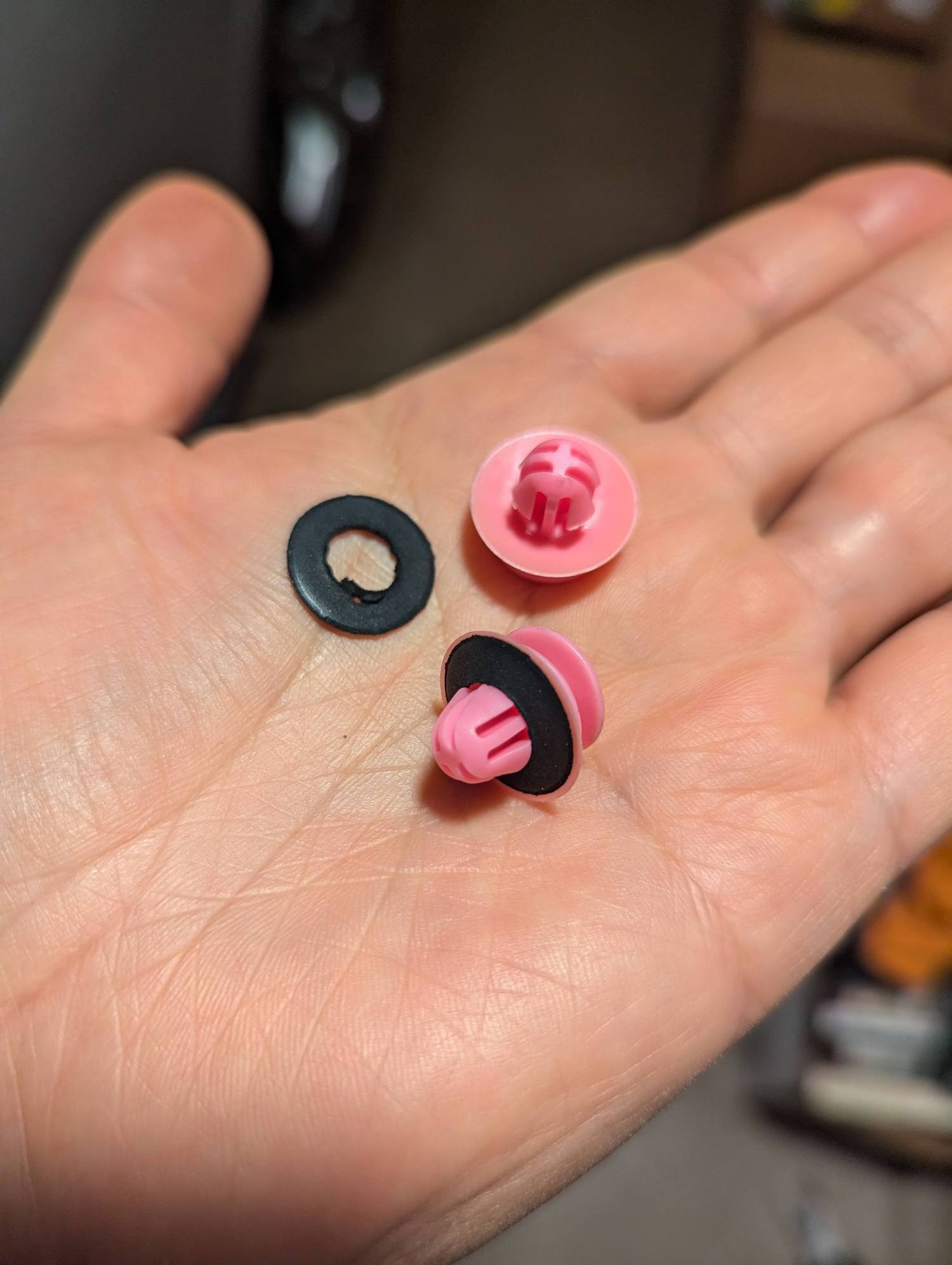

  • Remove the 1-piece plastic and rubber trim from the tailgate using the panel trim tool to pop-off 4 pink plastic rivets.
    • Note that the rivets are one time use and must be replaced with new ones to avoid water leakage.
    • The used rivets have a foam washer that are compressed and will be flattened or torn.
  • Detach the ribbed rubber hose from the tailgate on the passenger side.

  • Using the fish tape, insert the dash cam’s power/connectivity cable into the ribbed rubber hose that goes to the rear windshield.
    • Use lubrication and go slow to avoid tearing the rubber hose.
    • Pull down the rubber ribs over the cable rather than forcing the fish tape.
