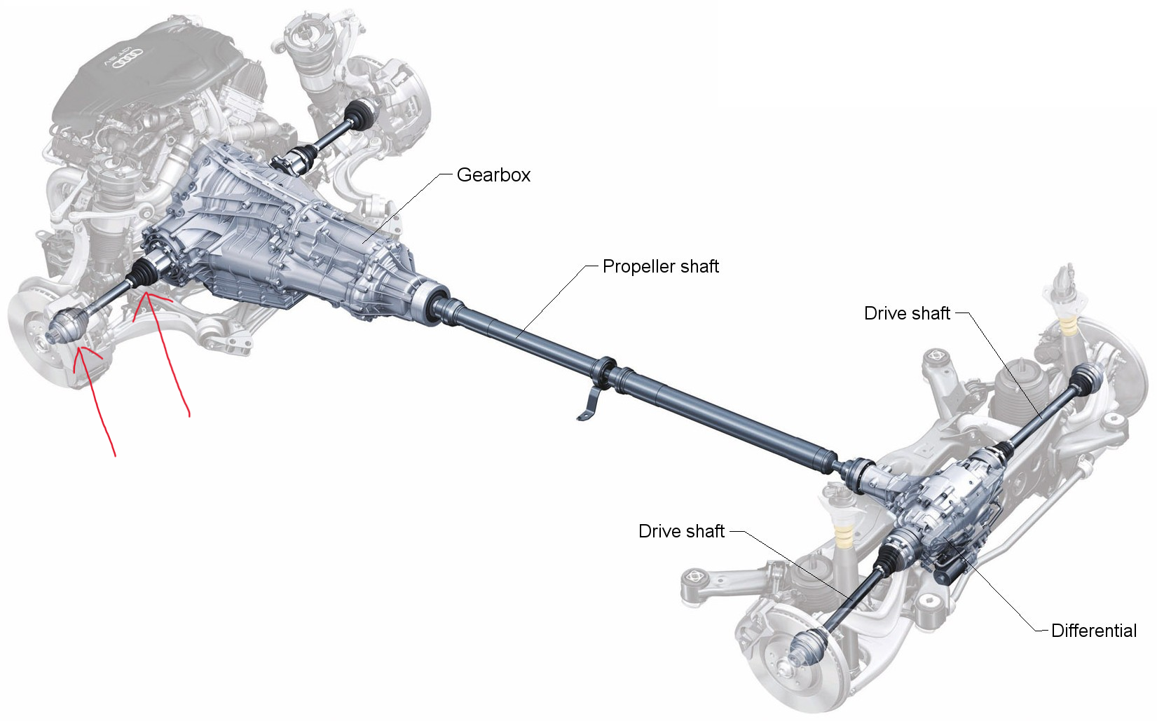

You've pretty much reduced it to the only source being the prop shaft cv joints either in the hub or exiting the transmission/transfer case (not sure what it is called in this case). This all presumes that you have AWD! Not an E220 drawing but if AWD you'll get the idea.

I dont have a 4 matic
