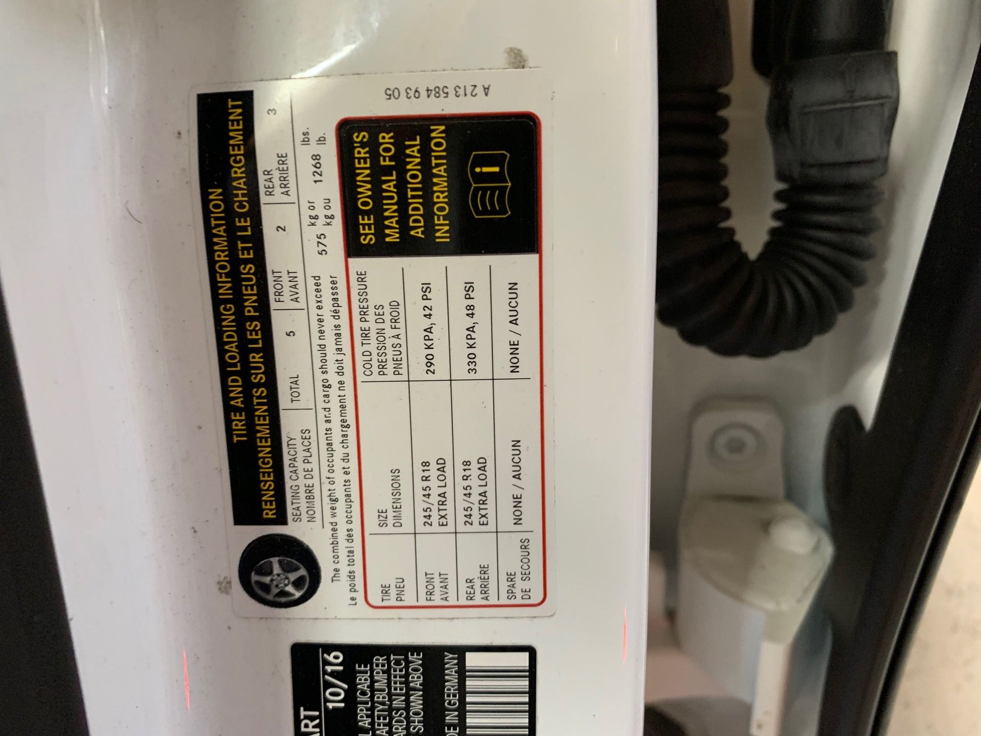

My mechanic (who has been wrenching on German cars for 30 years) says to follow the sticker on the B-pillar, not what it says on the gas filler door. Mine (2017 E400 Wagon) have conflicting values. The owner's manual also refers to the B-pillar, not the gas filler door.
I'm wondering why they're different. I'm suspicious that the sticker on the B-pillar (which only references extra load pressures - the gas filler door references normal and extra load) is not original to the car. I bought the car used; it was 7 years old (from manufacturing date) and had only 52,000 miles.
See the sticker on my B-pillar below. Can anyone confirm that this is an OEM sticker? It looks like one (at least it has an apparent M-B part number printed on it).
The fuel filler door says 34/34 for normal load and 38/42 for extra load. Quite different from the b-pillar sticker.

The max load tire pressure on the fuel door sticker should match the B-pillar sticker. If it doesn't then something is off. The sticker on the B-pillar is federally mandated, so it might be best to trust that one when it comes to the max load pressure. However, that sticker doesn't list the normal load pressure in North America. It also only lists the pressure for the tires that the car came with from the factory. The fuel door sticker may also list pressures for different types of tires. M+S vs summer performance for example. See the sticker from my AMG as an example below. These details are not present on the B-pillar sticker. The B-pillar sticker in North America got dumbed down after the Firestone incidents in the 90s, because most average drivers here don't have a clue about tire pressures and as it relates to load etc., so using the max load pressure at all times is the safest. Those who know what they are doing will understand the fuel door sticker and adjust the tire pressures accordingly for each situation. As you can see below, the recommended tire pressure is also different depending on how fast one intends to drive. That's more applicable to performance cars, though that have much higher top speeds, but as you can see the list of recommended tire pressures can get quite elaborate depending on applicable tire sizes, types, speeds and loads.
