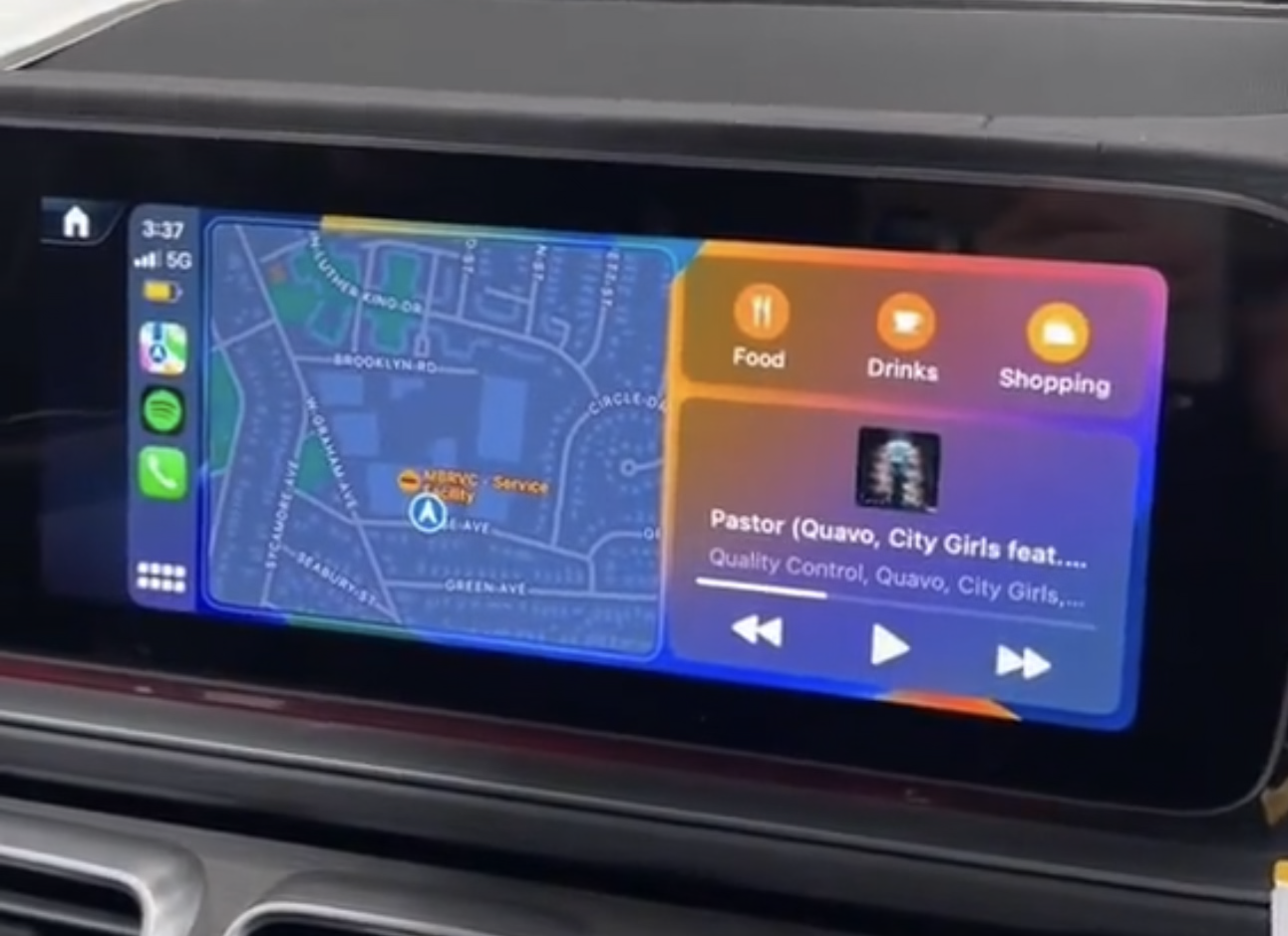

Some people have received ng and solved the full screen issue through the official pu
This belongs to the native full screen mode, which was officially pushed by the system CarPlayFull screen, still retains the home button on the left, but compared to before, both sides are much stronger with blank space

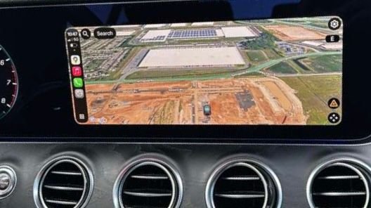

USA W213 E450 2022 Full Screen Wireless CarPlay, done.

Quote: This belongs to the native full screen mode, which was officially pushed by the system CarPlayFull screen, still retains the home button on the left, but compared to before, both sides are much stronger with blank space
Thanks for your post. I think this photo is from NTG7.0 in Facelift 167 models, which is available in all Facelift 177 118 167 243 247 465 models. From day 0, it is already available, no need any OTA or Update. This thread is for those car with NTG6.0 system.
