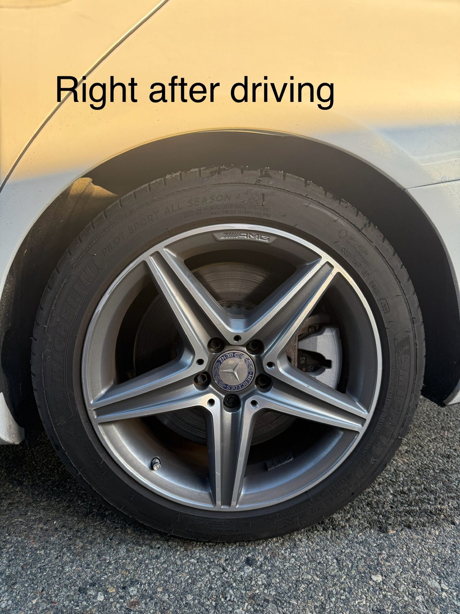

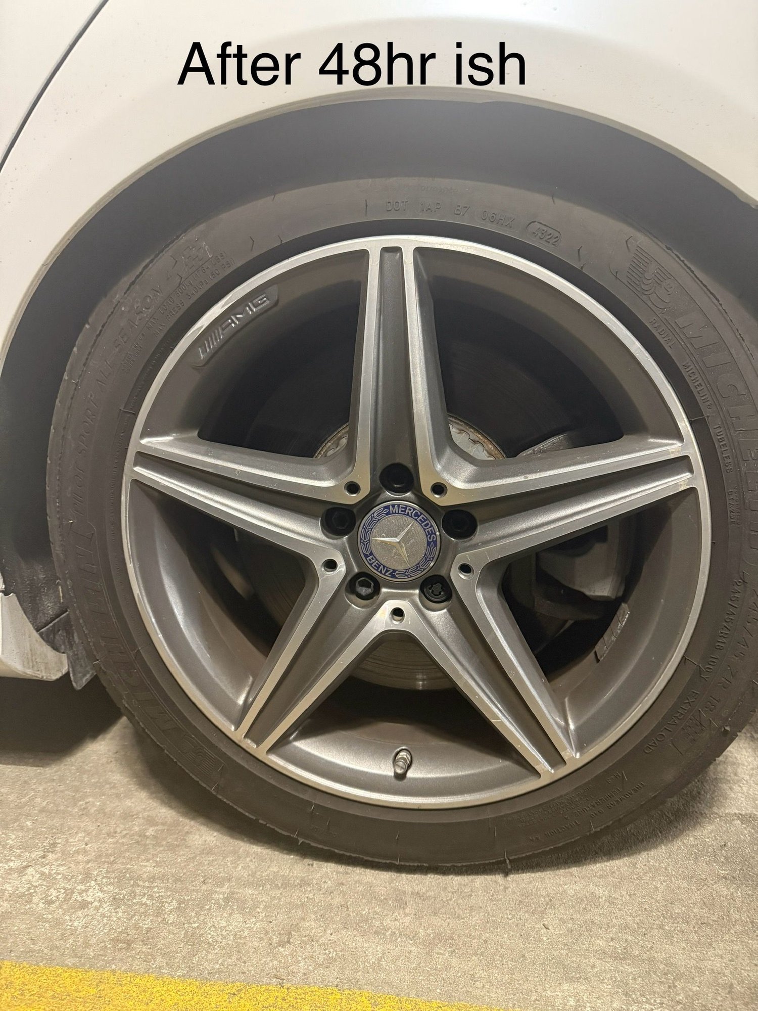

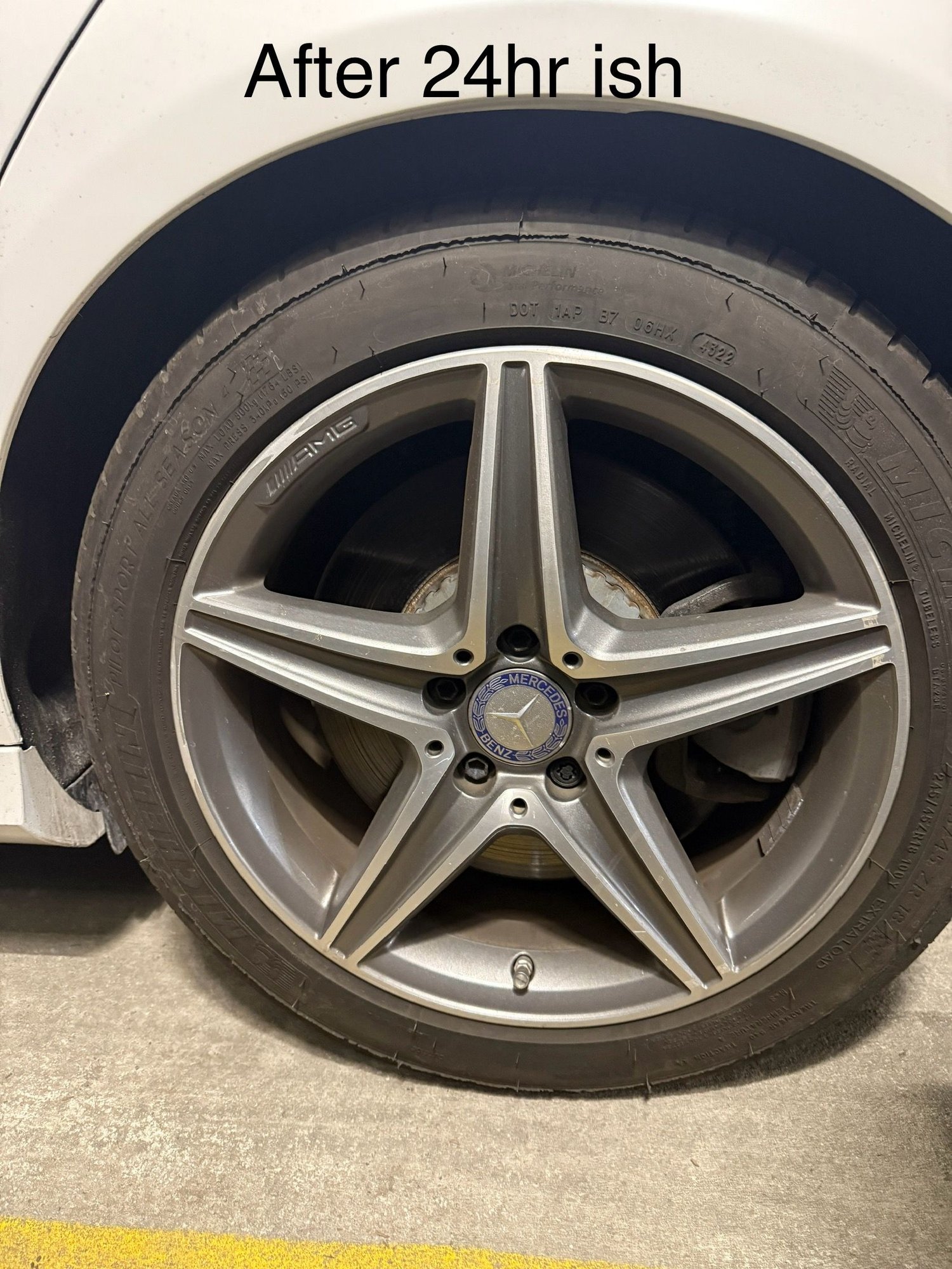

I left my car for a week in an open air garage that’s covered from the top but exposed to the wind and when I came back to the car the rear air suspension was completely dropped. Not sure if this matters or not but it’s been a cold winter here in New Jersey. I started the car and it slowly brought it self up to level. After driving the car I started to take pictures to track the suspension sag. 24 hours later the car didn’t drop a cm but at 48 hours it dropped a good amount (my guess is 50-70% down). I will attach photos that show this. After this I was sure something is leaking in the air suspension system. I took it to my trusted Mercedes mechanic and things only got more mysterious from there.

4- As you can see between 1-24 hours no drop whatsoever occurs but than 24-48 drop occurs.
