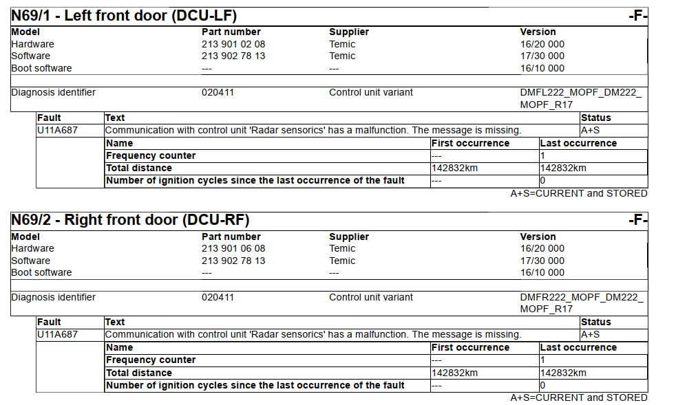

Hi All,
I'm recently retrofit the option 234 for W213.
I've replaced door control module for front left/right, Installed 2 radar at rear bumper
Coding buy Chinese guy and blind spot is working as expected.
The problems are when I used Xentry to scan my car. It always showing fault code for U11A687, Communication to radar has malfunction. Please refer to attached.
I also try to use DTS to diagnostic DTC error. It's the same issue.
My car do not have any driving package. Is there any parameter can eliminate this error?
I tried to use Xentry to test communication. The test result about communication is OK. but have an error result in another attached

Hello, did you do the calibration?

It could be that the code is Chinese but the car is German so they can't communicate. Also, since everything is work.. just leave it alone and enjoy.

Are you sure you in bought the genuine Mercedes parts. Clone Radar works exactly like what you described, it works slight different to the original.
