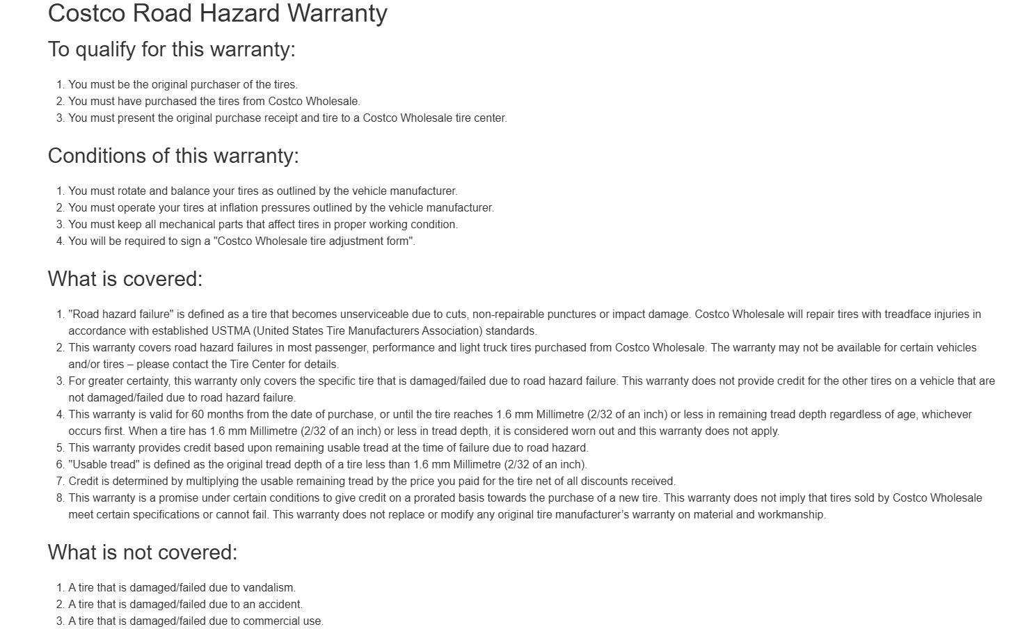

Originally Posted by kingscorpian27
Makes sense, sell vs mount, I wouldn’t have a way to mount 4 tires/wheels so never inquired about just purchasing vs purchasing for installation.
With Costo warranty covers rotating every 7,000 miles. If that’s not done and documented, then you’ll definitely have and issue with warranty should an issue arise. I just had an issue with Michelin warranty because my dealer failed to rotate my Michelin tires replacement for the run flat tires came with the car. This is even after requesting that the rotated tire on annual maintenance service
I do not think this is accurate:
Costco offers free rotation every 5,000 miles. There is no requirement that the rotation be done.
There is nothing in the road hazard warranty that requires rotation.
Dealers are different than Costco or DT.
Hope this clarifies
I can only go by what I have been told for 3 different vehicles in the past 10 plus years. Install new tires, return after 25 miles for lug nuts torque check, documented in their system, rotate every 7,000 miles and documented in their system. I have attached a section of the warranty information provided.

Here are the warranty conditions for Costco: You will note that it does not require tire rotation.
It might be different from the warranty issued by Michelin, but we talking about the Costco 5 year road hazard warranty which is in addition to the Michelin warranty.

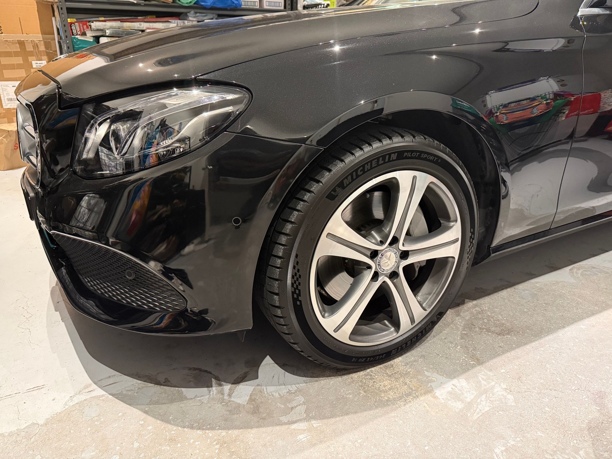

My Michelin Pilot Sport 5 245/45zr18 100y on pre-facelift E300. Fresh from A service from the dealer at MB I Berwick who put on the tyre shine.
My Michelin Pilot Sport 5 245/45zr18 100y on pre-facelift E300. Fresh from A service from the dealer at MB Berwick who put on the tyre shine.

Originally Posted by aks_19_ak
https://cimg1.ibsrv.net/gimg/www.mbworld.org-vbulletin/2000x1504/img_2045_9a1207ebc0f9e268f46e629b4cee0c40f15ee754. jpeg
How come your wheels still use the old hub cap, I thought all 2018 model year and above vehicles switched to the new logo https://encrypted-tbn0.gstatic.com/i...oTD5_ADQTOnw&s
I wrote a long post about Michelin Pilot Sport 5, but it had an expletive, so it went to the mods for review. I have the new black hub caps too from the factory supplied Multispoke AMG 20” wheels. These classic blue ones came with this set of basic 18” wheels that I bought from a Sydney wheel and tyre dealer.
