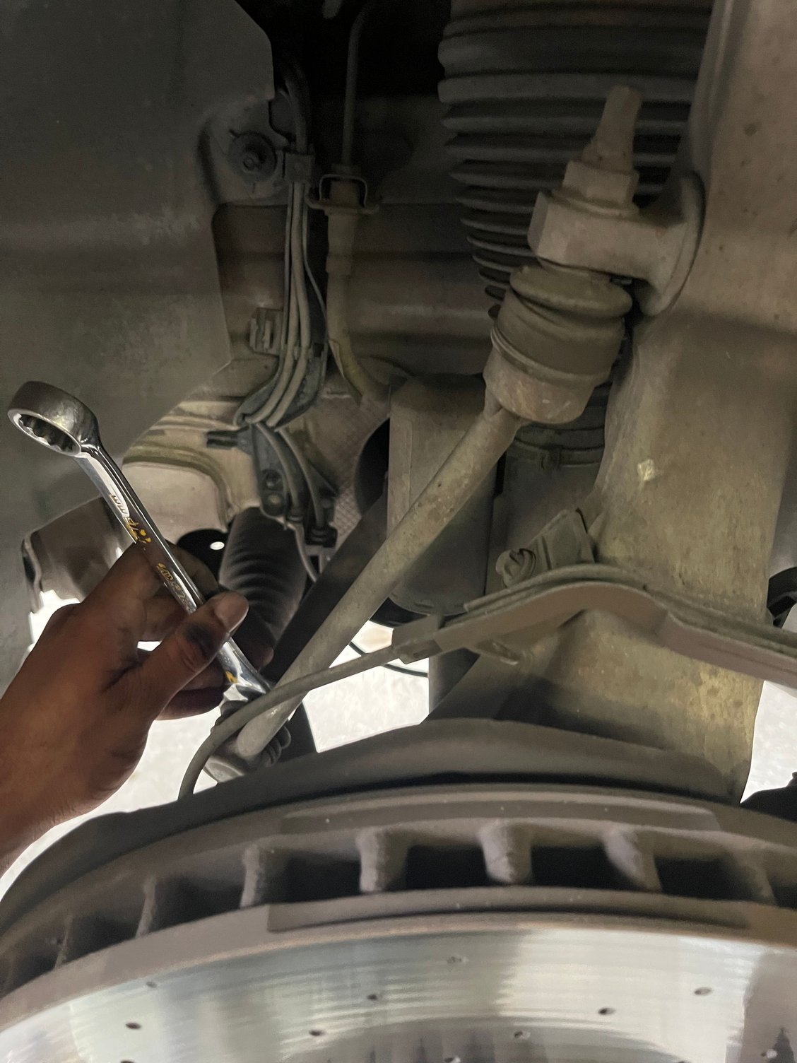

3. Use your 18mm spanner to undo the lower nut (pictured) (lefty loosy righty righty). You will most likely need to use a hammer on the end of your spanner to work it loose. It appeared to be very tight but came loose within 10 medium blows of the hammer.

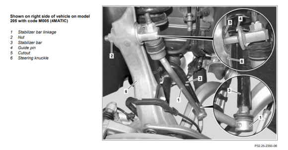

8. Thread on the NEW upper nut by hand, until it stops roughly midway on the shaft. Note: LEMFORDER gives two of these nuts in each package for some unexplainable reason. You only need one. These are special nuts with a built-in washer, that cut into the bolt to prevent accidental loosening. I do not advise reusing the old nut.
9. There is a guide pin on the head of the link that must fit into its corresponding divot on the control arm. Locking pliers would be nice to hold both sides together correctly but not necessary. I just used my hand and squeezed them both together while tightening.
10. Use your impact to further tighten the nut, but not too tight yet.
10.5. Ensure that the control arm sits tight (the guide pin...) and completely flush against the control arm. If not, the guide pin is not aligned with its hole.

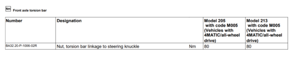

11. Torque the top nut to 80NM (60 lb-ft). You do not need to counter hold anything as the guide pin does so for you. You do NOT need to preload the suspension before torquing.
