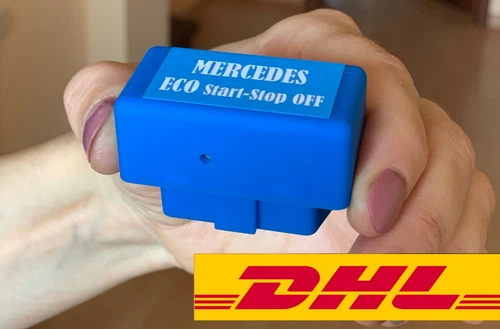

Here's an updated version of the module I bought to permanently change my car's START-STOP default setting to off:
It's available on eBay: https://tinyurl.com/2ygry9kt
MERCEDES ECO Start-Stop OFF MY2019 and later cars - Picture 1 of 2
