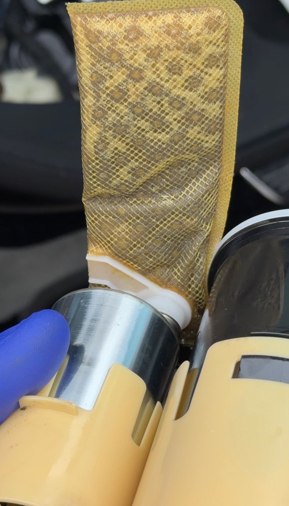

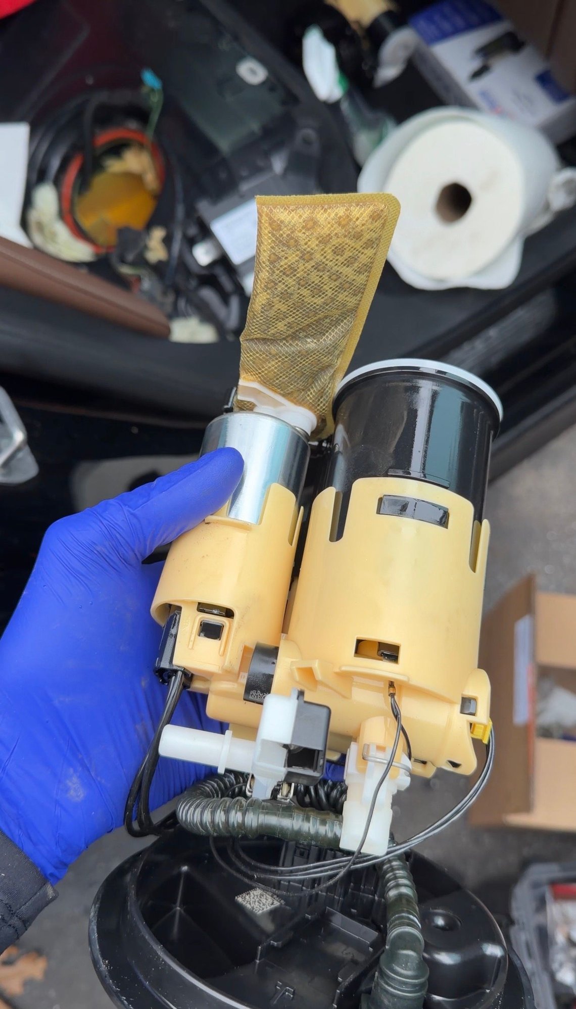

You do not need to drop the fuel tank to replace the fuel pump. You need to remove the rear seat and remove the fuel pump from there.
This is the "filter" on the fuel pump i'm talking about:
It's attached to the fuel pump and has to be replaced as a whole unit.
