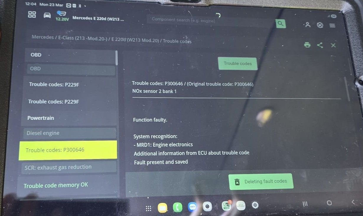

I need help, my AML recently came on. Vehicle Recovery guys ran a diagnostics and confirmed it was NOx Sensor 2 Bank 1 faulty (screenshot attached) and needs replacing.

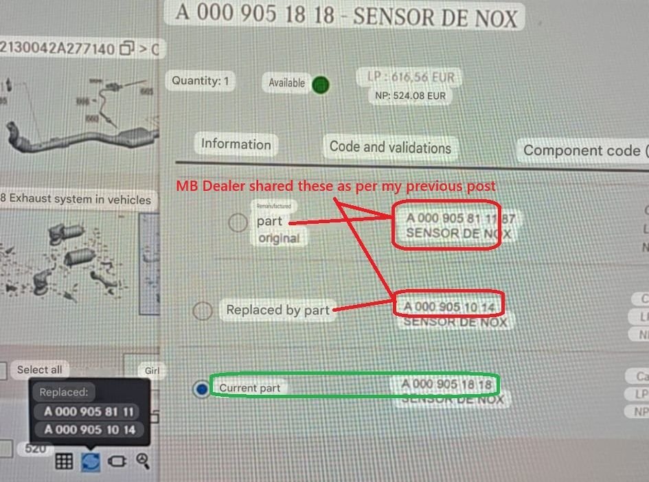

Call another MB dealership and confirm. @trigital has posted about them giving you the wrong part number possibly. I'd call a few and confirm. You can give them the part number in his screenshot and confirm if that's what you need.

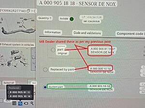

@trigital @Billyismyname Thank you both for your help. Looks like the part numbers i shared, both match to @trigital 's screenshot, however Mercedes didnt provide me with the latest part number. Attaching English version of Tigital's screenshot, highlighted in Green is latest which i wasnt aware of. In Red are what Mercedes dealership gave me. This all makes sense now.
Just a follow up question, today i reset the code (without replacing or repairing the sensor), the AML light hasnt come back up, had few short drives too. Does this possibly means; there is carbon build up on the sensor and sometime reading goes off! Mean if i attempt to clear the sensor, this might resolve the issue anyway?

I would choose the "remanufactured" one, if you are ready to spend a lot of money.
