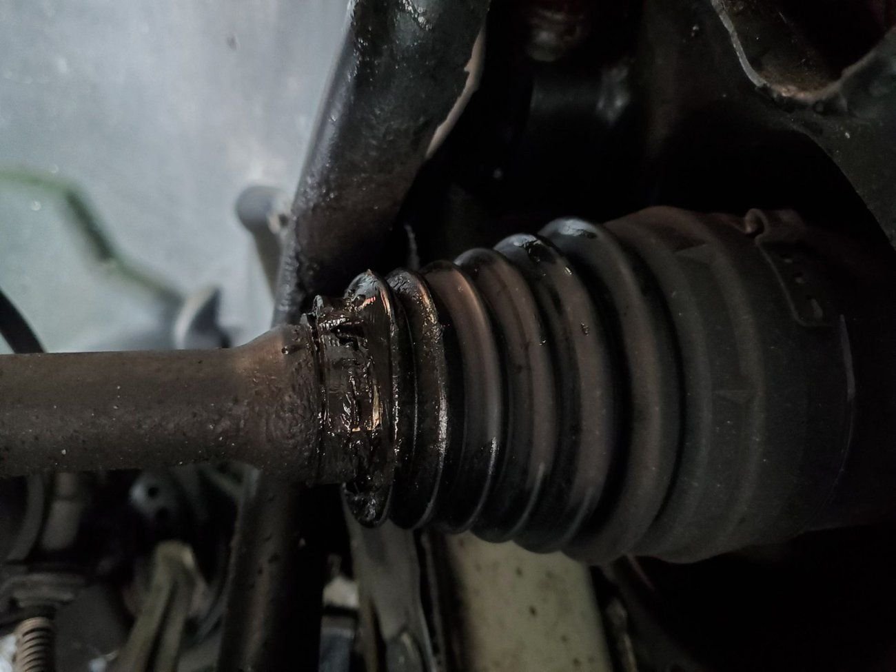

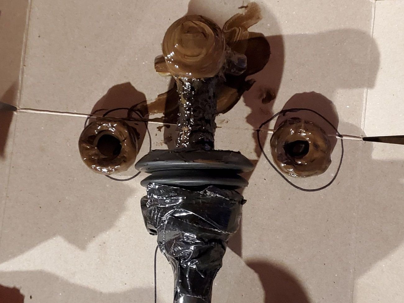

Clicking noise I would inspect the cv axle boots for damage and signs of leaking grease. I had a damaged boot last year on my W204 and the grease looked like peanut butter. The grease seemed to lose its stickiness and was wiped off the metal parts cleanly unlike new cv axle grease that sticks to everything. I caught it early enough where there were no noises so I was able to just replace the boots.

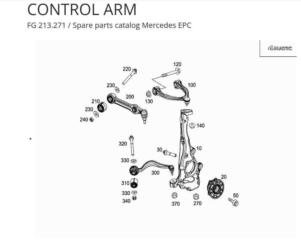

Clicking could also be the wheel bearing. Looking at the parts diagram it looks like an easy job to replace with just 4 bolts and the entire hub with bearing comes off unlike other 4matics where the wheel bearing is pressed into the wheel carrier.
