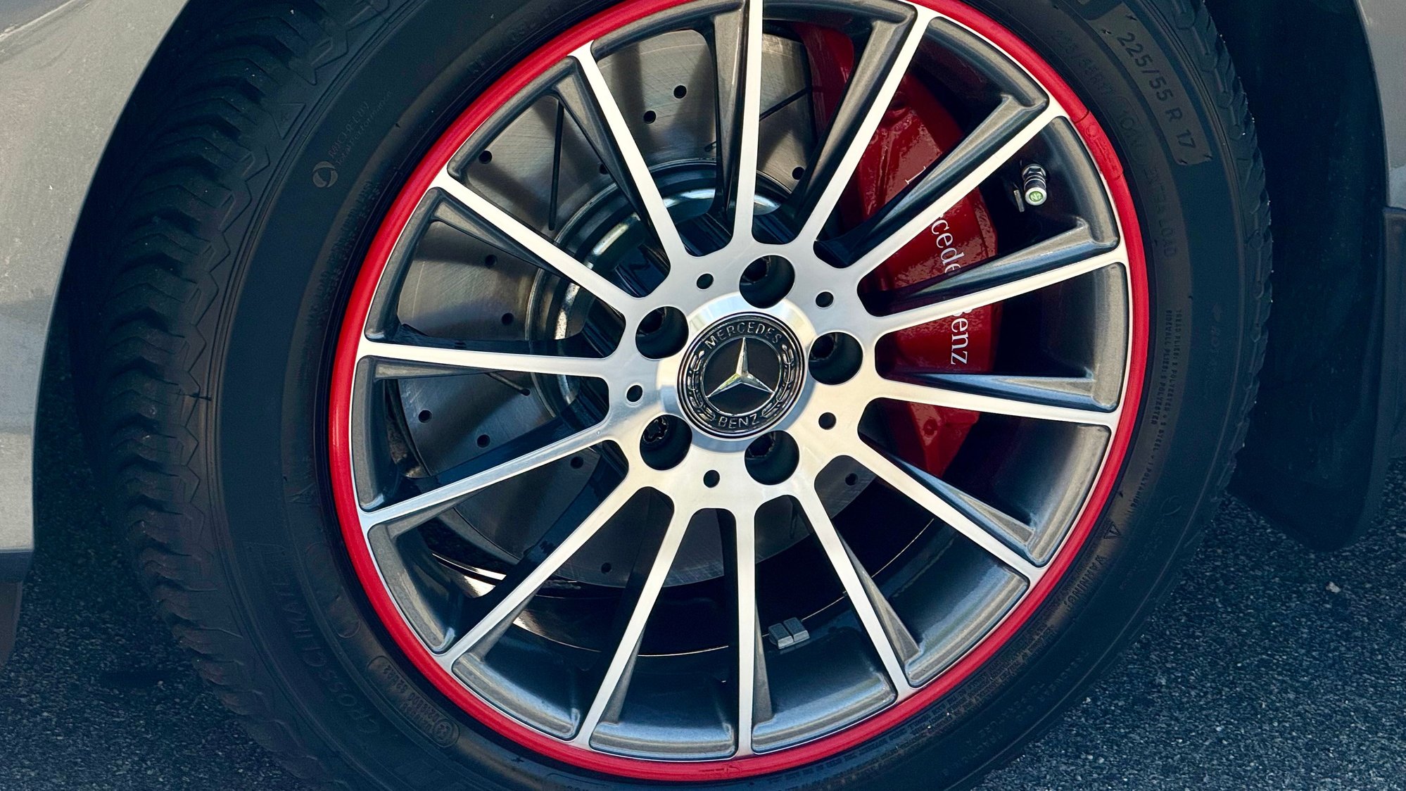

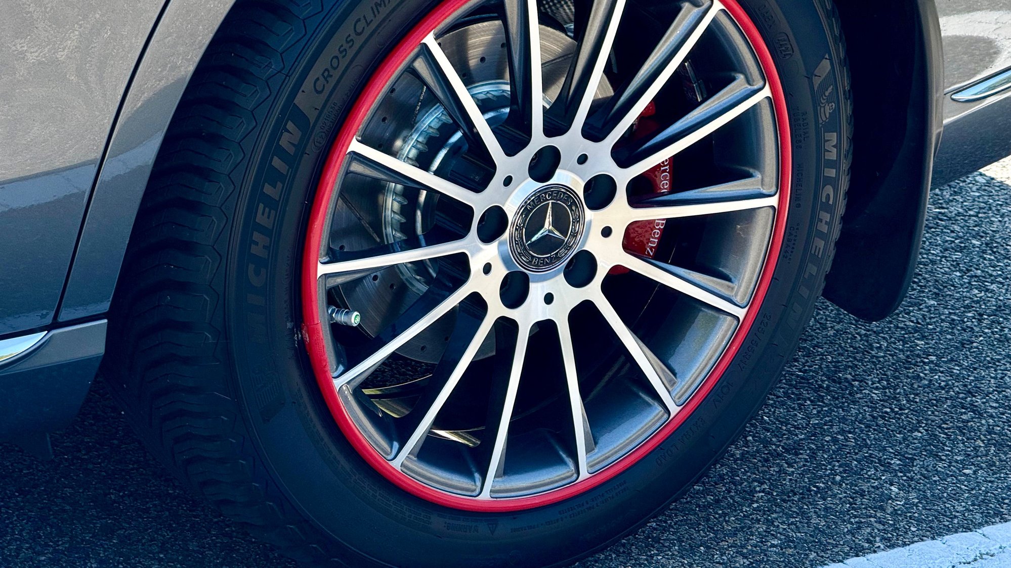

I used PowerStop Front and Rear Brake Kit For Mercedes-Benz E300 2017 - Drilled, Slotted and coated Disc Rotors with Ceramic Brake Pads Replacement, K8072 full kit with sensors from Amazon, everything needed is included in the kit, you can get directly from them or other distributors. Kits are based on your year and model to OEM specifications and better.
I got tired of having to replace rotors and pads every couple years because of shimmering when braking at speeds above 60 MPH due to warped rotors. I’ve had them installed for almost a year now and absolutely love them, they also look great too
Front
Rear
