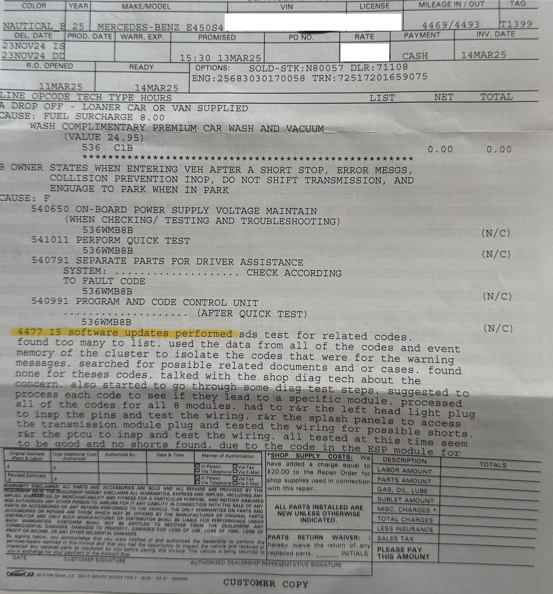

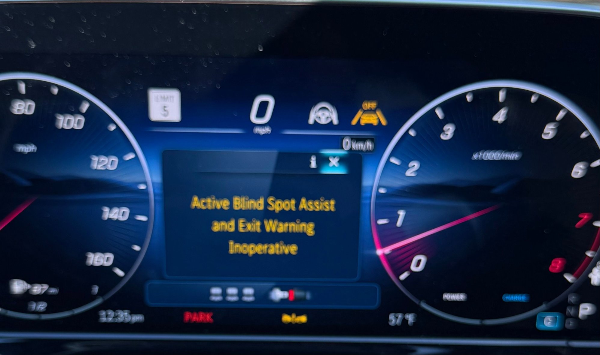

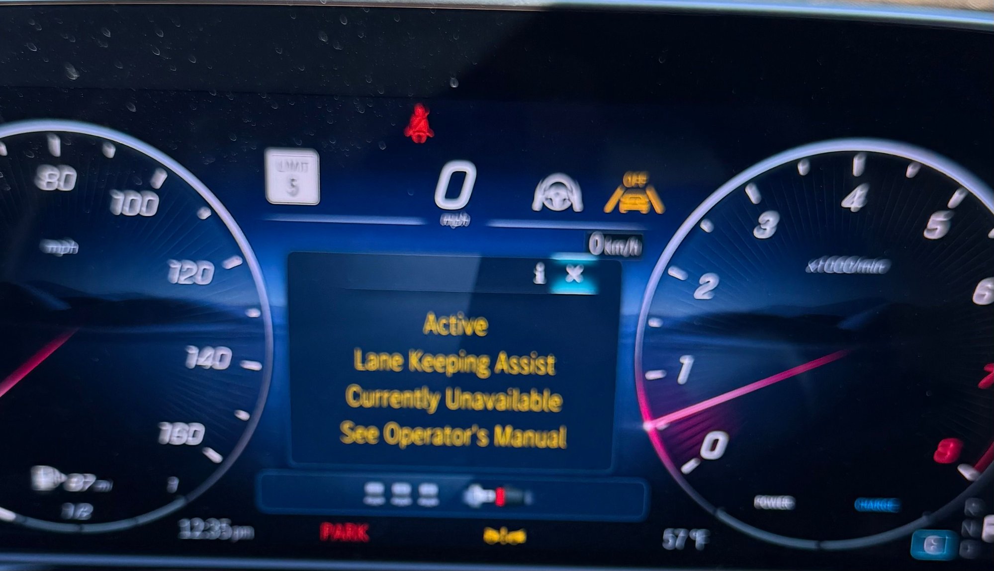

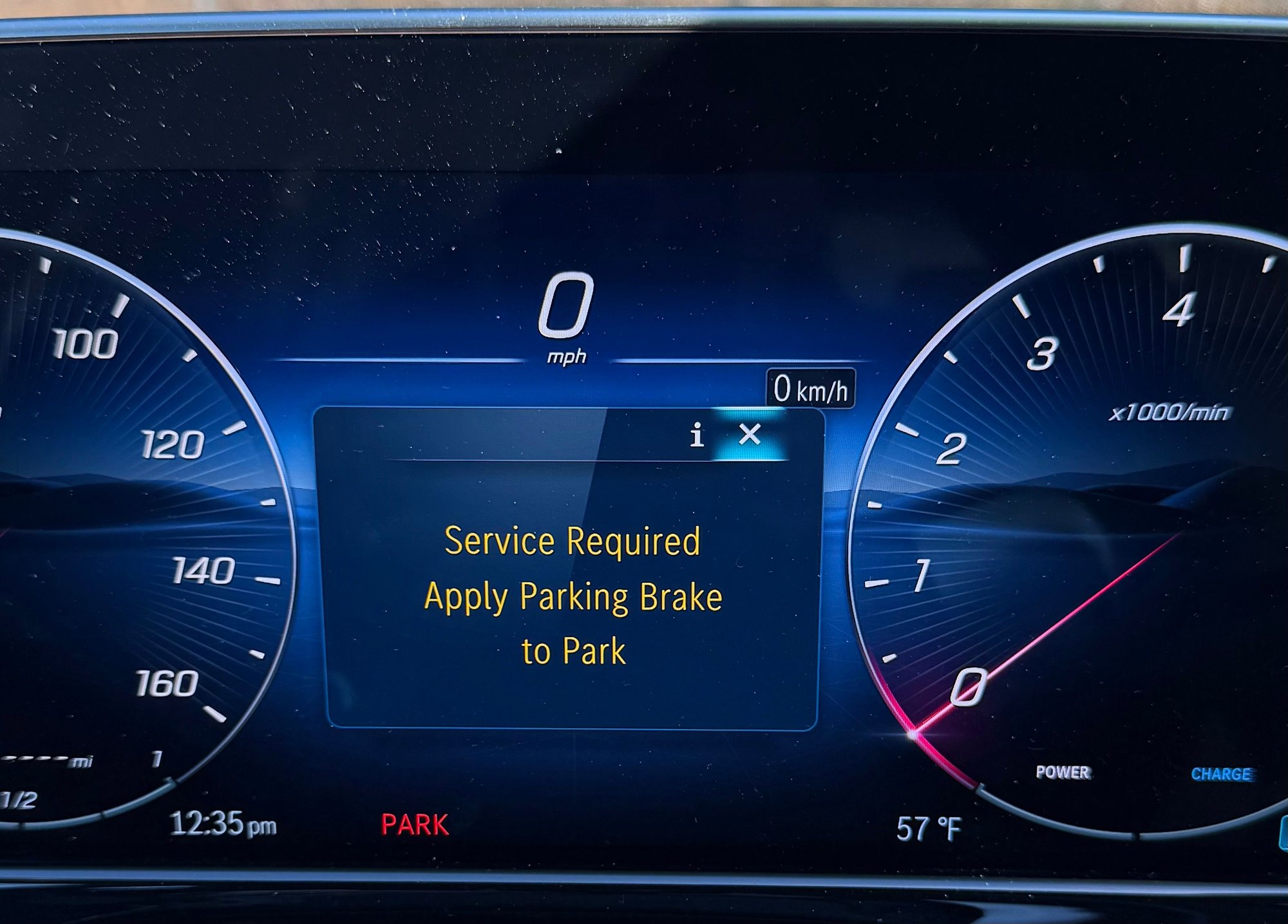

I had an incident a few weeks ago that was similar to yours, but also different. One day, after coming out from a shop I encountered numerous errors and warnings when I started the car (my car never had any issues with starting or stalling out, including this incident). I took photos of most of the warnings - they were flying across the screen faster than I could take photos! One of the warnings was that the car could roll away and that I needed to apply the Parking Brake even though the car was in Park and the Parking Brake was on.
Fortunately for me, I was 3 miles from my dealer and they told me to bring it right over. They were able to duplicate the warnings but could not nail down what exactly had occurred. So they applied 15 different software updates (astounding). When my service advisor told me they did 15 software updates, I thought he was exaggerating, such as when I say, "I've been there a million times." But there it was on the repair order, 15 software updates and the technician wrote on the order "too many to list."
Bottom-line, I have my car back now and have had zero issues since then.
https://cimg8.ibsrv.net/gimg/www.mbw...a63e501b8.jpeg
https://cimg9.ibsrv.net/gimg/www.mbw...20a87cc33.jpeg
https://cimg0.ibsrv.net/gimg/www.mbw...32c833373.jpeg
https://cimg1.ibsrv.net/gimg/www.mbw...f5e286502.jpeg
https://cimg1.ibsrv.net/gimg/www.mbw...b622726a8.jpeg
15 software updates... the car must had been produced very early in the batch. Glad to hear software updates solves everything. Thanks for posting the work order.
