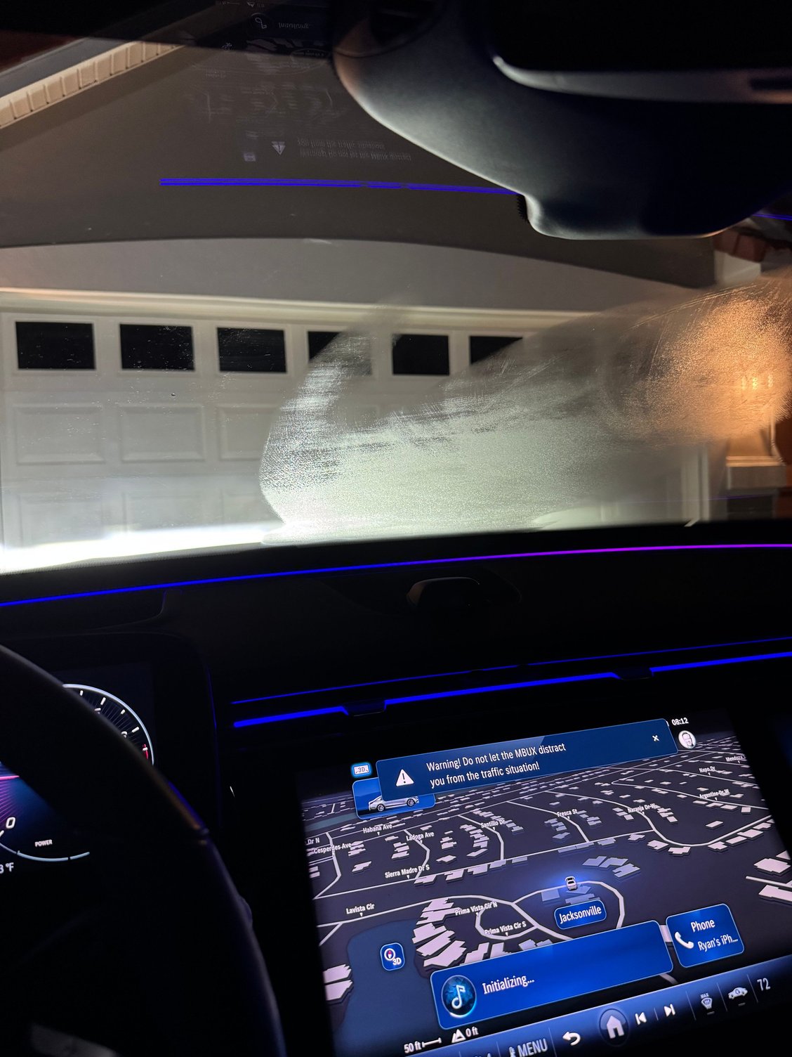

I’ve noticed multiple instances of condensation on the inside of my windshield when first getting into the car after it’s been raining (or I’ve been washing the car). A quick cycle of the defroster fixes things, but I’ve never experienced a car windshield having condensation develop when the car isn’t running. Has anyone else experienced this?

I definitely had that happen before in various cars. Moisture dragged in with wet cloth, shoes gets trapped and if the glass gets sufficiently cold, it condensates. Moisture likes to cling to dirt and oil, so especially on a new car the gassing out of the plastics causes a film on the inside of the windshield. Properly clean your inside of the windshield with a 50/50 alcohol/water solution. Don't use any commercial cleaners. They have all kinds of additional crap in it that just ends up on the glass. Also, leave the AC turned on at all times, so it dries the air. It will cycle on/off as needed. There's never really a need to manually turn off the AC in modern HVAC systems. It'll condition the air in the cabin as needed and removes moisture.

check for water leaks and or AC condensate drain clogged and or heater core leak.
You have excess moisture inside cabin which is really not normal as the car does have ability to "breath", so air is replaced when driving with fresh air.

I have the same issue. At times just washing the car if the interior is warm, condensation appears. Once I open the doors after drying and or turn the car on they clear. It never happens in my W238, nor my prior W213. I never turn the AC off. I think this is caused by the ventilation system, once you open the door, the fan turns on, even if you don't start the car so moist air is going into the car and the cooler windows from washing the car develop the condensation. I don't think anything is wrong.
