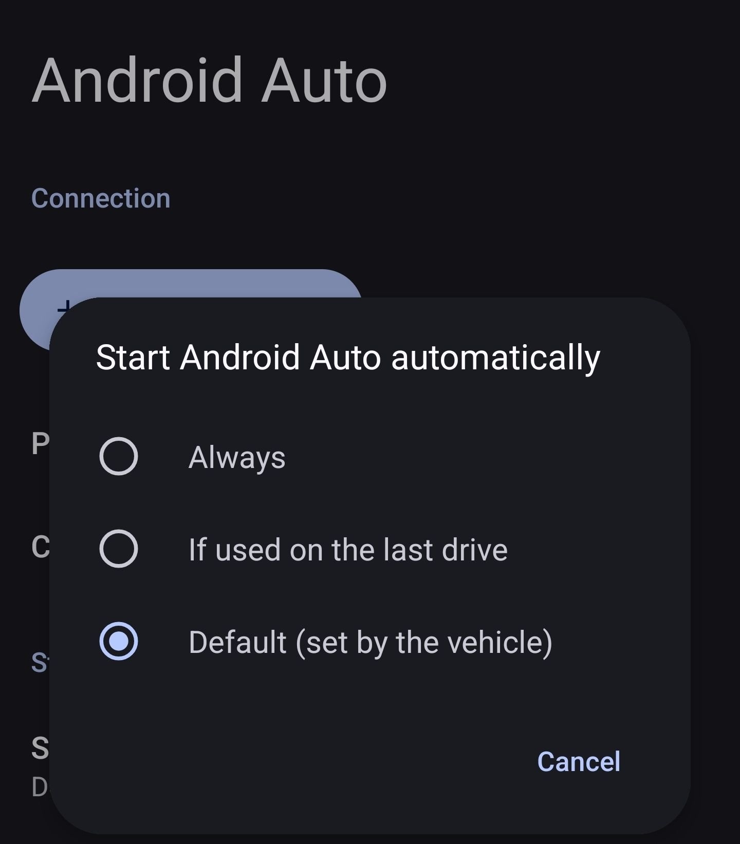

turn off android auto
sick of it killing my phones battery even while on the charging pad. is there a setting in mbux to turn it off or at least make it so its not automatically on without losing phone connectivity?

Go to your Android Auto settings on your phone and change it to "If used on last drive". Then disconnect it and leave it disconnected when it connects next in your car. You do that by going to your phone or after AA starts and expanding down on the notification. There you will see a disconnect link. If you tap the AA icon on the car after it disconnects it will reconnect. The sure way is to forget the car on your phone and then set your phone to not connect new vehicles. Lastly. You can unpair your phone from your car Bluetooth.

Go to your Android alAuto settings on your phone and change it to "If used on last drive". Then disconnect it and leave it disconnected when it connects next in your car. You do that by going to your phone or after AA starts and expanding down on the notification. There you will see a disconnect link. If you tap the AA icon on the car after it disconnects it will reconnect. The sure way is to forget the car on your phone and then set your phone to not connect new vehicles. Lastly. You can unpair your phone from your car Bluetooth.
I will try this. thanks
