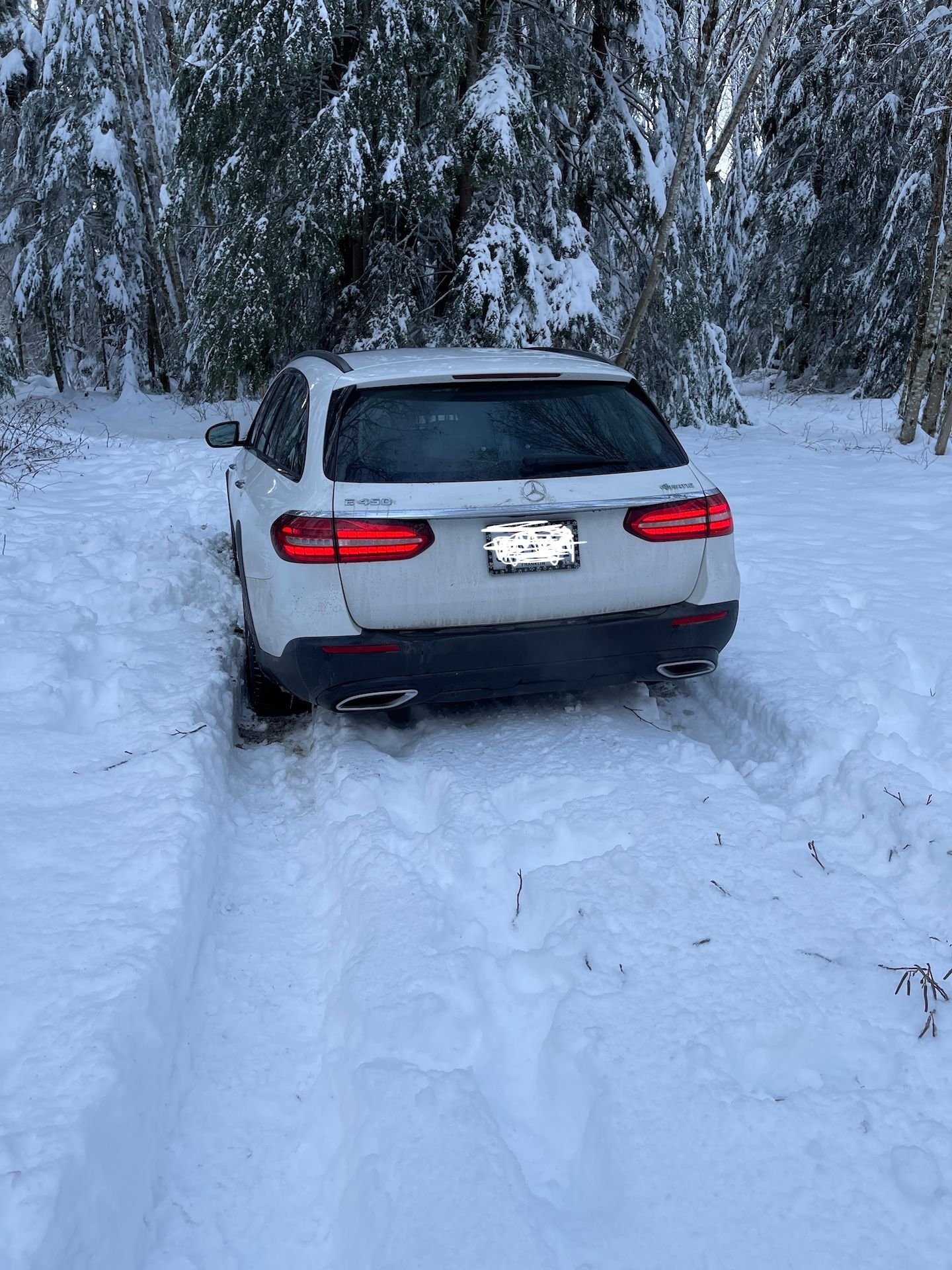

Here's my 2022 E450 All-Terrain (currently with my brother), heading into my cabin near Mt.Rainier...........driving through well over a foot of snow. Eventually, when the snow got even deeper, the car obviously could not move, until my neighbor arrived with his tractor to get me out.
Stupid move, I know, but shows how important is Ground Clearance, over-and-above the tires themselves, if DEEP snow is involved.
