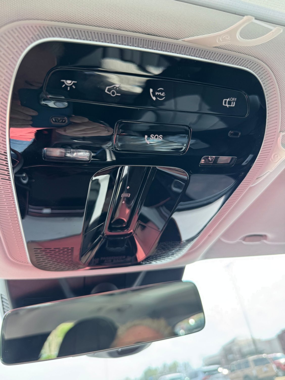

All terrain is tight except for a squeak in the overhead. While I’ve fixed it with floss picks it’s just not the look I want. Does anyone know how drop the panel so I can put some felt pads behind it? I’d rather avoid the dealer trip. Thanks!

I thought I had a rattle in the overhead console also, but as it turns out - it was in between the rear view mirror rear assembly and the point that meets the windshield / console assembly. For me, if I reached into the narrow crack / connection point between the two, the rattling stopped. I put a whole bunch of furniture / felt tape in between the two areas and it softened the impact between the two and completely eliminated the rattling. The rattling was not persistent before but was present when driving over rougher terrains / roads not as smooth. now it’s gone completely. worth checking it out.
