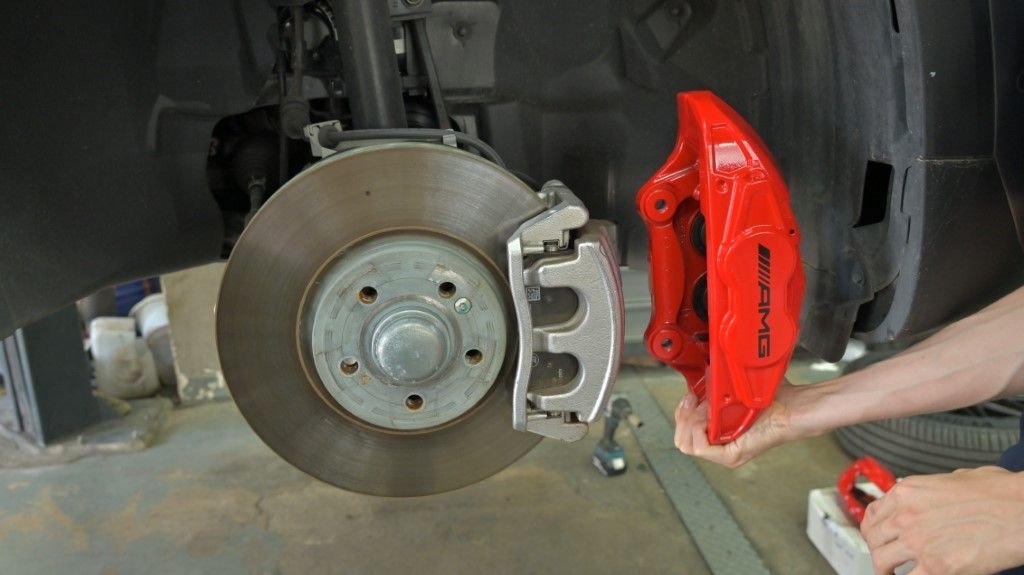

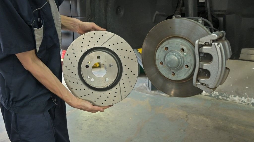

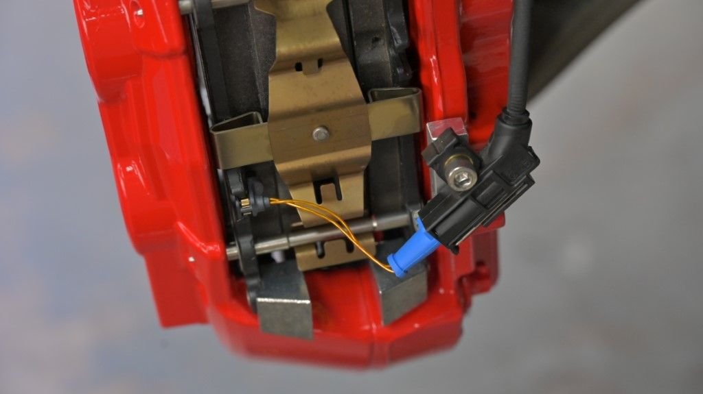

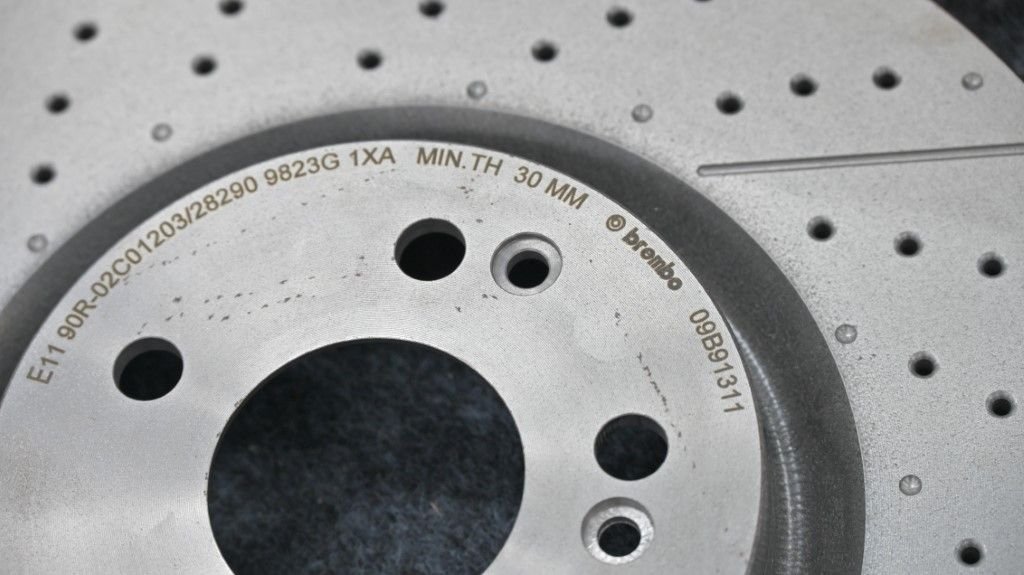

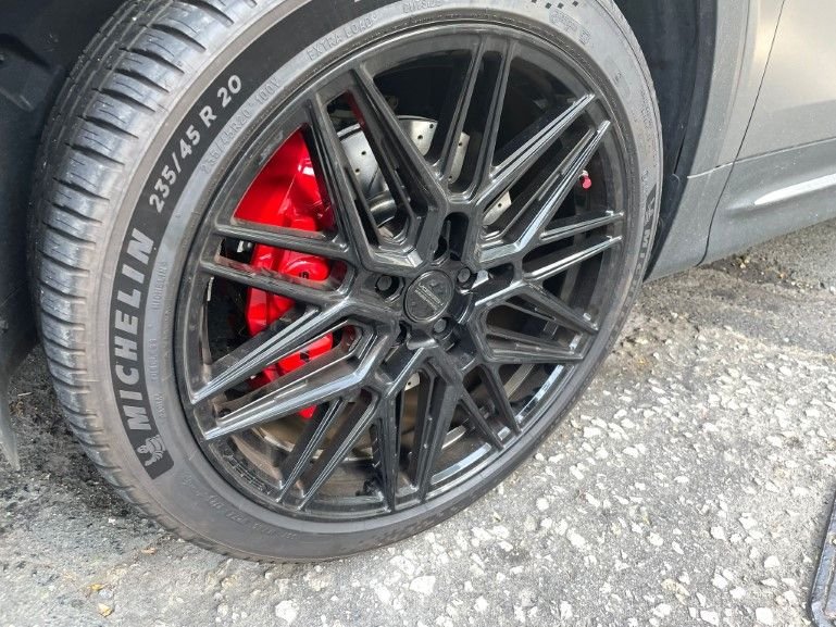

The caliper is an original W176 C117 front AMG 4pot, and the disc is Brembo high carbon series with UV coating.

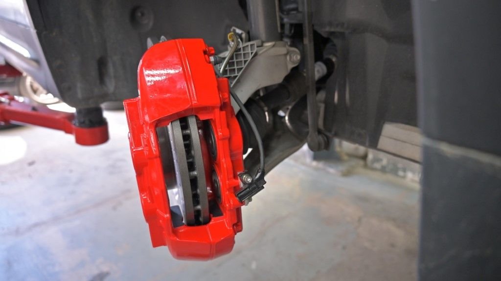

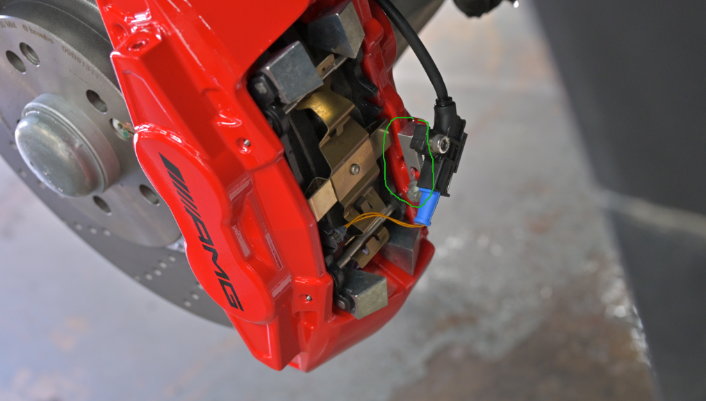

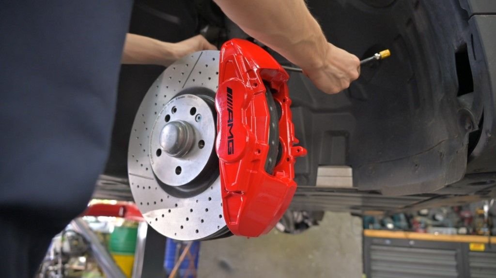

We make some custom accessories during installation, I will try to add a photo with a mark on it, it's just a small accessory for holding the brake sensor cable, which makes it look nice and snug.

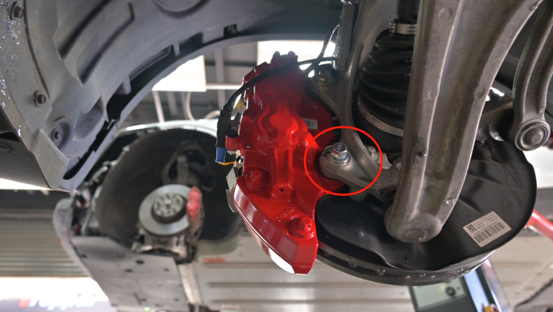

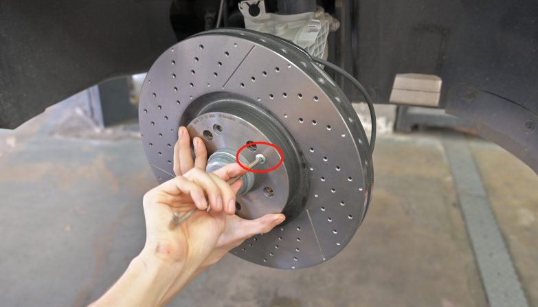

Oh and you also need to screw a hole to hold the disc, will also include a photo of that.
Good news is that, after all this, you don't need extra adaptor.
Please see the last 3 photos, as they will have the aforementioned changes, I think it's easier to just add them after all other.
