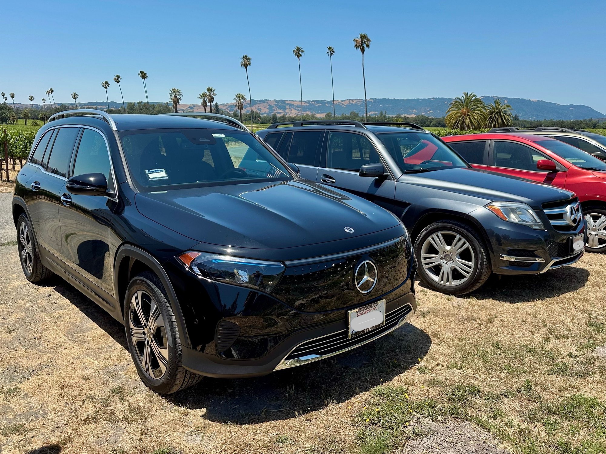

18in wheels for EQB350?
Hi everyone! Just leased a new EQB350 to replace our 7 yr old Leaf. I am loving the car but I want to put the 18s from the EQB250 for looks and a slightly better ride w.o run flat tires
does anyone know if the EQB350 has the same brakes as the 300 and 250 that can be optioned with the EQB250 wheels?
