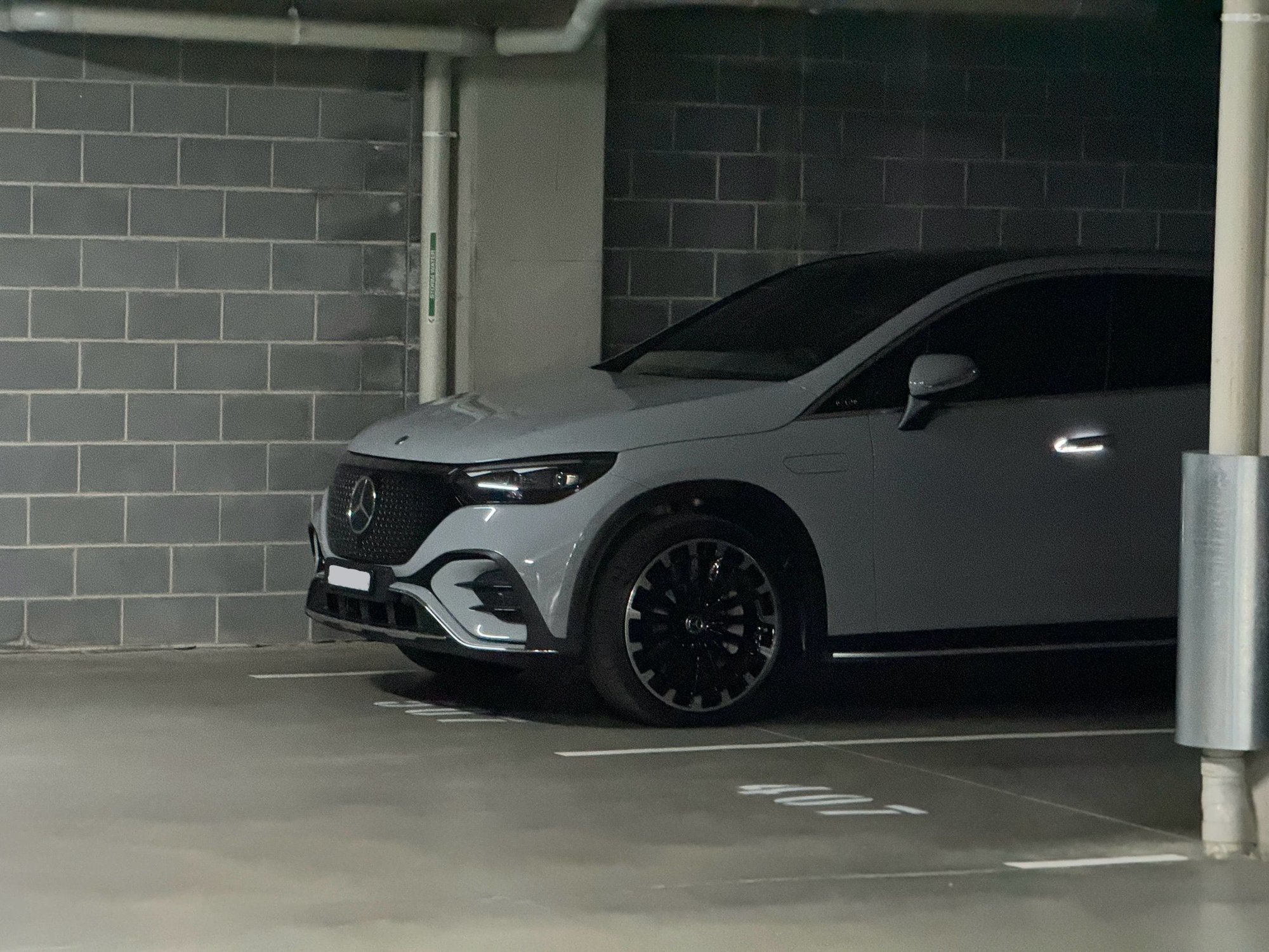

Heya! Thanks for letting me know. Sounds like mine are broken then. I live in a high-rise building. After I approach the vehicle and they extend, I then went back to my apartment. I returned to the basement garage without the key, and they were still extended and lit up after an hour.
See below photo. All four handles extended and lit up, after an hour. Key left in apartment, nowhere near the vehicle. Back to the dealer…
That does seem like it glitched out. Even if the key was in the vicinity, as long as there is no movement (the key) for a few minutes it literally goes into standby and does not send any signals to the vehicle so even in that case it should retract. The key will only wake up again when you move it. This was implemented to counter keyless theft.
Yeah, that's definitely not normal behavior. Probably a simple reset/reboot will clear that. The good news is, the illuminated handles draw so little power, it won't really register as perceptible battery drain until you have it resolved. The DC-DC converter will top up the 12V from the HV battery from time to time, but even then it won't be noticeable. Good luck, let us know how that is resolved.
