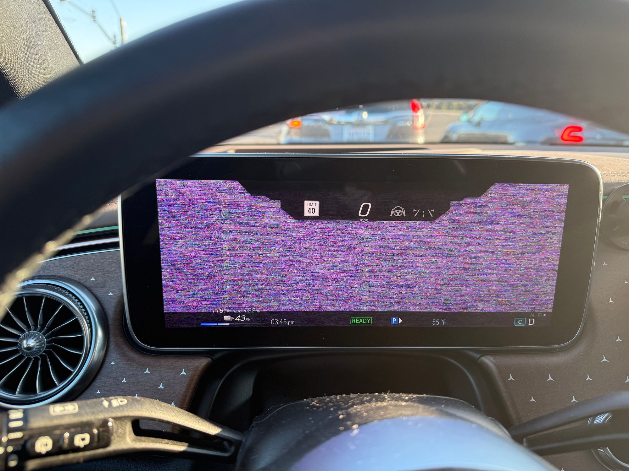

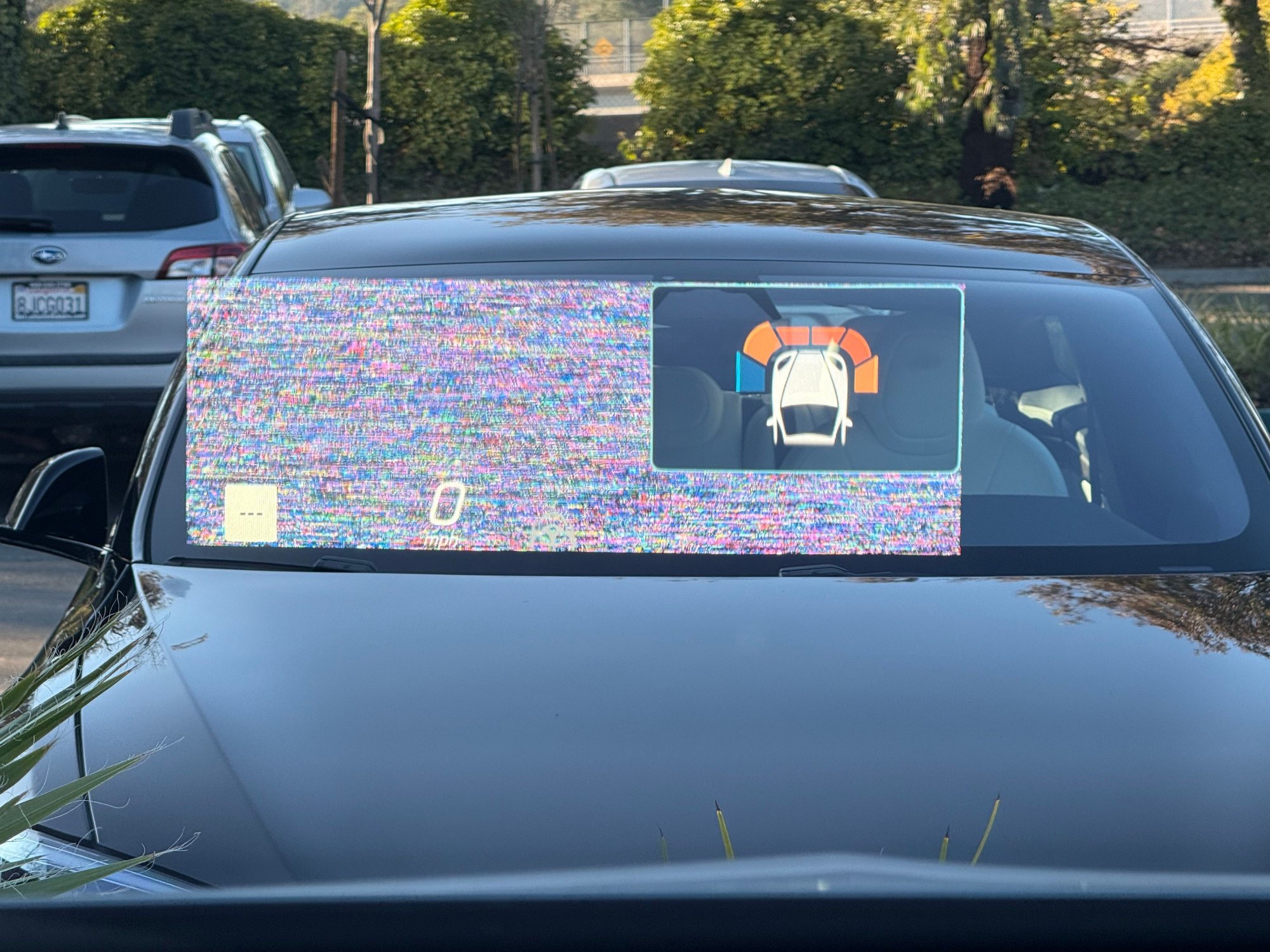

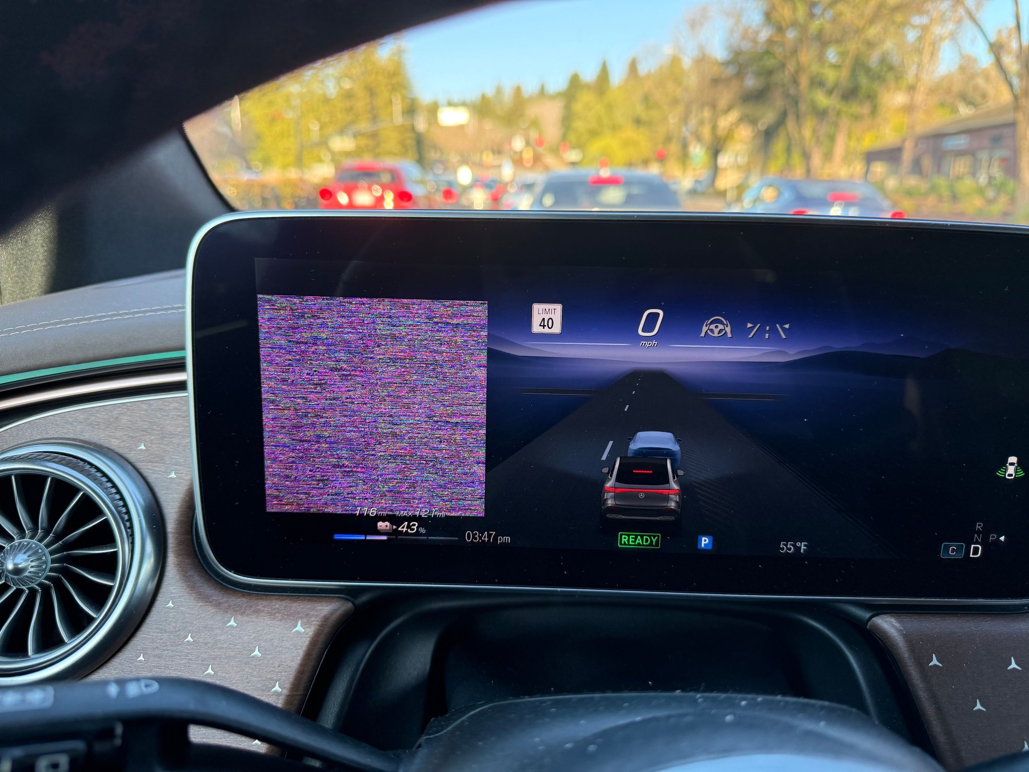

Today, when I started my 2023 EQE SUV 350 I had this weird issue where the dash screen (behind steering) and the HUD navigation screens were completely fuzzy. Seems like a Software issue since the non navigation screens are fine and letting it sit and restarting fixed it. I have an appointment on Monday and will hopefully use this to get on the latest software. I’m on the E330.703 version…Anyone had this issue?
Navigation display mode
Assistance display mode
HUD
HUD
https://cimg4.ibsrv.net/gimg/www.mbw...efc4a43ad.jpeg
https://cimg5.ibsrv.net/gimg/www.mbw...2869f9be7.jpeg
https://cimg6.ibsrv.net/gimg/www.mbw...50e28a248.jpeg
HUD
Software glitch, I think it was reported before, try rebooting.

I am on my third EQ car and have never had this issue.
I would try to turn car off, lock it. And then try the car again after a couple of hours. That should reboot it.
Otherwise try this
Otherwise take to dealer.

Thanks all - yes as I noted in my post it fixed itself after leaving it for a bit. I’m hoping to use this to get on the latest software. I have also noticed that the main map has a bit of blue hue to it that fixes itself every few seconds. So just hoping they will other SW to the latest version….
